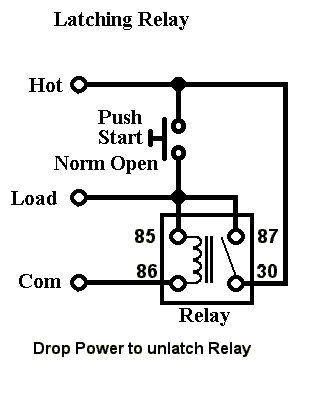

It should be available here with Industrial components dealers, but surely 5-10 times costlier than a low voltage DC relay I assume. I'd go for a better method. I can get a thrown away 5v mobile charger smps, so just use it with a 6v relay that is ready in my hand. Else I may use a transformer at the worst case.

That would work! Junked wall warts are great for this kind of project.

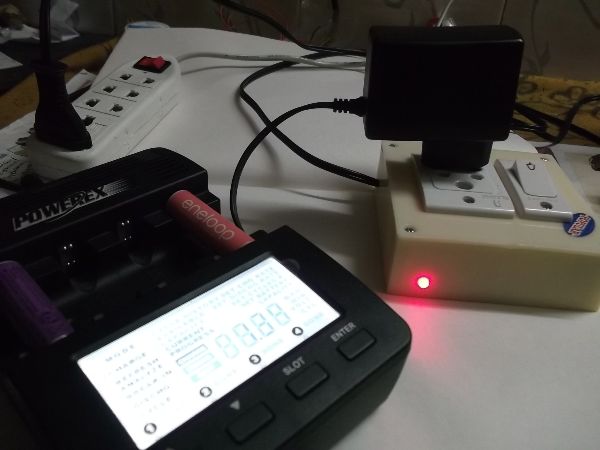

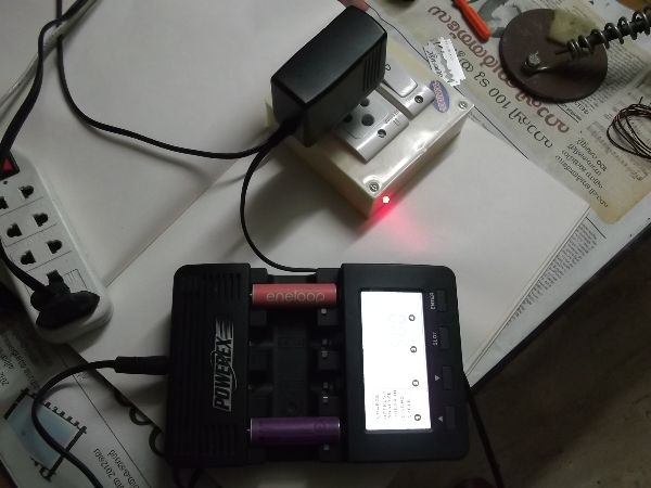

I'm glad to inform you all that I have done this project today with 100% satisfaction :)
Actually I was running bit out of time recently, so postponed this cool little project always whenever I think about it ;)
I used a junk 5V travel SMPS charger with a 5V miniature relay and a 'calling bell' type switch for the trigger/reset that could mounted easily on the box -which avoided extra works such as making holes for the push button switch.
SMPS is having the indicator, which I simply shown out through a small hole that gives a cool indication of the latching unit.
Attached is the images which shows on charging the wizard one with 2 eneloops! So from the coming new year onwards I should be having more faithful charging processes. Thanks for looking. Pretty happy :)
