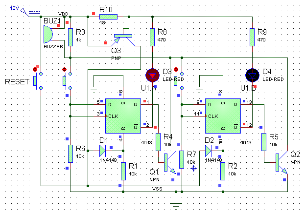

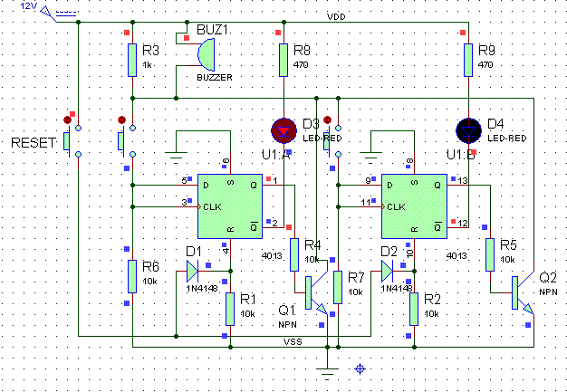

I need a quiz buzzer/light system circuit please
I can think of many ways to do this. Here is a simple design that can expand to any number.
In the unlikely event (but possible) of more than 1 button pressed within some nS from each other, the circuit could be modified as in the 2nd diagram. Here the extra transistor monitors the current to the LED's and any current higher than that for 1 LED will reset all the flip-flops. Because all switches have some contact bounce lasting (~10mS), after a reset pulse by the transistor one of the switches should be able get a valid set in this time. R10 will be calculated based on the LED current and Vb-e (worst case) of the transistor.

What prevents more than 1 person to activate his LED? The first person to press should lockout all the remaining buttons.
Yes, now I see it. Missed that connection the first time as I was too busy looking to see which lines connect and which not. On my screen it is not easy to see as the dots are so small.
One word of caution though :!: The lower comparator may exhibit normal turn-off delays of several uS (as long as 10uS according to National's datasheet) due to the storage time in this comparator (no spec given for upper comparator). This together with the propagation delay (~0.5uS) of the internal flip-flop which drives the discharge transistor (~30nS after pin 3) to operate the lockout, makes the probability of having more than one led to come on much greater with more stations added. For this very same reason monostable circuits with output pulses shorter than 10uS are not recommended for the high risk of re-triggering.
The ic is not being used as a monostable, so considerable overdrive is available. Under such conditions the propagation delay from trig to output
is ~200nS. While a spec for the threshold input is not given, considering that this is the npn comparator I would expect that it is at least as fast.
I never said your's is a monostable, my whole point is that, the possibility exists for more than one LED to be activated even if your delay is only 100ns or shorter. You should have a way to deal with this.
The design posted by srineo173 deals with it by selecting the highest of the triggered numbers. My circuit reset in such an event. I ran a simulation on your circuit with only 2 stations and had no problem getting both leds triggered. In the simulation I fired the 2nd switch from 100~800nS after the first switch and got both LED's on. I also modified my first circuit after doing the same test that confirmed this problem. Your circuit could be easily modified as well.
I am not slamming your design, only pointing to lurking problems that are not so obvious.

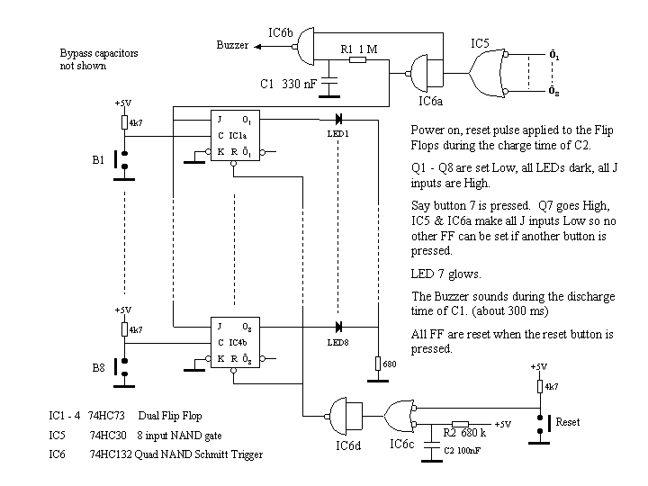

Here is the JK Flip Flop option we discussed by email.
Len
