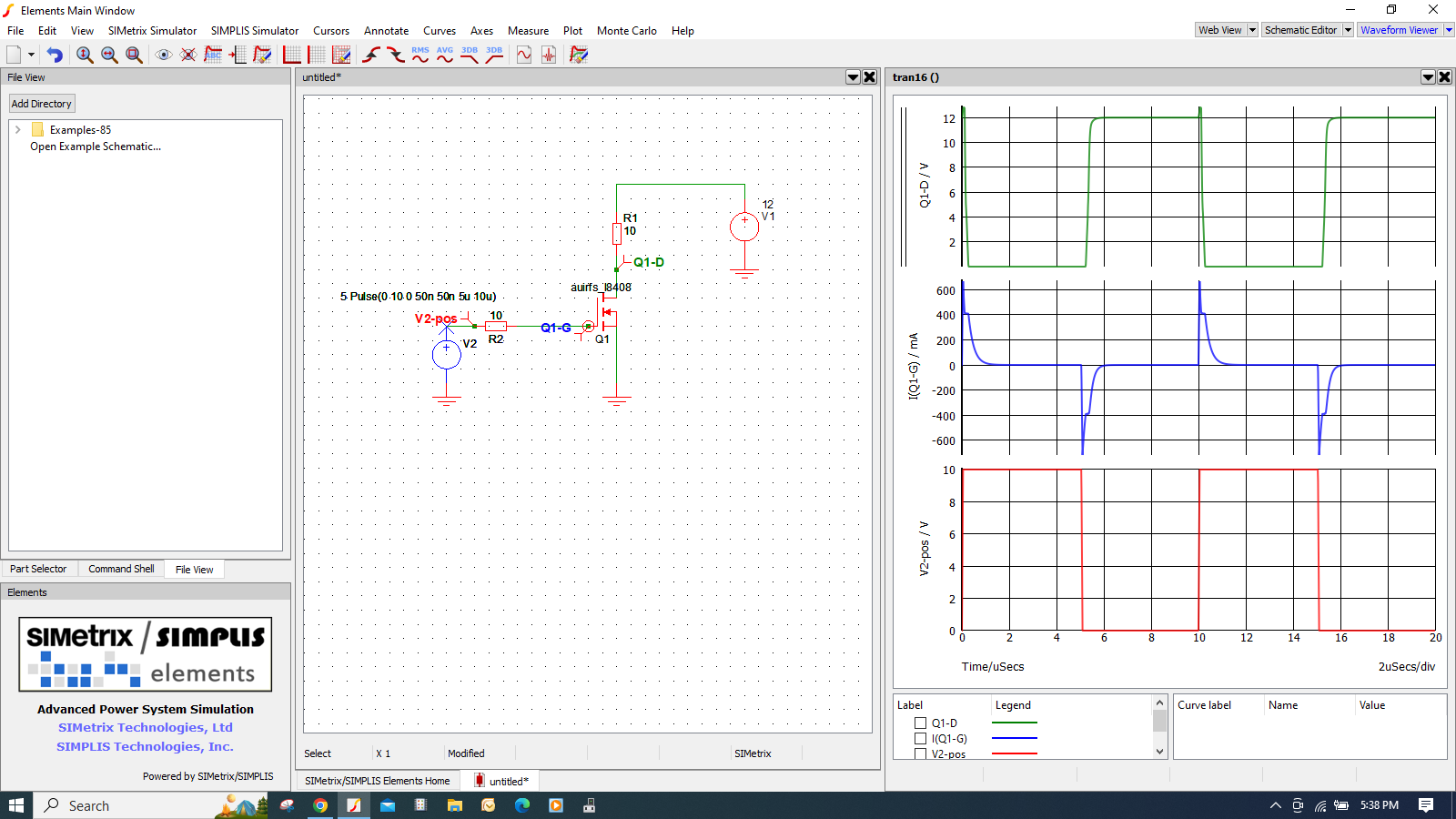

I am still new to Mosfets.
Because in my simulation, the last thing to worry about that I measured was the gate current. I saw that it was about 3.5 amps and that worried me. Still though i am only dissipating about 20 watts.

There are large gate currents if you are driving them with fast Tr and Tf
inputs, due to gate C.
Classic C equation :
Q = C x V
dQ/dT = I = C x dV/dT
Calculations for driving MOSFETs -

An example :
Regards, Dana.
for an estimated Ciss of 2500 pF, Rg=4 ohms est. Vgs=12 to get 3.5 Apeak the dV/dt=Vgs/RgC = 12/4*2.5e-9 or 12V/10ns. Then yes it is possible or a period of 10ns.

This is an AC current, not a DC current. The gate of a MOSFET is insulted from the other nodes by a layer of silicon dioxide, which is an insulator. Too much voltage would however be a bad-bad thing. The main reason for it is to charge and discharge the gate rapidly.
In a simulation, you can easily get 3.5 Amps (or more) into the gate of a mosfet for a few microseconds.
But is you have that much current continuously, then something is wrong.

My use of 'a few microseconds' was only intended to convey the concept of a very short time.
