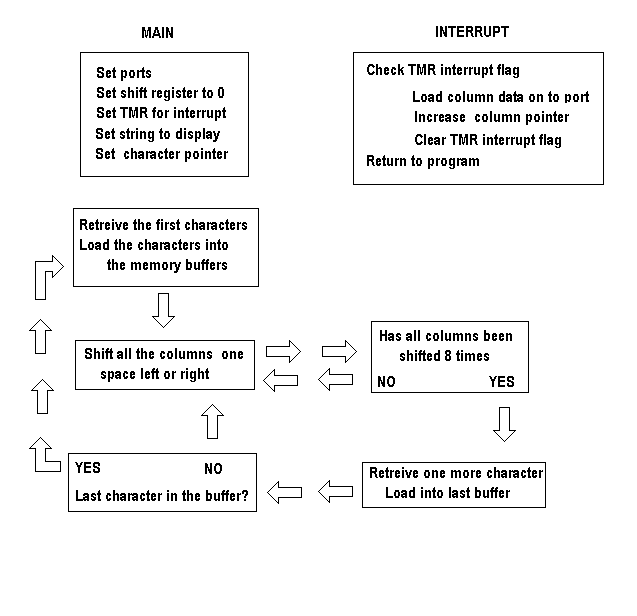

You can't use the same code as in the tutorials, You'll need to modify it for columns instead of rows.... Essentially its easier to scroll columns than it is rows..
Flow chart
I can't really describe any more how to do it...
The interrupt moves the data from the buffers column by column to the display
The main routine fills the buffer with the correct data....
I am still confused with the use of timer interrupt here?? how much time to set/ clock why???
It's just a better way to do this.... If you NEVER have to worry about the screen updating, then when you update the "Unseen screen buffer" its automatically updating all the LED's (screen)..
You just print to the buffer... Just imagine if you held your string in a permanent place in ram ... ie .. "HELLO WORLD!!" 13x8 = 104 byte buffer you could, in theory, just point to the buffer and increment it one at a time so the interrupt scroll through the entire message..
