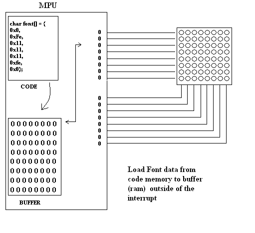

Oh I see... You are talking about buffering.... The ASCII comment was for storage only...
Right.... First access the character from your 2 d array.... place it in the 8x8 buffer ( I called mine leds[])... If you have your interrupt configured correctly.. It will display the character...
unsigned char leds[8];
for(x=0;x<8,x++)
   leds[x] = font1[character][x];

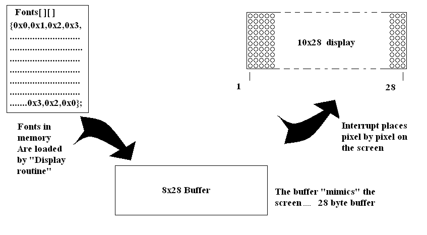

Yes I will show you.... HOW MANY CHARACTERS ARE ON SHOW AT ANY ONE TIME... the reason I ask is you characters ( in the 2d array) are 7x8.... how does this correspond to you led matrix of 10x28. Are the top two leds going to be off? Is there 4 characters in all? If there are 4 characters on at a time you need to buffer 4 characters buffer[4][7]; Then use the buffer in the interrupt and update the contents outside of the interrupt.
void interrupt ISR()
   if(TMR2IF)
       if(pos == 0)
             DATA = 1;     // start column
       rows = 0;           // turn off current row
       CLK = 1;             //  shift to next column
       CLK = 0;
       rows = buffer[pos];   // retrieve buffer data
       DATA = 0;       // no more data ( this will shift through all the columns)
       if(pos++ == 28) pos = 0;     // back to first column
       TMR2IF = 0;    // clear interrupt flag
Then you fill the buffer with the current data...
The display routine takes the characters one by one.. Line by line, and fills the buffer... The buffer is a linear portion of memory (Ram) that is the same size as the led display... The interrupt selects the columns and then blits the relevant data from the buffer to the screen..

Line by line.... This makes it MUCH easier to manipulate... Each character is 8 bytes long... If you create a buffer
char buffer[28];
You can fill the buffer line by line.... Lets start with 'A' hex 0x41..... We put our font pointer to 0x41 - 0x20 ( we started our characters at 0x20 ' ' ( space ) then we multiply by the size of the character (8) to find out the place we need to be...
Then line by line we take each row of data from the font and place it in the buffer... Then do it for the next row then so on until the character is in the buffer. buffer[0] to buffer[7] will now be an exact copy of font[264] to font[270] ( the location of the bitmap 'A' )
Then repeat for the next 3 characters.... Once the buffer is full ( shifted or whatever ) the interrupt takes buffer[0] though buffer[28] and lights the LED columns one by one..
To rotate left just start the characters at buffer[1] then buffer[2]... To rotate right just loose the first column, then the first and second,etc...
