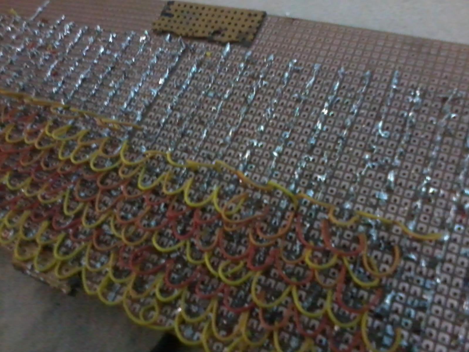

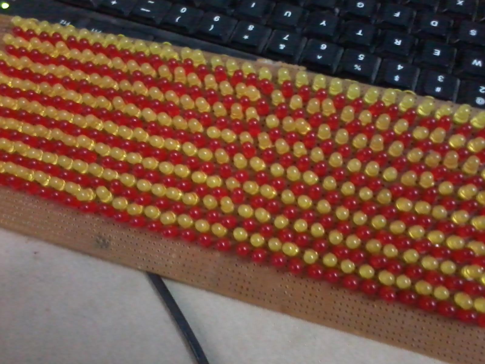

Here is my setup
Here is my code to do this

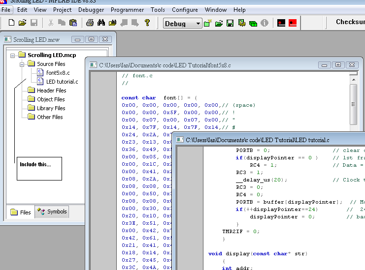

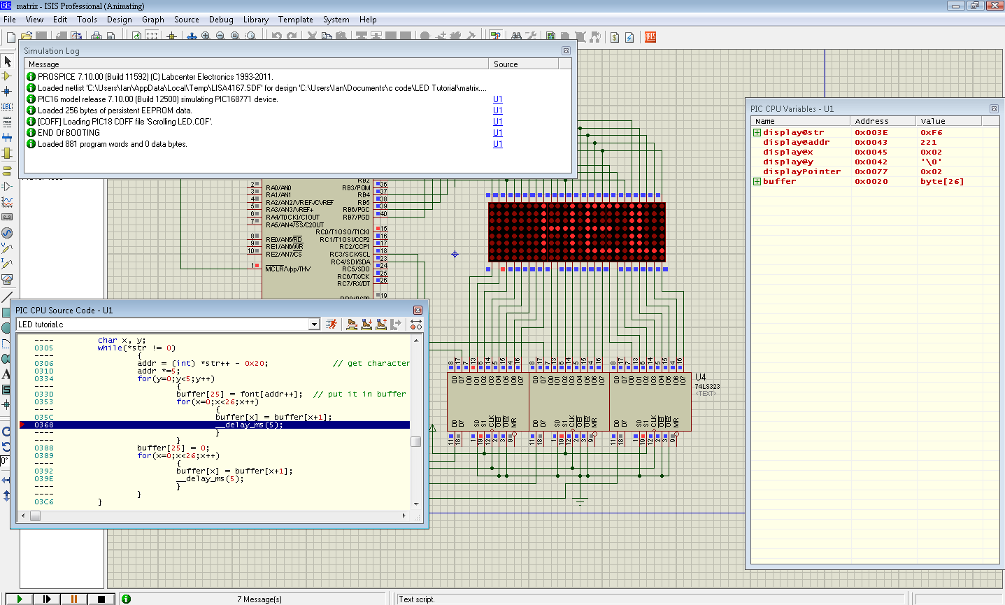

This does work Each data column is loaded just off screen then scrolled into view..

FINALLY.... The whole point of interrupts is they are called when required...If you notice I set the Timer2 to interrupt when it overflows...
This means that every 1.4mS a column is lit... My example has 24 columns.. Therefore we have 33mS per scan , You will be able to change the buffer to 29 and scan to 28 without there being much difference...

Here is my setup

		PORTB = 0;					// clear old data first
		if(displayPointer == 0 )  	// 1st frame..
			RC4 = 1;				// Data = 1 on the first clock
		RC3 = 1;
		__delay_us(20);				// Clock the shift registers
		RC3 = 0;
		RC4 = 0;
		PORTB = buffer[displayPointer];	 // Move buffer line by line
		if(++displayPointer==24) 		//  24 LED columns
			displayPointer = 0;			// back to first..
	TMR2IF = 0;
void display(const char* str)
	int addr;
	char x, y;
	while(*str != 0)					// while there is still characters
		addr = (int) *str++ - 0x20;		// get character
		addr *=5;
		for(y=0;y<5;y++)				// 5x8 font so 5 columns
			buffer[25] = font[addr++];  // put it in buffer
			for(x=0;x<26;x++)
				buffer[x] = buffer[x+1];	// shift all the columns <--
				__delay_ms(5);				// so you can see it
		buffer[25] = 0;						// This is the scpace between
		for(x=0;x<26;x++)					// the characters.. Or they will be too close
			buffer[x] = buffer[x+1];		//	shift the space in
			__delay_ms(5);
			}							// NOTE!!! your array is 28 not 24 like mine
void main(void)
	ADCON1 = 0x6;
	T2CON = 0x1e;
	PR2 = 129;							// timer preload value
	TMR2IE = 1;							// enable timer 2 interrupt
	PEIE = 1;							// enable peripheral interrupt
	GIE = 1;							// enableglobal interrupt
	TRISB = 0;							// Port B as output...
	TRISC = 0;							// Port C as ouput...
	while(1)
		display("HELLO WORLD!!!    ");   // Here's the message
	}	// End main
not working with 20mhz crystal (12pf capacitor) the serial data & clk was giving pulse but portb is zero at all time don't know why???
Play with the setting of PR2.... Also the small delay after each buffer shift... I used these settings on ISIS... With real LEDs you may need a faster scan... take PR2 down to 90 or 80, the brightness of the LEDs will suffer though
Nice video....
Nice video....
thanks
I am still confused with the code logic anyway what is the use of PR here??
i am using 32 column now and confused with you are using sometimes 24 26 buffer like that why??
PR2 determine the LED ON time, at the moment its 1.4mS... As I said if you make this smaller, the LEDs are going to be duller... Compromise situation...
I only need a 25 byte buffer for a 24 column display... So you can draw the columns off screen..
Now i am using two different led per 74164 output both anode are tie up to 74164 directly and the cathode to BC547 via PORTB...
the base R is 3.3K and I am using a series resistance of ~150/220ohms connected to gnd common of BJT. the problem is that some row light very little don't know why??
the single Red of other display was working fine....
