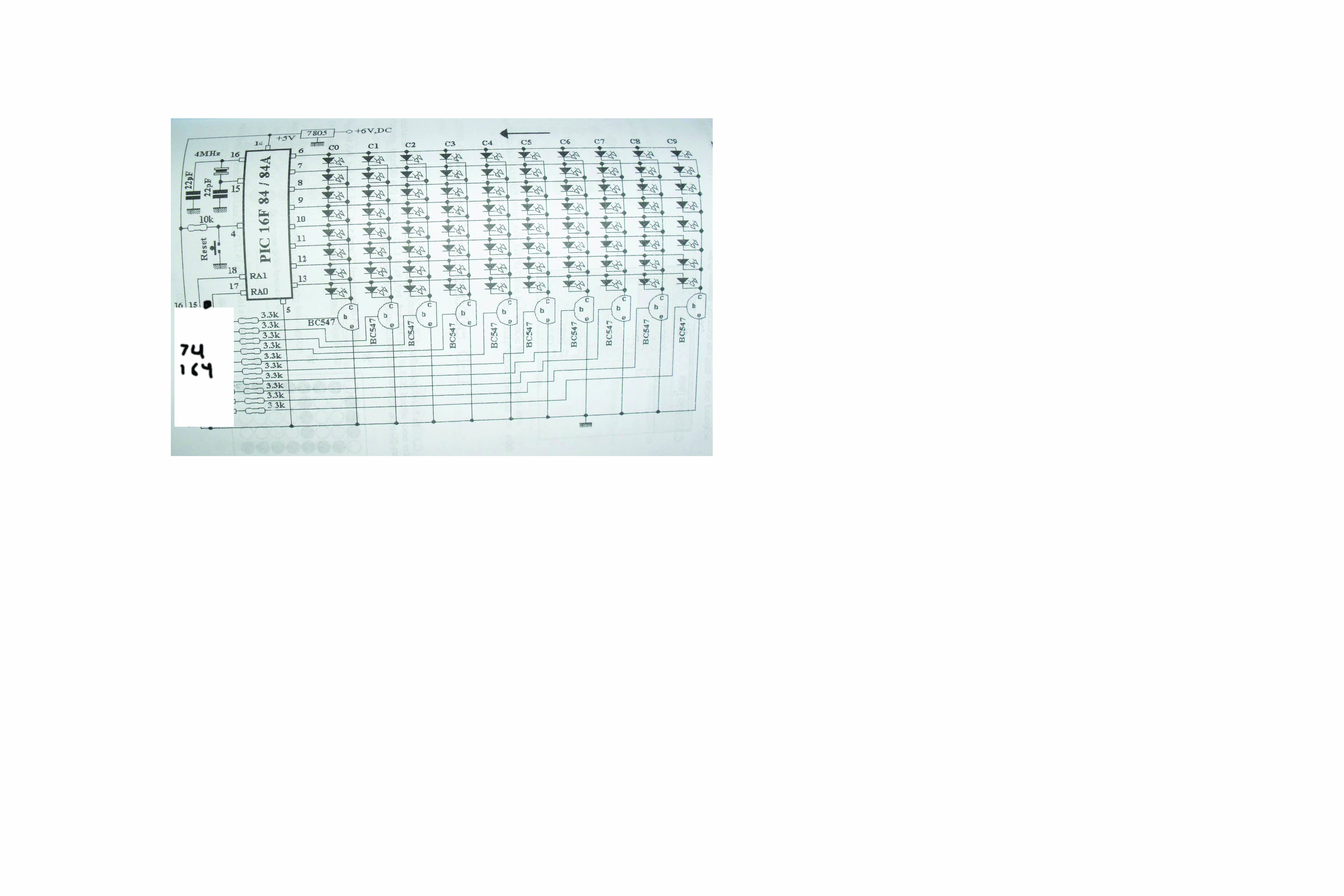

OK, I am working scrolling LED display for 8x8 LED matrix just for now so, i have used 4017 it was working fine with big code without any keypad to input the data ...
but after searching i found 74164 is used for serial to parallel converter for cascading large column so, i have problem to convert the data example 0x5f to serial feeding to 74164 i was using data array to solve this problem..i have to convert hex to binary vice versa.
int a[8]= {0,1,0,1,1,1,1,1};
for(int i=0; i<8;i++){
RST=0;
RST=1;
CLK=0;
CLK=1;
data=a[i];
please tell how to do this in fast and efficient way!!
I have seen this on AAC... Can you post me a small schematic so I can see what you're doing... I'd like to have it on ISIS, so I can see whats occurring!!! Then I'll be able to test the code you post.
I'll try and grab the code you posted on AAC as well.
Here is schematic 4017 to 74164 the data a b are connected to gather to PORTD7 and clk and reset to PORTD6 PORTD5...like this.
OK... First off... Why do we need the external IC'c? The schematic shows a pic16f84a, If you use a 877a you can use port D for rows and port C for columns!!
If you intended to expand the column drivers to incorporate MANY 8x8 matrices I'll use the 4017 and 74164 to drive a single matrix!!
If you are driving "several" matrices, you may not be able to keep up the duty cycle needed for a ficker free display...
Come to think of it... Why do you need the decade counter???
In my "Nigel's tutorials in C" https://www.electro-tech-online.com/threads/directorial-antenna.467/ Tutorial 13
In here you can find out how Nigel used TMR2 interrupt to run ASCII text on an 8x8 matrix.
I have seen many application notes which say, when you need to connect large number of Led shift register are used...to shift the same data and scroll like that.
