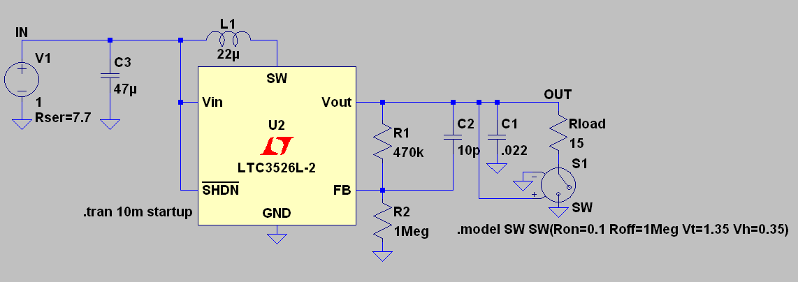

One idea for the single cell project.
The "SW" is set to turn on at 1.7V and off at 1.0V.
Boost maximum is 1.75V Probably should be set to 2V.
Not running exactly at "max power point" but close. It will take many more parts to run exactly at max power.
If the OP could be persuaded to use an MCU, MPP could be implemented and the motor could be turned on and off by the MCU too.

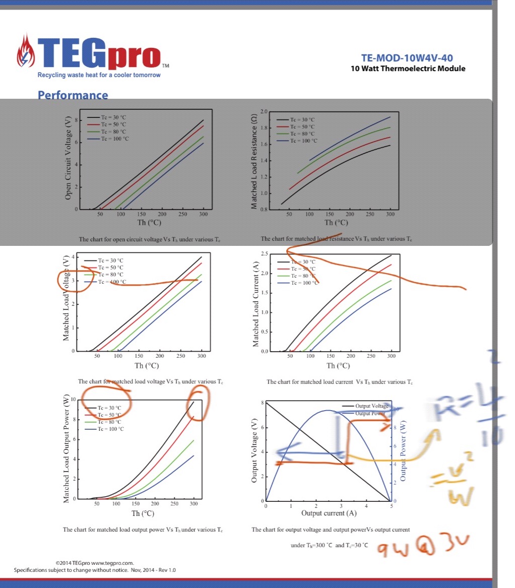

  1. Let's try a different load to see how it changes everything.
  2. Consider 3 x 3W LED' each with some identical transfer function, that looks something like thus
  • <2.85V the current drops off exponentially LED must be kept cool pref << 60'C for longer life 2x for every 10 deg drop in temp rise, (Arhennius Effect)
  • the cold side of the Seeback Thermal Electric Genererator (TEG) wafer also needs to be cool to generate power (useful to share heatsink method with LED alum-clad PCB, if possible) Seebeck Effect.
  • LED current rises = a quasi linear Effective Series Resistor (ESR) above.2.85V for white or blue according to curves in datasheet or my rule, approx ESR= 1/W @25'C such as a 3W LED is 0.33Ω. or **If= (Vf-2.85)/0.33 [A]
  • (quasi=almost),, ESR refers to internal conduction losses which "every" electrical part has...
  • Since 3 LEDs is series ESR's will add or total string of 9W max with ESR=1Ω at ~9V this does not match TEG, so let's try parallel 3 LEDs (same type and pref same batch, thus same ESR, which can have 10% tolerance typ or better or worse, depending on supplier quality (Consider Toshiba) Now we have 9 W load with ESR=0.11Ω when Vf >2.85V
  1. Now examine TEG imperfections and see how rise in cool side T reduces Pmax out, lowers Vout and increases ideal linear load. But LED's are like all diodes nonlinear unless piece-wise approximated as Vf= 2.85V + If*ESR
  2. It is possible to match all these curves into transfer functions and simulate in a spreadsheet
  3. (these may be 3rd or 4th yr fundamentals in Eng non-linear courses or simple math you can put in a spreadsheet)
  4. Maximum power transfer Theorem states this occurs when source and load impedances are same
  5. So basically TEG rises in Voltage until 3V and when light turns on , diode "saturates" ESR is like a voltage regulator to the TEG or a power Zener at around 3V where current that can be supplid to 3 LEDs in parallel matches the load presented (see **)
  6. So an ideal zero loss design would match the power source to the load and have no added lossy parts and is mwchanically cooled and heated by design to satisfy the Rja or junction to ambient thermal resistance of heatsink. I would expect 0.2'C/W CPU cooler might be good for small 4x4 cm Alum substrate PCB with copper traces.
    • For finger poking on iPad design, this is what I suggest. 30AWG magnet wire between LED's on Alum-clad cold PCB with cold side of TEG and hot side differential thermally isolated and only TEG, LEDS, PWB, cooler and wire.
    • Some may suggest adding small R to each LED to balance the current sharing from ESR mismatch e.g. 25% of LED ESR to prevent "Thermal Runaway" but if you have good LEDs, this is not critical as they may be matched to within 0.1% if in same batch. or 1% from similar batches.
  • No DC-DC converter required when load voltage matches voltage source at loaded condition, hence more efficiency
