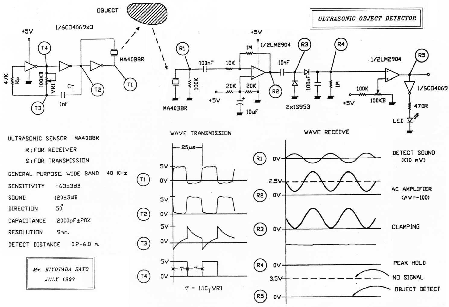

I've connected the circuit below which is uktrasonic object detector...
but the maximum range it covers is 20 to 25cm only ... i want to ask if any one can help me how to increase the range..... thanks
this is the circuit
1) Increase the supply voltage of the transmitter to up to 15V. Then the transmitted ultrasonic will be much louder.
2) Parallel the 3 unused inverters in the transmitter with the output inverter for much higher output current to drive the transducer louder.
3) Change the 1st opamp circuit in the receiver to a non-inverting type, It will have a much higher input impedance and hence much more gain. In fact it can then have any amount of gain. The inverting existing circuit has a fairly low 10k resistance loading-down the output of the microphone transducer. Since the microphone transducer is high impedance, the gain of the inverting opamp is very low.

Hello audioguru
thank u for ur help and giudance
I followed the steps that u mentioned 4 increasing the range( actually i did 1st and 2nd steps) and it works....
but the 3rd step which is converting the inverting op-amp in the reciver part to the non-inverting isn't clear 2 me.... I understood the purpose of using noninverting rather than inverting op-amp... but I don't know how to do it ... i know that the terminal 1 should be grounded .. if i am not wrong ... but I don't know what is the specification that i have to consider ... I ask u if u can provide me more details about the 3rd step ......

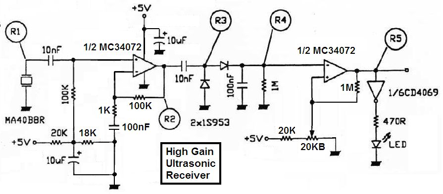

Hi Alen,
1) I used a much faster opamp that still works at the very low supply voltage of 5V, and its inputs still work at ground. Its power supply current will be a few mA.
2) I made the 1st one non-inverting with a high input impedance and a gain of 101.
3) I added a bit of hysteresis to the output opamp so it doesn't oscillate at its threshold voltage.
Try it, you'll like it. :lol:
