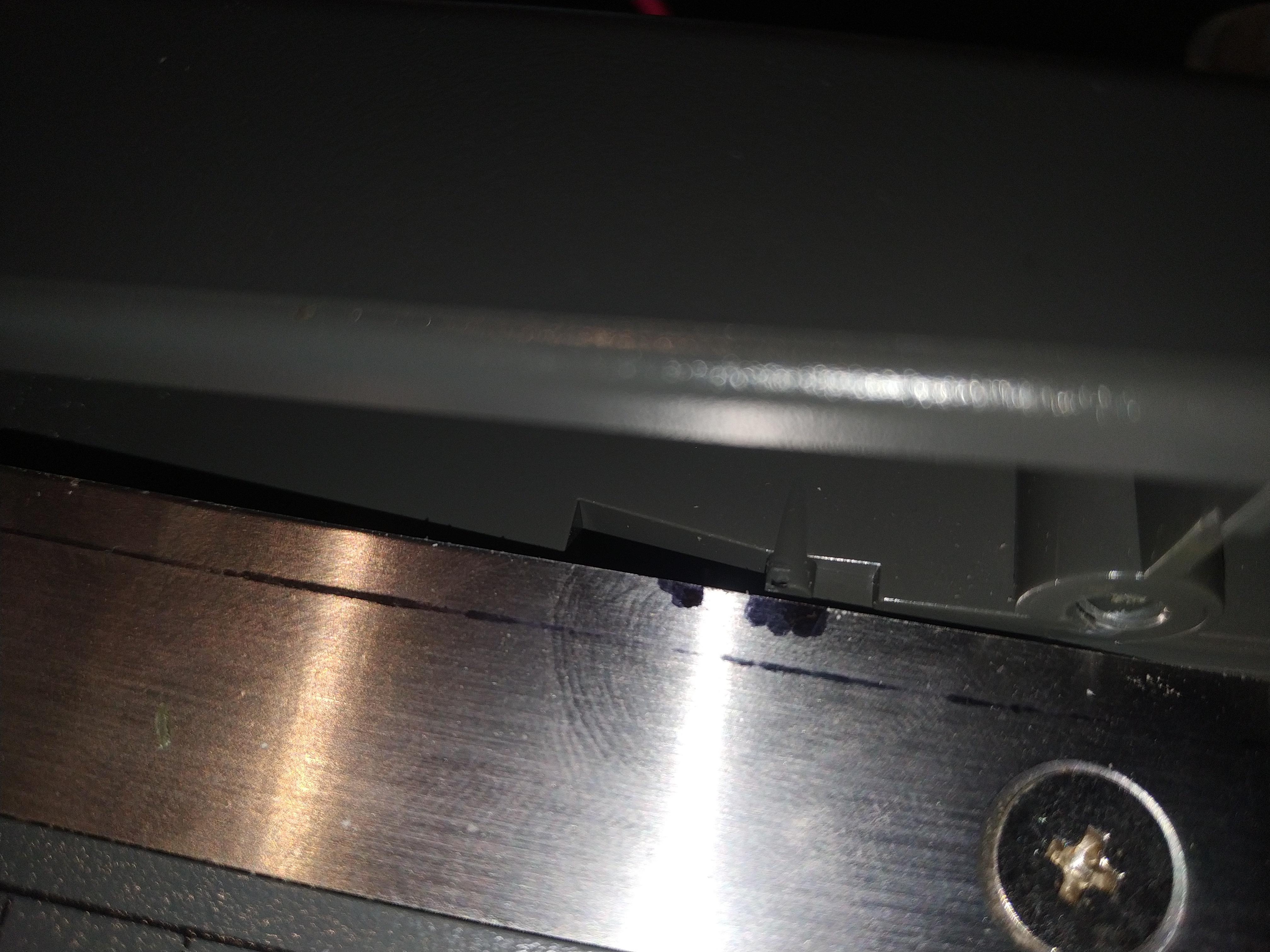

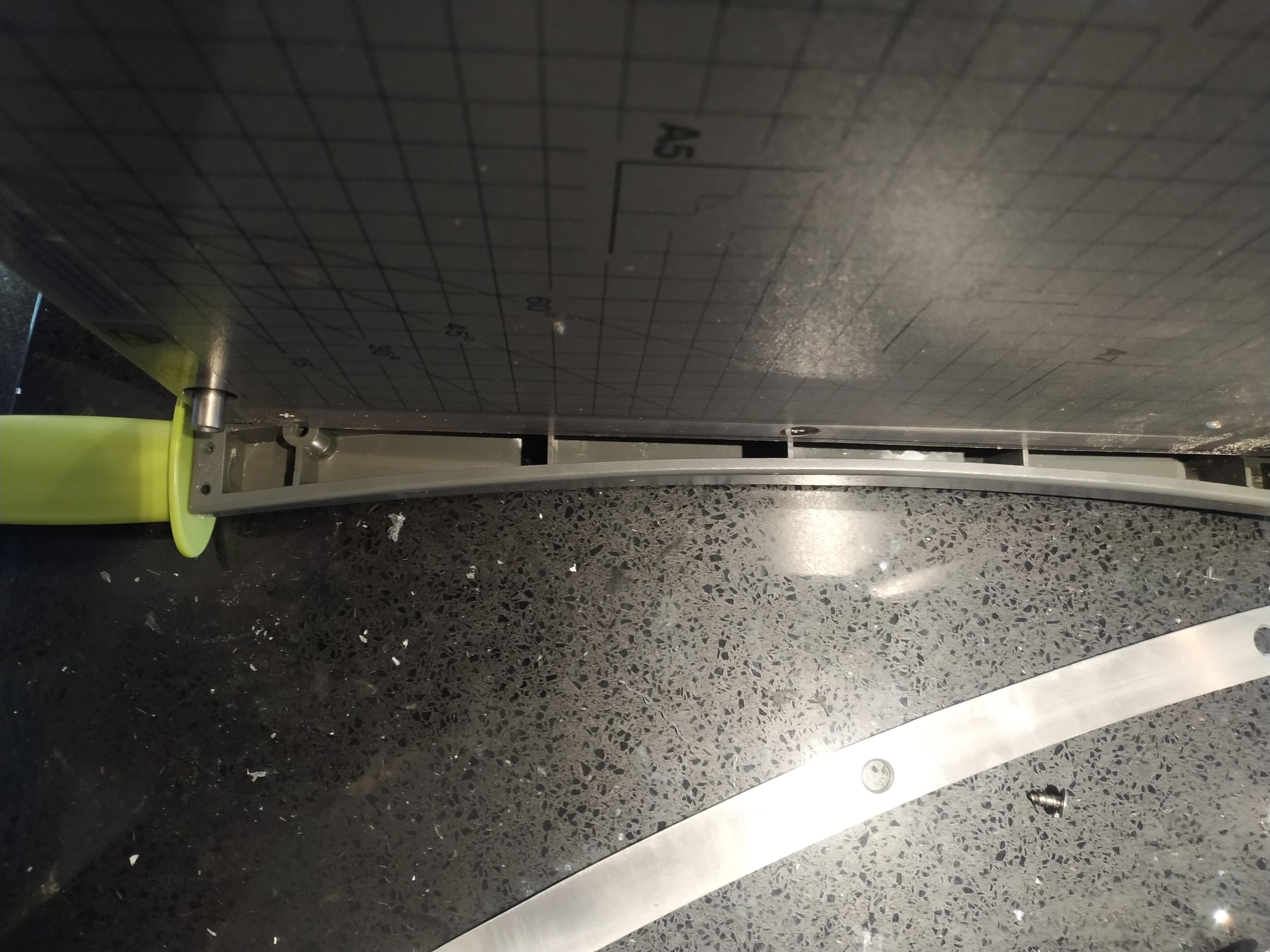

I'd be quite interested in having a mechanism that turns the power off when the blade is locked. There is a lever that stops it from being opened, when the lever is engaged. Any ideas?
A picture showing the lock mechanism would help. Possible solutions are a micro switch, a reed switch and magnet or an optical sensor, The optical sensor would take some current even when the lights are turned off. (About 10 to 20 mA.)
Les.

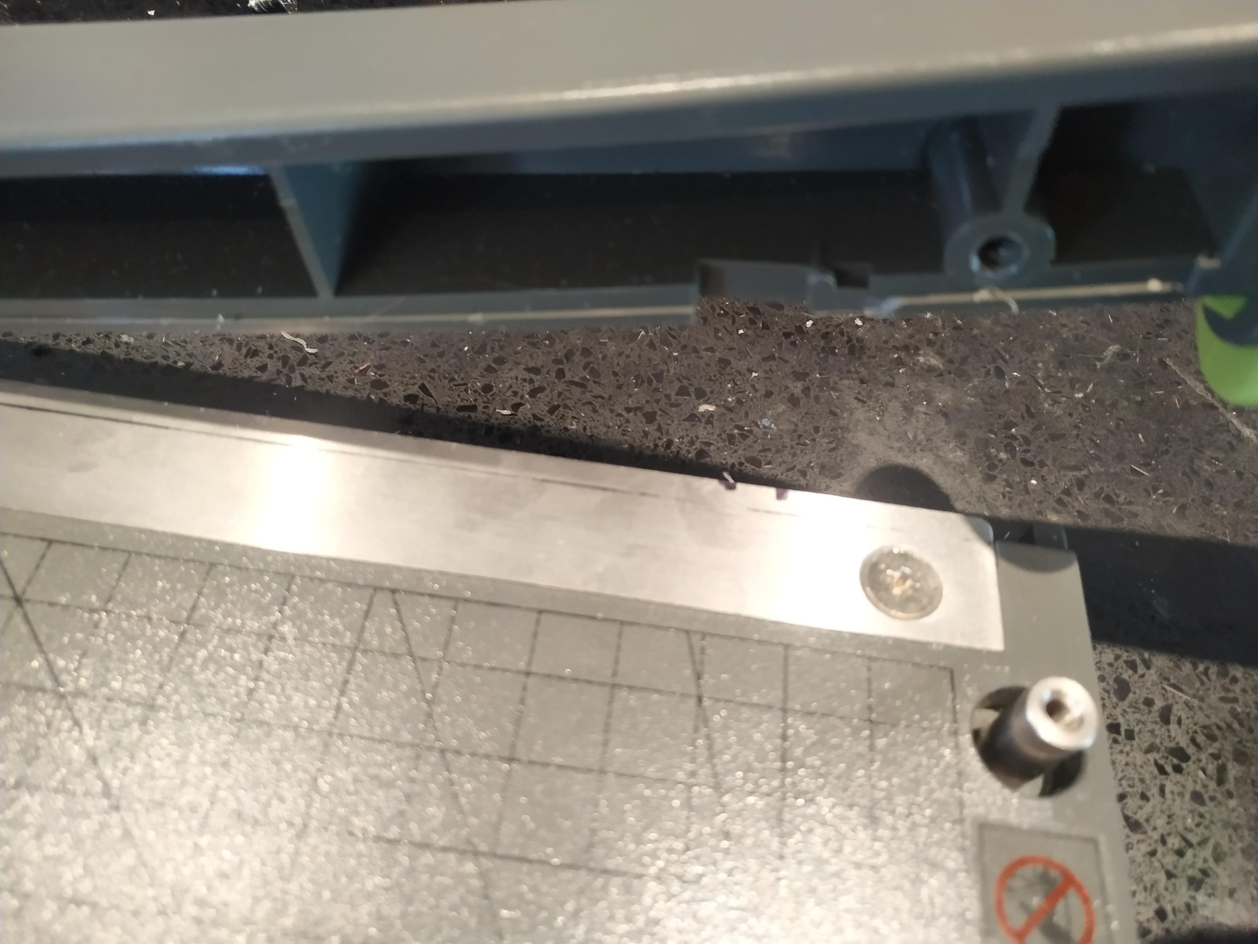

small micro switch such as this one would probably be the simplest solution. The lever on the micro switch could be operated by the hook part of the latch. (Post #11 picture 4)
Les.

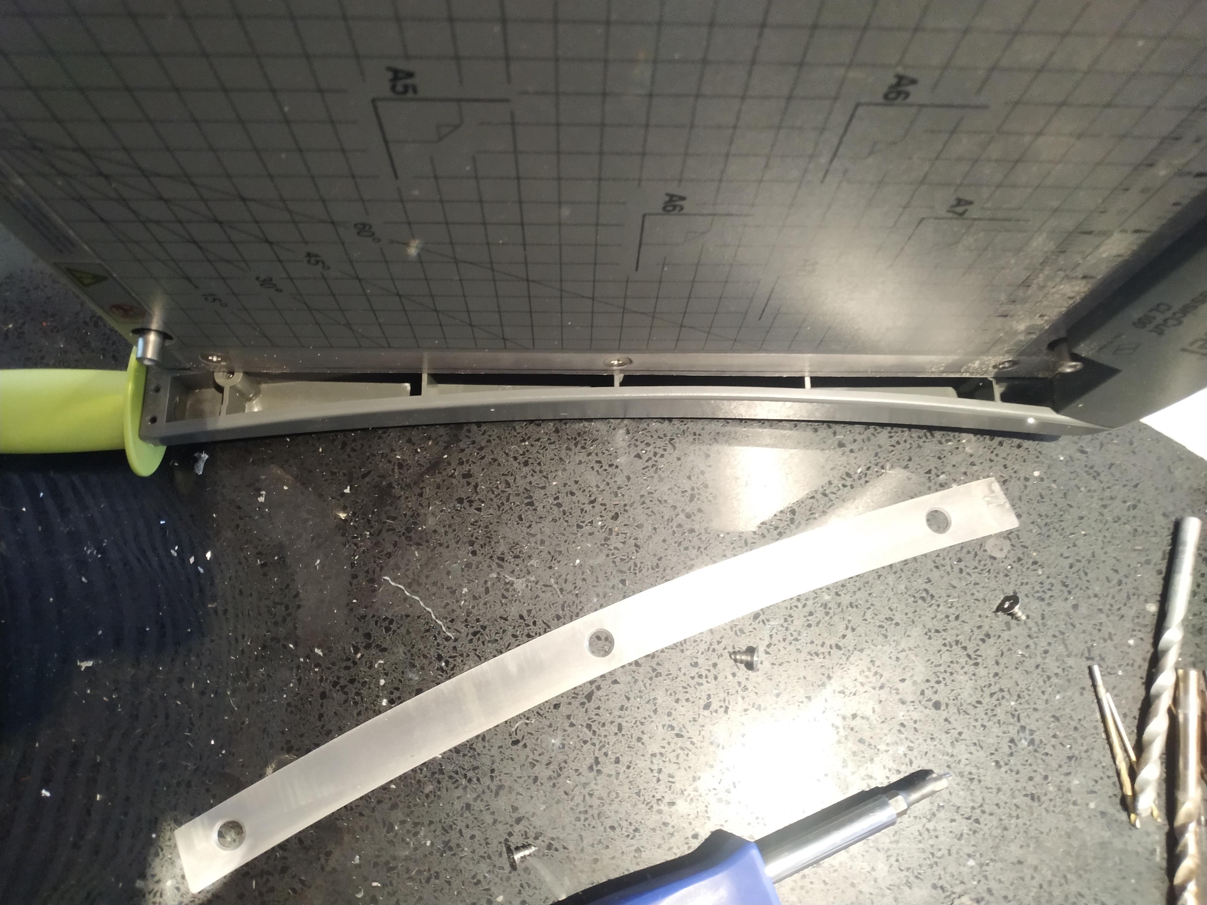

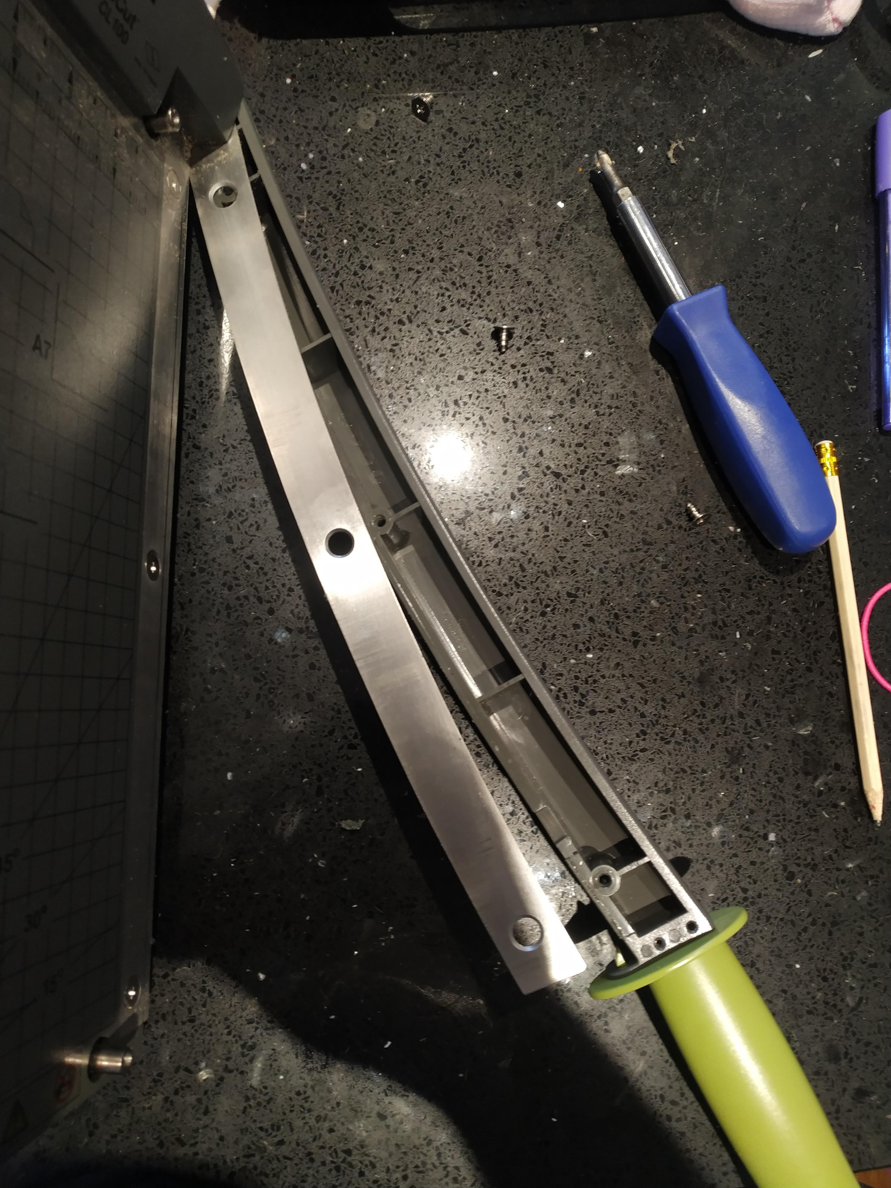

Thanks Les, that sounds like a good option. So the switch would be located in the handle, that means routing a cable from the handle to the body of the guillotine. What's the best way to wire in a situation where a cable is going to be moving (because the pivot point is taken up by a bolt that holds the blade to the body of the tool)? I worry about cable fatigue.
Also, how would I know whether to choose 1A or 2A on the switch?
I don't know why that supplier lists items with different current ratings when they are the same physical size and both options are the same price. The 1A and 2A are the maximum rated current rating of the contacts. I don't think the LED strip will consume even 1 amp. (Unless it is a very large guillotine requiring a long LED stip ) The link was the first seller on ebay that I found with micro switches that look suitable. You will probably be able to find them cheaper and in smaller quantities than 10. From the pictures I can't visualise the construction of the guillotine so I can't suggest an alternative place to put the switch.
Les.

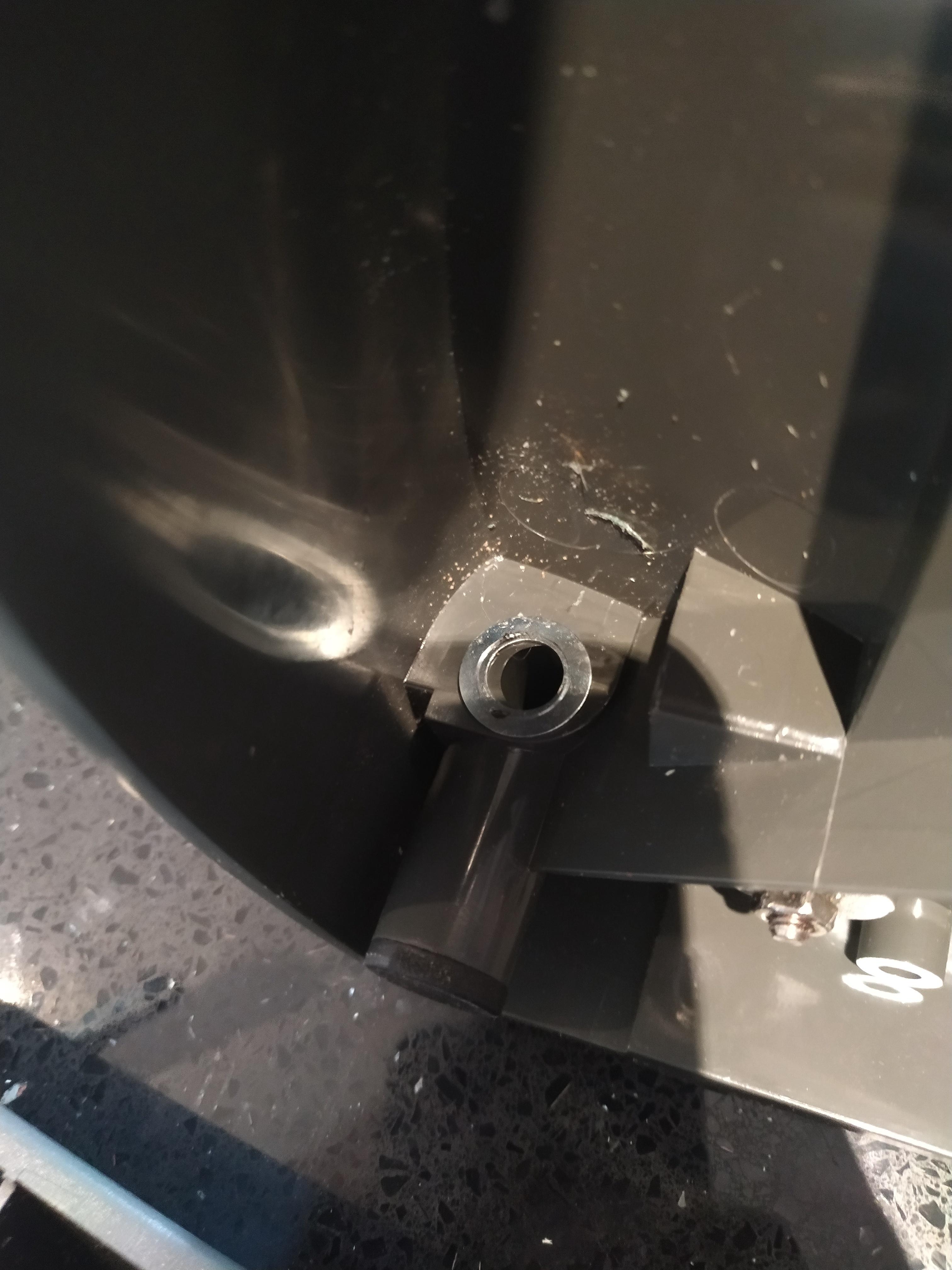

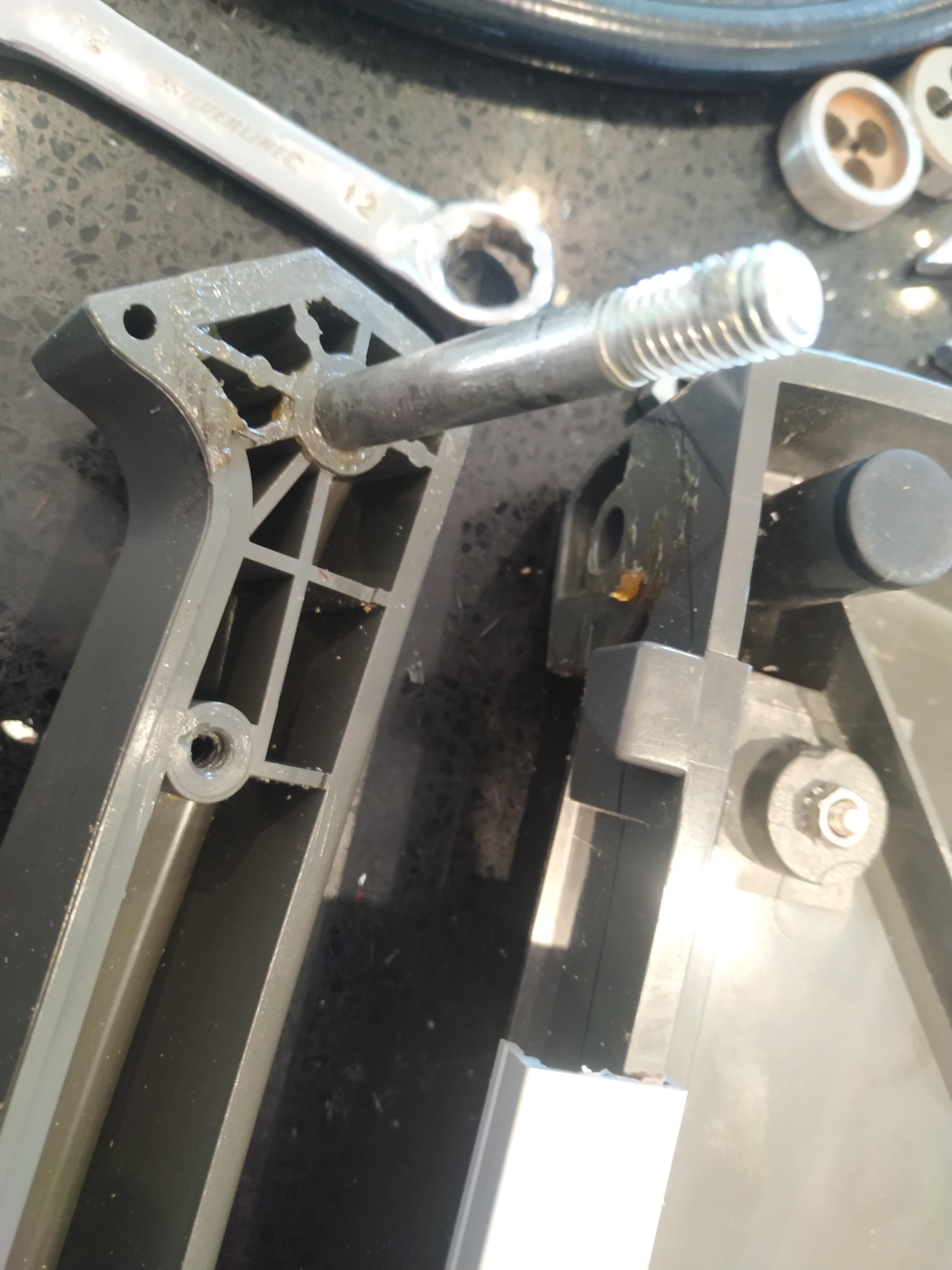

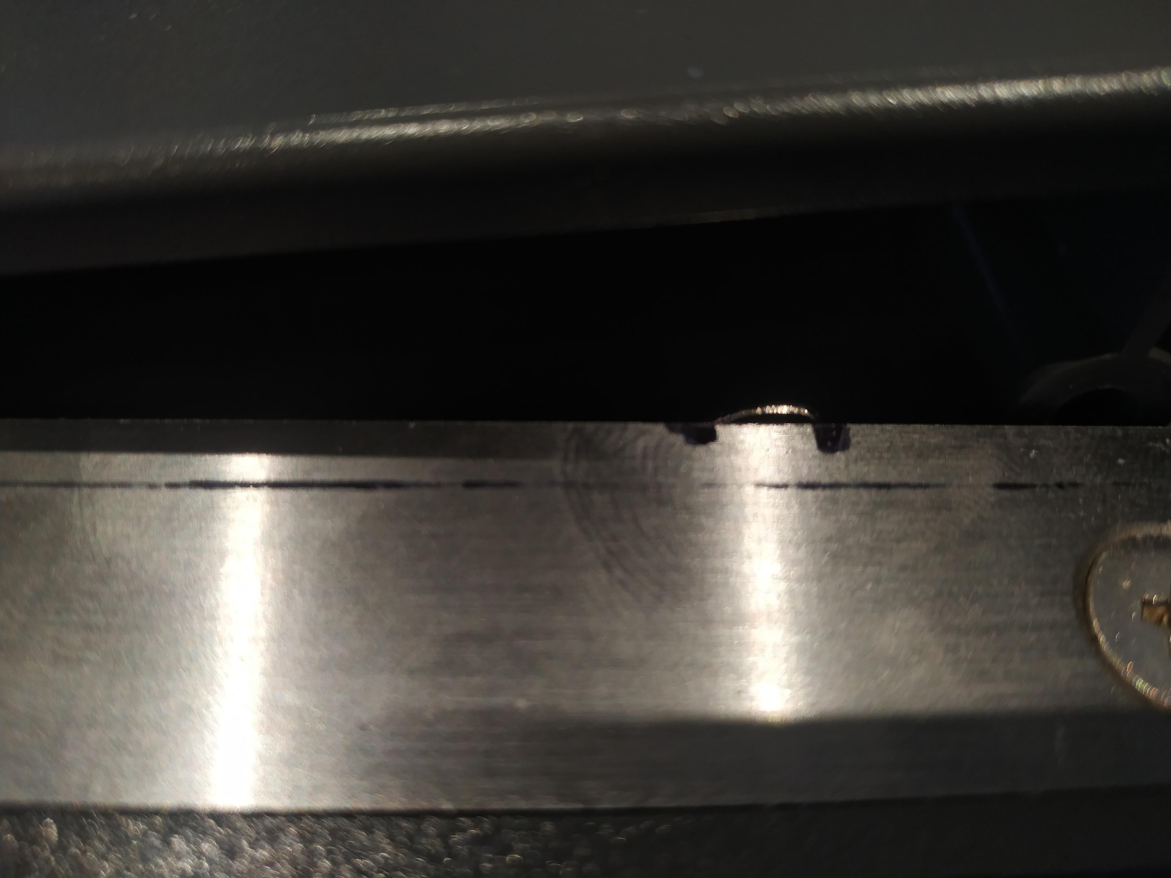

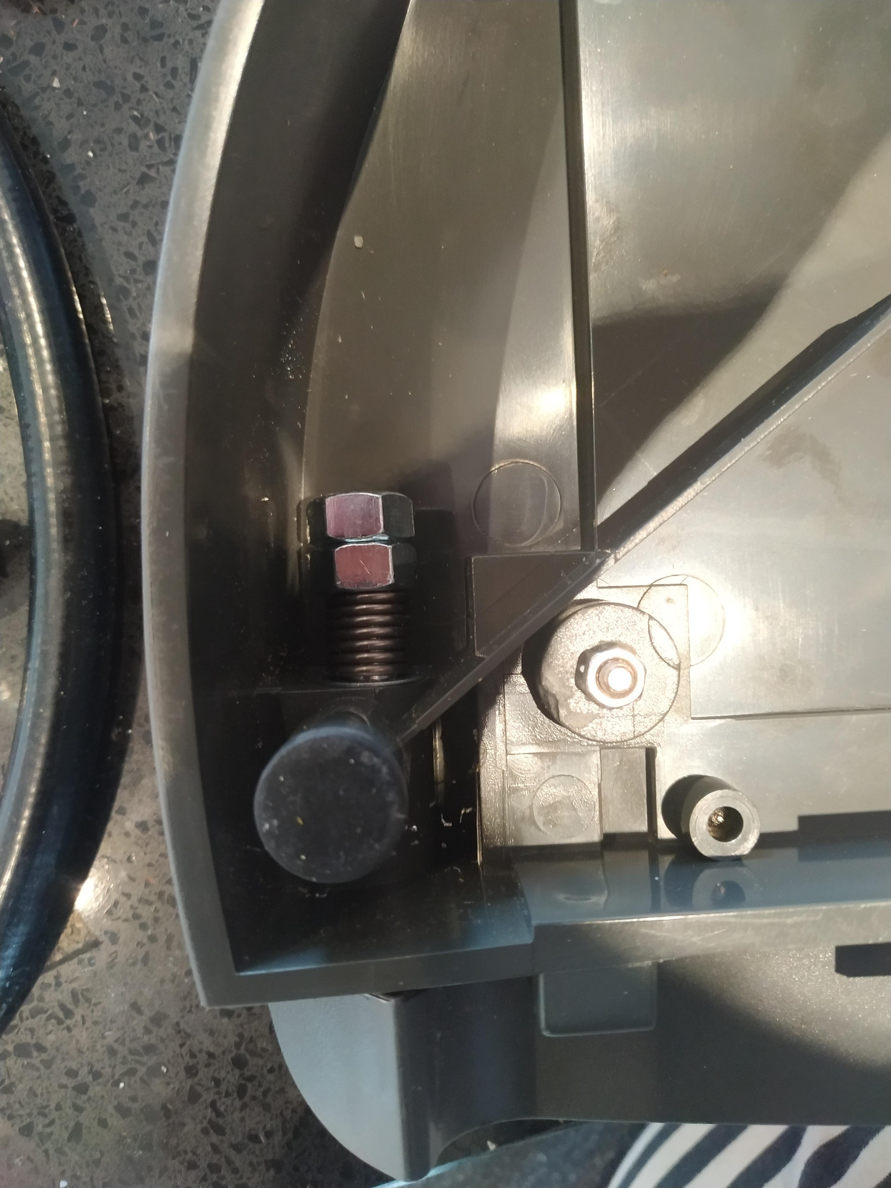

Look at the second photo, showing the underside of the guillotine with the latch and handle.
Could you drill a small hole through the end plate so a switch could be attached inside the front (in the top, as oriented in the photo) with the end of the operating lever through the end so it's operated by the blade, as that hits the fully down point?
It would not be operating directly from the lock, but it would hit the switch any time the blade is fully down, which it also is when locked.
A V3 style switch with a short lever could work there?

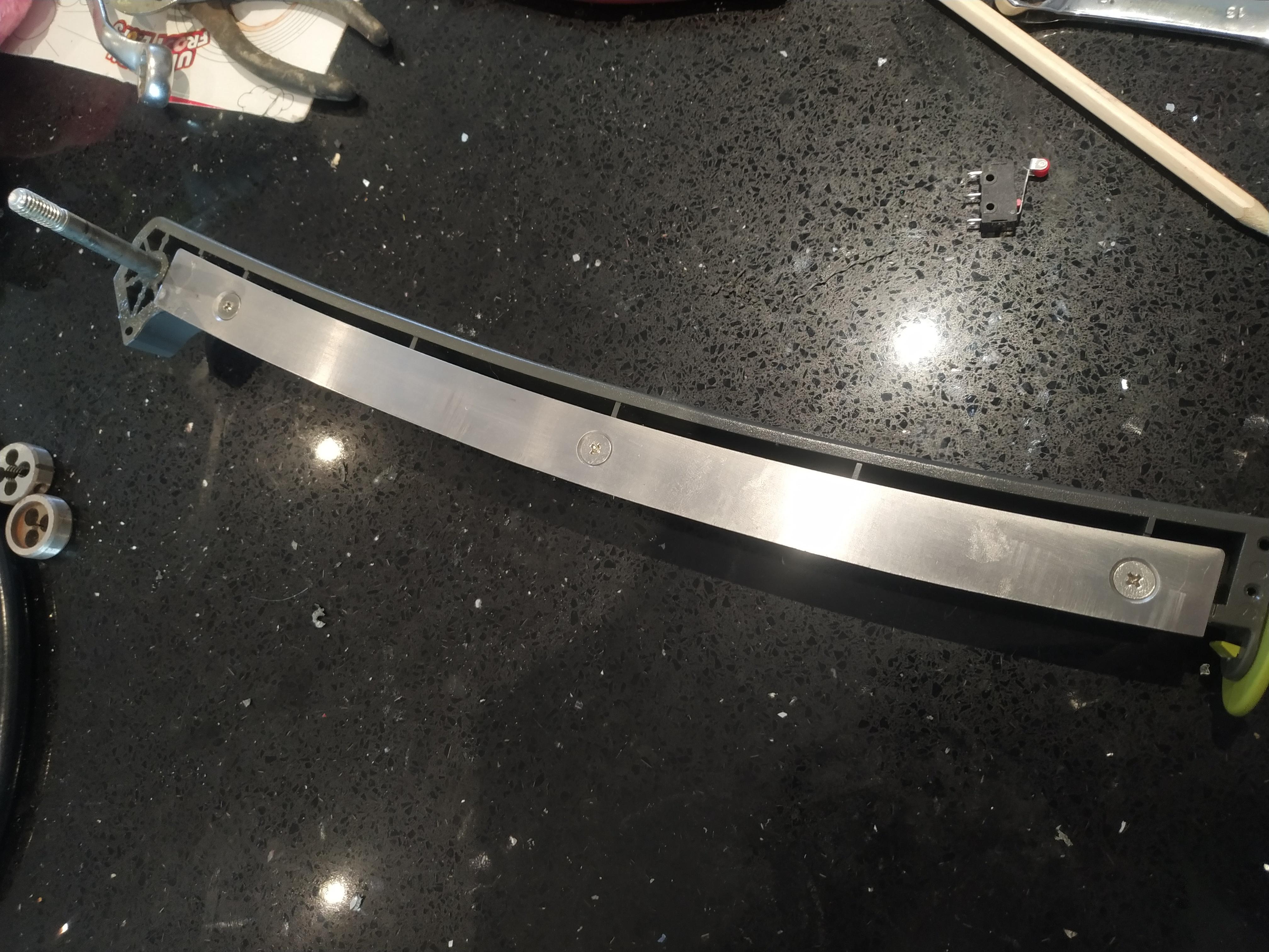

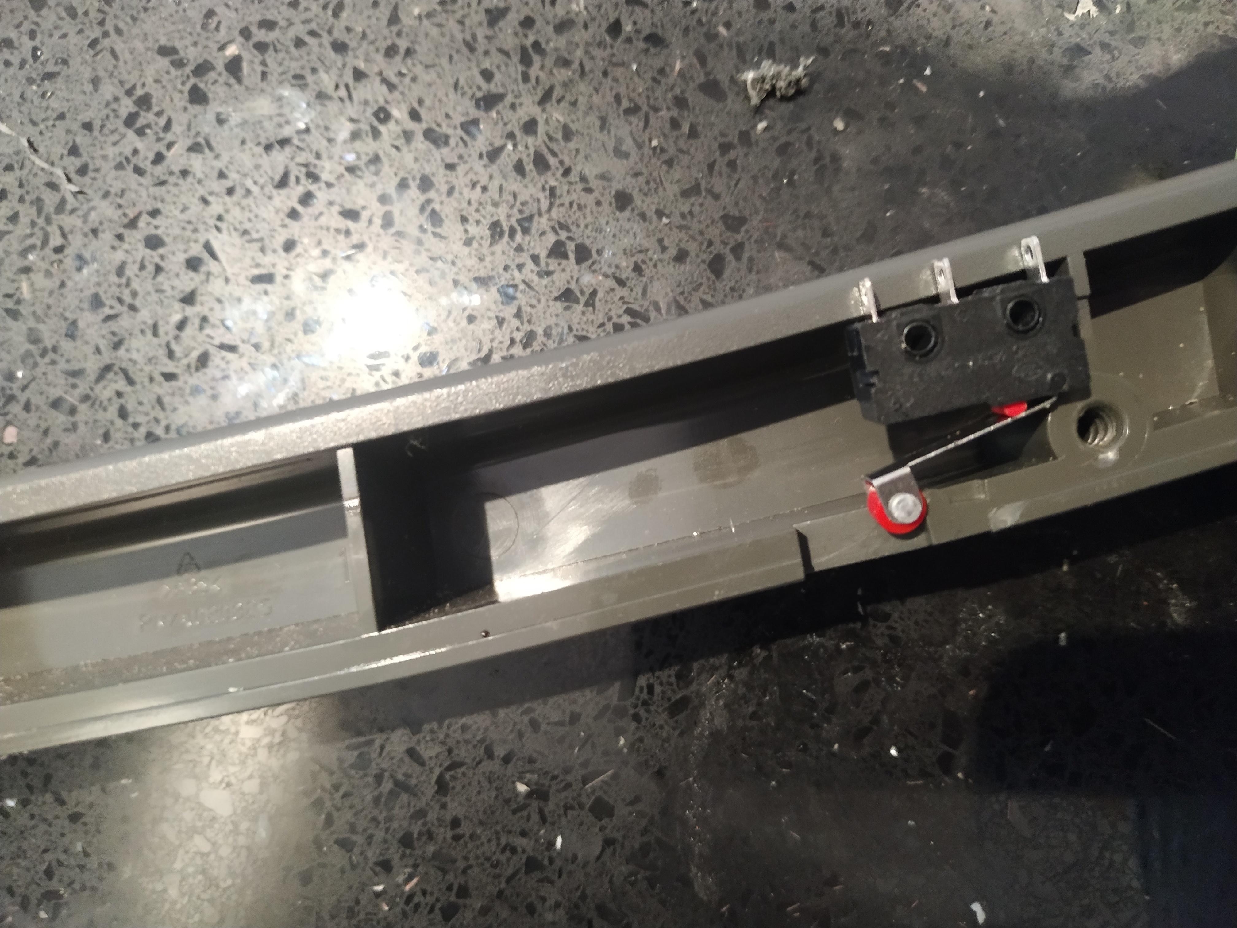

Thanks for your replies and apologies for not getting back sooner, I was waiting for parts to come from China. The V3 switch is too big for the space and I can't see a good place for a wire to transfer from the guillotine handle to the base.
I didn't mean to put the switch in the handle - I was thinking of it being inside the corner of the base in front of the latch, with the end of the switch actuating lever through a hole so it's pressed by the blade & operates the switch when the blade is fully down?
I was hoping to make it safer by making the light turn off only when the lock is engaged. I'm still hoping that there's a way.
