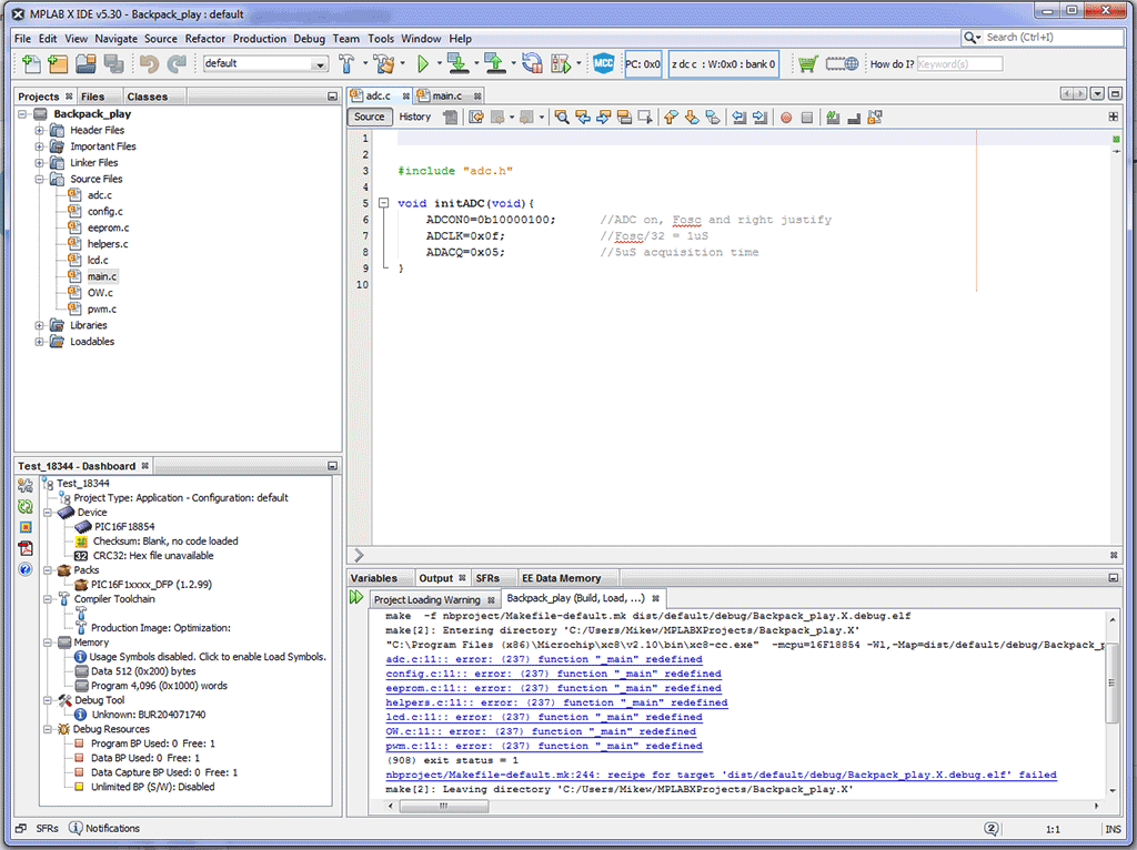

I have a project that I want to use as the basis for a new project. I use copy in MPLABX to get a new project.
Try to compile the new project and get an error
"newProject.X.debug.elf does not exist or is not executable"
So, I go find said file and find that all debug and production files still have the old project name.
I rename them to the new project name.
It now compiles.
After a little while any changes I make are not being effected.
I check the files again, I now have two sets of files, the ones I renamed and a new set with the old project name.
Checking the file times, I notice the old project named files have the current time.
I think it's compiling to the old named files and loading the new named files. Hence, no changes are being made!!
HOW is such a buggy piece of software even allowed to exist.
Anyone know how to get around this?
OK, tried again.
Created a new project.
Can't copy the .c and .h files as it then doesn't add them to the various compile time files and it won't compile.
So, I add all the required files, exit the IDE and copy over the files with the old project files that contain what I need.
When I open the IDE again and try to compile, it complains that main is redefined in ALL .c files.
I don't know what or where the files are that it's compiling but they're not the ones in my project.
This is what it shows me,
In the error window it says _main is redefined in adc.c but when I click on adc.c in my project it shows the file in the source window.
I HATE MPLAX. It is the buggiest piece of software I've ever encountered.

I've just tried it.
Copy with a new name, close original project & compile the new version - it gives an error that the output file does not exist.
All I had to do to make it work again was rename the "main" source file to match the new project name. I was guessing that was what set the names for the output files & it seems to work.
My main source file is always called main in all my projects - maybe that's the problem. I found that if I edited each file so it forced a save then all was OK. It, MPLABX (spit, spit), seems to keep a separate copy of your source files (no idea where). I'll give it another try tomorrow. Actually, you may have done the same thing as me, renaming may force a save and if that's the only file then all will be OK. After two hours of trying to just start a project from another project I need a rest.

I just load a project the saveas another name / folder... Seems to work for me.
How? SaveAs (project) isn't on my menu! I can save one source file but not a project. The only option seems to be copy which doesn't work.
I just clicked on the source file in the editor, then the 'save as' option appeared.
Personally I've never been as clever as the suggestions in this thread - I simply create a new project with the name I want, then copy the source code files only over.
You may be on a newer build..... BUT!! just copy the directory.. reload and rename... Its just as simple..
