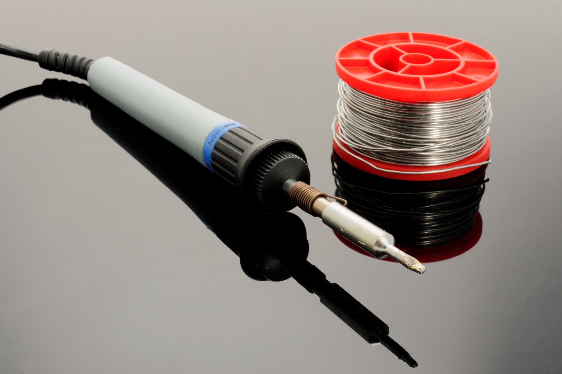

....has multiple negative reviews about the tip. How do we knoe if they are correct, or the people are just not looking after the tip correctly...or they dont know about tip cleaner?
Is a solder iron tip a single solid piece of metal with no external coating, or does it depend on an outer coating layer, and once that coating is damaged, its dead?
Better iron tips are "coated" with a harder metal to prevent "leaching" of the tip with the solder. That is, something like a pure copper tip will dissolve some copper from the tip with each application of solder, as the copper joins with the solder when hot. It is very minor in most cases, but a copper tip does wear fast if used a lot. The copper simply "disappears" into the solder over time.
A coated tip usually has a metal that resists leaching into solder, making the tip last a lot longer, often many years with intermittent use.

This soldering iron would not be my choice for electronics work. For one thing It is a 230V iron and could be a hazard if it develops an insulation fault in the heater element. It is also not temperature controlled.
You should be looking for a low voltage (24V is typical) temperature controlled soldering iron - but these will cost more than £14. I can definitely recommend Hakko soldering stations and for your purposes you might be able to pick up a refurbished one such as this https://www.ebay.co.uk/p/14027048359?iid=165279512975&rt=nc
They are reliable, you will always be able to get spare tips, and while these are expensive, they last a long time if you use the right solder.

Follow good tip hygiene. This means cleaning often as you are soldering, but also to clean thoroughly when you power down the iron, and leave a fresh solder coat.
There is a a lot of debate whether the “waterless” cleaning brass shavings are better than a wet sponge.
I personally prefer the latter, I feel it does less harm to the tip. Your mileage may vary, though.
Lastly, don’t ever, ever attempt to clean a tip with sandpaper. There is a special place in hell for those who do.

There are some flux cored solders such as Kester 331 which are designed for electronics work but which are more active than rosin cored solder. It also leaves a residue which is conductive and must be cleaned from the finished joints with hot water within 48 hours to prevent corrosion. An activated flux solder such as this should be avoided by hobbyists unless they are familiar with the precautions required.
Most users will obtain their solder from outlets catering to electronics hobbyists and these outlets will normally stock rosin cored or lightly activated flux cored solder which will not cause accelerated tip wear in normal use.
It should also be mentioned that a liquid flux is often used in addition to the cored solder to assist in removing oxidation from stubborn joints, or to assist in joining difficult to solder metals. These fluxes are generally more corrosive and result in increased wear of the tip plating irrespective of the type of flux in the solder itself. Hakko does not recommend using chemical "tip tinners" for the same reason.
General information for maximising soldering tip life;
"When it says "after cleaning" that means there should be no black spots or tiny areas where clean tin is not visible on the tip. When you get it to this condition all you need to do is to melt a small amount of new solder over the tip before switching off the iron. The solder blob will cool and protect the tip from oxidation until next used. At next use when the tip is heated you then only need to wipe the solder off either on the wet sponge or brass wire coil.
Sometimes you may find that after soldering some particularly dirty joints the tip will become repellent to new solder. If cleaning on the sponge doesn't allow the flux in the solder to produce a solder blob which covers the tip uniformly then it may require some extra steps to get clean. I have a small bottle of active flux and I place a drop on a small piece of thin brass shim plate I keep for the purpose. I then place the heated soldering iron tip in the drop of flux and apply more solder and run the tip around the brass plate until a nice pool of solder has formed. This usually cleans the tip completely. It is important to then clean the tip thoroughly on the wet sponge so that no trace of the activated flux remains. I then apply a new blob of solder to the tip before switching off the iron.
In essence this procedure amounts to using a chemical tip cleaner - which Hakko don't recommend. However this should only rarely be necessary and I have not found that it unduly accelerates tip wear.
