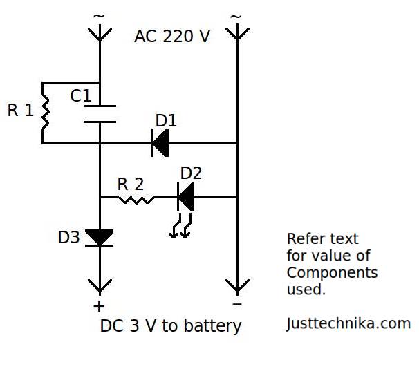

How does this circuit work
neptune
(D1 and D3 are diodes IN4007 and D2 is LED, R1=56 gigs ohms and R2 is 220 Mega ohms)
ok this person has built a battery charger without using step down transformer
How are we getting 3 V output ?
when +ve half cycle goes D1 stars conducting the capacitor charges normally but when -ve cycle goes , from where does the capacitor discharges through R1 or it goes directly to D3, what is the current direction ?

Bad, and dangerous circuit. It is the value of C1 that determines the current supplied. Circuit acts as a current source so there is no charge voltage cutoff on the battery.
The resistor across C1 is just a high value bleeder resistor to discharge the capacitor with circuit is unplugged.
There is a schematic error. D2 is backwards and will most likey be damaged by reverse voltage breakdown if installed backwards. This is a hokey amateur circuit that does not consider high frequency or rapid interference pulses that may occur on the incoming AC voltage (and hence getting through the series capacitor).

The circuit might work. It depends on what it is connected to.
D2 is the wrong way round in the diagram. It is the light that shows if there is an output voltage. However the light will flicker at 50 Hz.
The capacitor will limit the current drawn from the 220 V supply. Only AC current can pass though a capacitor, so there has to be as much forward current as reverse current. The forward current will go though D3, to the load. The reverse current will go though D1.
The circuit has three major problems as drawn, and two minor ones.
The largest problem is that there is no isolation from the mains input, so every point on the circuit has to be considered to be at mains voltage. There is nothing that you can do about that with this kind of circuit.
One major problem is that there is nothing to limit the output voltage. The current is limited by the capacitor, but with no load there will be hundreds of volts on the output. A zener diode or something similar should be added across the output to limit the voltage if there is no load.
The second major problem is that the capacitor will take a huge current if the circuit is turned on near the peak of the mains cycle. You should add a 1k resistor in series with the supply to limit the turn-on surge.
The first minor problem is that there is no smoothing of the output. The output voltage will be nearly zero for half of each cycle. You could add an electrolytic capacitor to smooth that out.
The second minor problem is that the LED is the wrong way round. In fact, if you have a capacitor, and you put the LED and resistor across that, the LED won't flicker.
However, it is usually far easier to find an old cellphone charger to do what that circuit does. That has none of the problems of this circuit.

The reactance of C1 is the voltage dropping element. Think of it as a series resistor that limits current.
C1 = (Ichg + Iled) / (0.45 x 2 x pi x Fmains x Vrms). The 0.45 is factor for average current from a half wave rectified current pulse.
For battery charging unfiltered current is okay as long as you take into account averaging factor. You may see 50Hz flicker in LED.
Again, D2 polarity is correct as shown in diagram. LED does need to be reversed.
Without mains isolation, this circuit is dangerous. I would not use it for a charger. Many commercial LED lights use similar capacitor ballast circuit but usually with full wave rectifier.

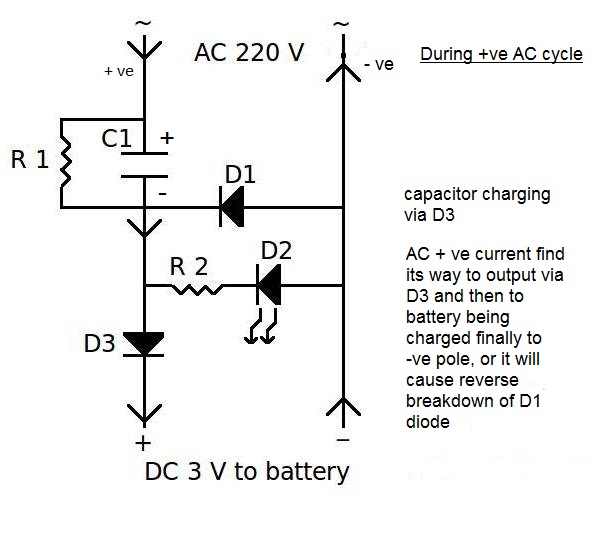

how can capacitor both charges and discharges via D1 ?
It charges through D3 and discharges through D1. It works identically to a voltage doubler circuit, in terms of charging paths.

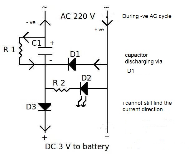

here what i found about what would happen to current during both -ve and +ve half cycles .. but i find it really absurd
Forget about R1 for a moment. Pretend it has been removed from the circuit. When current flows counter-clockwise in the circuit, it flows through C1, D3, external circuit ( battery in this case ) then through the -ve leg. During the other half-cycle, current flows through the -ve leg, D1 and C1. Thus the cap charges through D3 and discharges through D1.
I don't think so. When D1 is forward biassed it 'shorts out' the LED + R2 string. So the LED won't light on either half cycle.
This is a potentially lethal circuit for a charger, if users are able to plug/unplug batteries without bothering to turn off the mains supply.
understood, but during other half cycle current can also flows through -ve leg, D1,D3 to +ve leg also instead of -ve leg, D1 and C1.
also correct me that how can capacitor will discharge through D1 when it is reverse biased in respect to capacitor ? i think it will dicharge through D3 on other half cycle , when current is flowing clock wise.
Current can only flow from a higher voltage to a lower one. If it flows as you say, then it flows through -ve, D1, D3, battery, then where? Back through -ve again???? That would be quite impossible.
D1 is forward biased in the 2nd half-cycle. C1 was charged to +ve in the first half cycle. So, it's voltage is in series-aiding in the 2nd half cycle.
