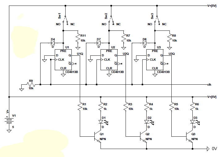

I've redrawn the circuit to clarify things (I hope!).
The switches SW1-SW3 are now shown in a more conventional way.
The latches are identified as type CD4013.
The D input of each latch is connected directly to 0V (represented by the triangle symbol).
R9 is the pull-down resistor which I mentioned in post #21 (the 4 resistors you added to the schematic were not connected to 0V as I suggested, and only one pull-down is necessary anyway).
R2-R6 are shown as 1k (which is perfectly suitable for 9V use, as you have already found).
Edit: All references to 5V on the schematic should be corrected to 9V. The NC contacts of the switches are unused, and the centre tabs connect to V+.
Let us know how you get on.

I'm setting a PCB for the schematich drawned by alec_t but I'm not sure about connections of CD4013.
This chip have 2 operational amplifiers inside, so I can use 1 chip for 2 switches, is it correct?
Then I've found at the "Holy" datasheet.com the pins configuration of the CD4013 that I've bought:
wich is the correspondence of the pins? I understand that:
PRE=set pin, D=data input, CLK=clock input.
But I don't have correspondence for the others pins, can you help me to connect the others pins?
Then I've one more question, where I have to connect the Vdd and Vss pins of CD4013?
Vdd to +9V and Vss to ground?
Yes. The two latches in the CD4013 can be used independently.
Pinout:
1= out 1, 2= not-out 1, 3= clock 1, 4= clear (reset) 1, 5= data 1, 6= preset (set) 1, 7= Vss (ground).
8= preset (set) 2, 9= data 2, 10= clear (reset) 2, 11= clock 2, 12= not-out 2, 13= out 2, 14= Vdd (+9V)
Pinout:
