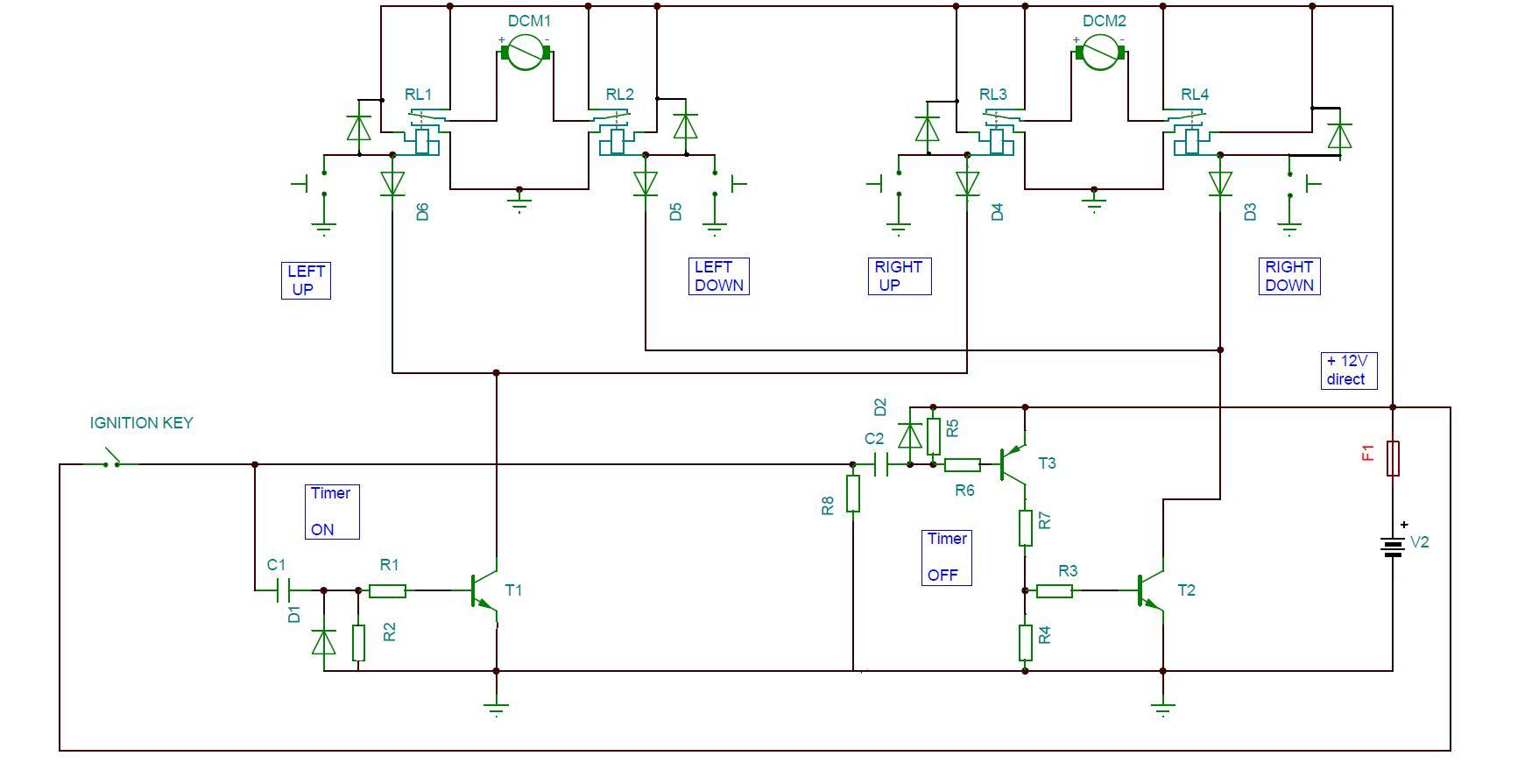

Cooooolllll!!!! That's along the same lines as I was thinking. I was told that the following circuit will also work. Please let me know what you think. And whether there is a big difference between it and the simplicity of your circuit.
[Simple relays circuit so the mirrors open when the car comes on and closes them when the car is off...]
I though you would already have a left mirror/off/right mirror select switch and an up/down/left/right movement switch. How do you kbow the mirrors will go back to the same position each time? I'm not sure how well time will work. On at least one of my cars, you could go and push the mirror physically. so, someone bumps the mirror and it's off again. Watch leakage paths with the semiconductors.
And somehow you have a retract/extend motor.
That IS a concern. The mirrors can be manually adjusted, so yeah, I have NO idea how I would get the mirrors to return to the appropriate position if shifted manually. Figured that would be something that I may just have to live with. I'm so lost right now...
