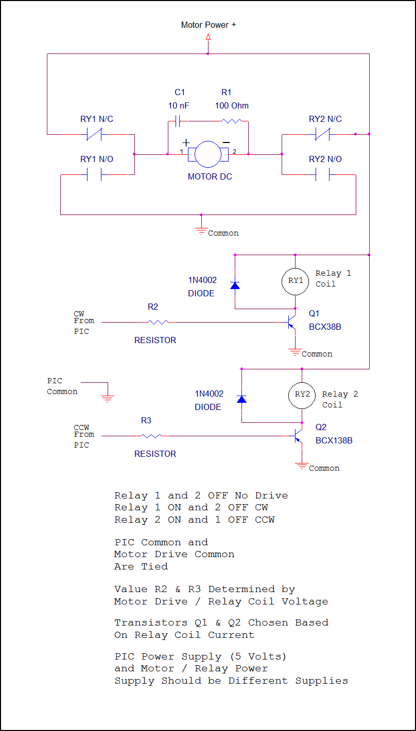

I guess i overlooked some specs and the drawing youve given uses a switch to control the motor direction. How can i use 2 different inputs to control direction with the relays?
thanks colin55, but im limited to 5v power supplies that come from a arduino board. Do you have anything that i can use with that?
I have attached a basic schematic of what I believe you are looking for. The circuit is an expansion of the circuit Eric posted back around post #6. This allows one PIC out for CW rotation and one for CCW rotation.
There are several ways to go about doing this. For example to totally isolate the motor circuit from the PIC an opto coupler could be used.
Generally I like to drive the motor and relay circuits with a separate discreet power supply as PIC chips really seem to dislike noise from the motor and relay coils.
One problem is if you want to drive a 5 volt motor it will require over twice the current of a 12 volt motor to do the same amount or work. The same holds true for the relay coils.
Something open for discussion with the circuit Colin posted is the full wave diode bridge using 8 diodes rated at 1 amp. Given a choice I would not parallel the diodes but use 4 diodes rated at 3 amps. Only to say I would not do it or configure the bridge that way.
Also there are turn key chip solutions out there that will do what you want done using an H bridge to drive a motor with PIC inputs so that is an option. Much of all of this depends on how big the motor is and the current it will draw. I did not include a fuse scheme in the schematic but fusing should be a consideration.

Thanks a lot Ron, this circuit looks like something simple i can build in no time.
The 5v supply is just switches. The motors have their own power supply coming from a solar cell. They both, combined take 500mA at 12v. So do i still need to fuse the lines or is this power consumption so small that if can be ignored?
Also, i had a quick question about your diagram, this might sound stupid but what is the purpose of the transistors? Are they there to not allow random voltage spikes to set the coil?

First the reason for the transistors. If you look at your PIC data sheet you will likely find the maximum current out of a DO (Digital Out) pin of your PIC is about 20 mA. That is hardly enough to pull in any relay. Thus we use a transistor to interface the PIC to the relay. Matter of fact you could use a TIP120 transistor with a 1KΩ base resistor. The idea is we drive the transistor into saturation using it as a switch and the transistor switches the relay. In general, do not exceed 20 mA per pin.
I think I read you were using an Arduino and if so you may want to give this a read. There is a section on motor control that includes some of the H bridge chips I mentioned earlier.
I would still fuse the motor simply because if for any reason the motor gets into a stall configuration things will get ugly as the motor begins to try to draw current well exceeding its ratings.
Ron
Another advantage of this type of relay drive circuit, is the dynamic braking action of the motor when the relay contacts short out the motor.
