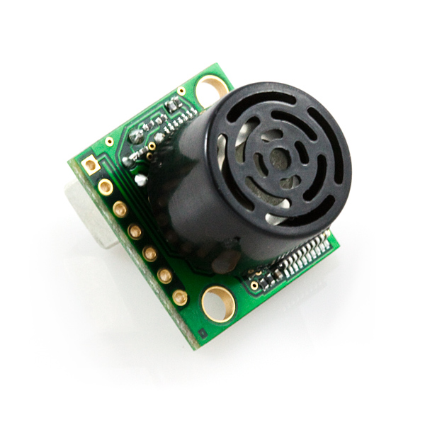

I think 7m will work. You need to mount the Ultrasonic sensor and the Raspberry Pi in different places.
https://www.sparkfun.com/products/9494
There are some like this that will go 10m.
https://www.sparkfun.com/products/11724

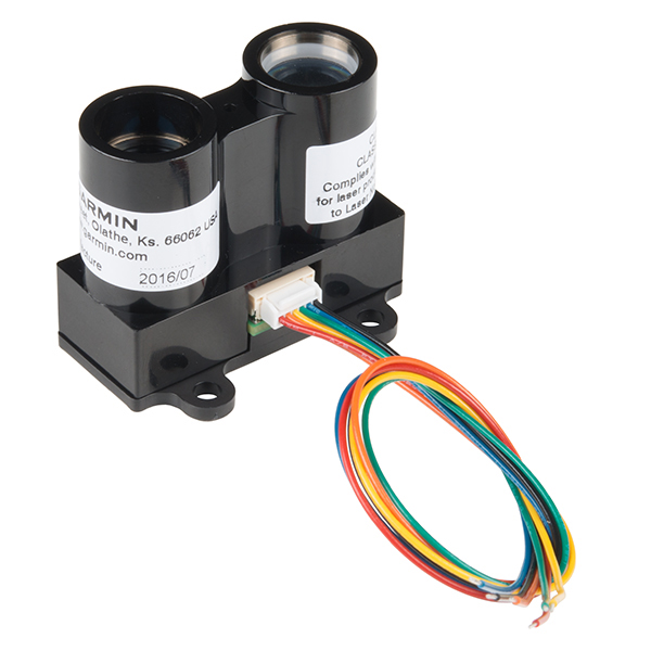

If you have money, 40 meters.
https://www.sparkfun.com/products/14032
