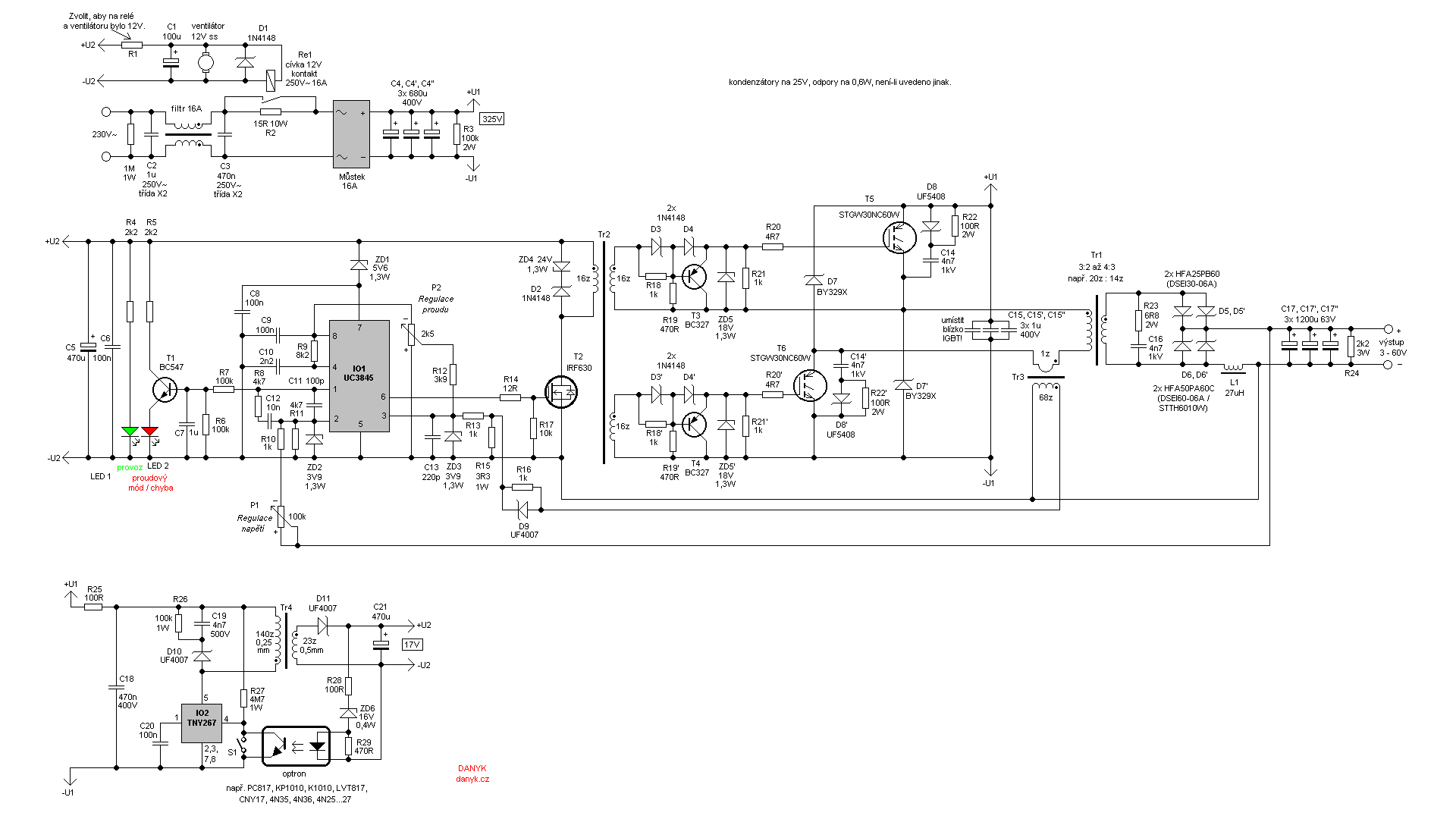

I'm looking for some help on this Adjustable SMPS Circuit found on Danyk.cz,
I've built the circuit on a PCB and everything works fine Voltage regulation etc...
But as soon as I attach a load (A 60 Watt 12V Light Bulb) in this case, the IGBTs short out and die, all 3 legs are shorted together.
I tried with 600v Mosfets as well but the same still happens.
It's not on the PCB I designed, but I have soldered RC Snubbers accross the IGBTs
Any Help would be much appreciated.

I don't see any provision in that circuit for dead-time to ensure one IGBT turns off fully before the other one turns on. Depending on how the feedback works to control the pulsing of T2, that might result in greater average shoot-through current through T5 and T6 when the circuit is driving a significant load than when it is idle.

Yes both IGBTs turn on together in a Two Switch Forward converter, anyone any ideas why the IGBTs keep blowing when under light load though?

I think theres meant to be some deadtime built into Tr2, one fet turns off while the other fet turns on, Zd4 and d2 are also important to get the transformer working right, the core type is also probably important.
Danyk did get this circuit to work.
Still migth be shoot through though, if you 'scope D9's anode you'll see if this is happening by huge spikes, these might not get back to the control chip because of the filter.

Not shoot through. Both transistors are to be on at the same time.

Somehow I thought this was a push pull, but its a 2 trans forward, the gdt is wired in phase so both trans's are on at the same time.
D7 and D7' conduct when the igbt's are off to reset the trans.
So maybe as pointed out check the o/p diodes, then maybe transformer coupling, the gdt should be trifilar wound, and then perhaps the compensation.
The Uc3845 is limited to 50% duty, so the clamp network with Zd4 in it needs to be greater than 1/2 U2 supply voltage to ensure tr2 and tr1 resets.

Good call. I checked, supply=17V and Clamp = 24.7. That seems OK.

I spose if tr1 was wound with incorrect phase this might happen, the thing will rectify magnetization current and maybe even regulate no load, but then saturate tr1 and blow the trannies when a load is applied.

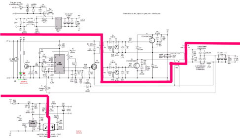

This post has incorrect information as pointed out by Nigel.
One thing to be aware of about this supply is that the output is NOT isolated from the input line voltage.
Even though it uses a transformer between the primary and the secondary, the fact that the feedback is directly connected from the output to the control circuitry in the primary defeats the isolation. Output negative is connected to the rectified primary negative.
So even adding some clearance distance on the PCB won't help. The circuit should be changed to provide voltage feedback through an optocoupler or some other isolated method.
I suggest you look further at the circuit, specifically the lower left corner! :D
Not that I'm recommending this design in any way.
You are correct.
I'm used to supplies that have the PWM control as part of the primary circuit. I did not see that this circuit has a separate, isolated supply for the PWM controller.
I fell in that trap to. The schematic is hard to follow. Luck me, I hit the edit button before Nigel came along.
