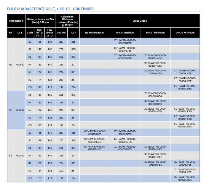

I'm playing with a number of LED's for an application but in particular the newer Cree XD16. This has a much smaller footprint than the XM-L2 and similar output up to 1A. It is rated to 2A. On the bench, any current over 1.2A provides minimal additional light output but generates a lot more heat. As such it appears light output (I use this term loosly but consider looking directly at the source so intensity) does not rise lineally with current.

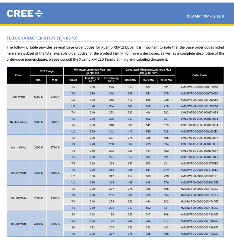

According to the datasheet the XM-L2 on the other hand starts to pull away at 2A although not by a huge margin, perhaps 10-20% more lumens. I haven't tested this emitter on the bench yet.
Am I right in saying using two XD16's in series with the same wattage (half current, more voltage) instead of a single XD16 will generate less heat, thus greater efficiency, thus more lumens at a given wattage, but the peak lux (intensity) will be less?

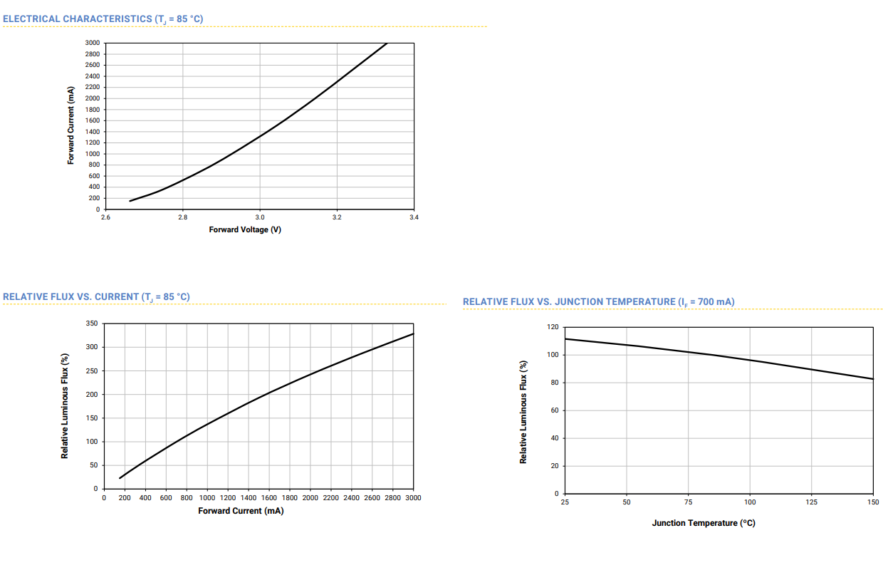

You are right that you will get better efficiency and LED by running the LEDs at less power, but it's hard to see a change of even 50%. When I've been involved in increasing light outputs, we are looking for a 4 times increase to be worthwhile when it's not a side by side comparison.
On the graphs shown, 3A will give a voltage drop of around 3.3 V, while 1.5 A will give maybe 3.05 V. That is an efficiency increase of 8.2% at 1.5A compared with 3 A
The light output at 3A is 325% compared to 700mA, while at 1.5A, the light output is 185% compared to 700 mA, so that is an efficiency increase of 13.8% at 1.5A compared to 3A.
The temperature rise will depend on what heatsink you have. To make a fair comparison, for the same light output, the heatsink would be the same whether you have two LEDs or one. The temperature resistance of the LEDs is 2.5°C/W, and there is about 10 W dissipated, so if changing to two will reduce the power per LED by 5 W and the temperature by around 12.5°C. That will increase the light output by a little bit, maybe 5%.
The total efficiency from reduced voltage, reduced temperature and reduced current is about 27%, but that is a rough estimate and isn't enough to be directly visible unless you had the two situations side by side.
The reduced power and temperature will increase LED life by a lot.
