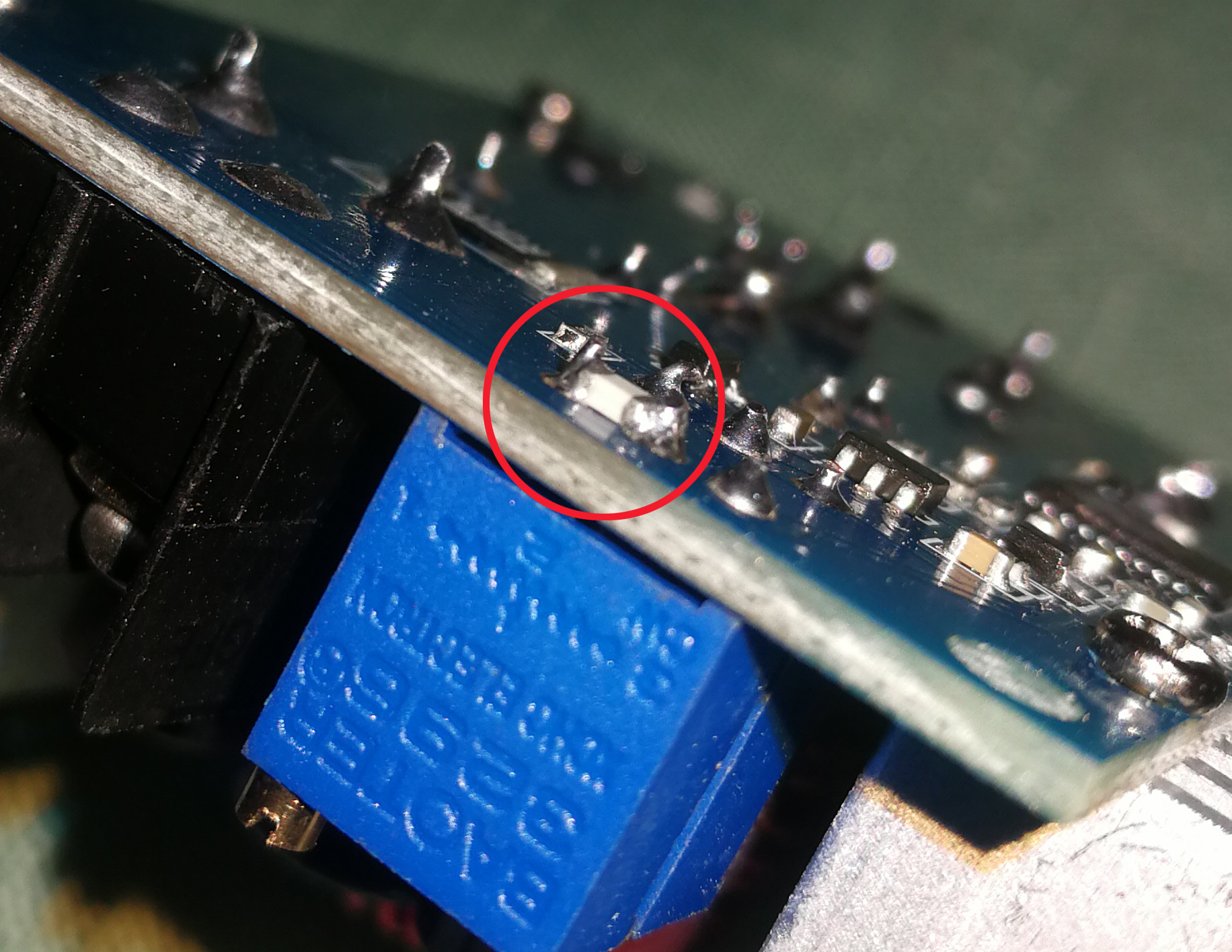

Hi Everyone. I took on a recent project in building a led light panel for my sister. I am following the relatively simple instructions laid out in the youtube video published by DIY Perks - How to make a super bright LED light panel. I am at the step where I need to solder an external potentiometer to the trimpot (potentiometer) that is on the board of the step-down voltage regulator (szbk07) I purchased. Everything was going smoothly but the pins on the trimpot, where I need to be, has a unknown piece soldered between the exact 2 pins I need to utilize. Does anyone have a clue as to what this rectangular, ceramic colored insert - that is soldered between these two pins, is? My skills with solder are adequate. My concern is that when I head up these leads, that piece will shift or slide right out. Should I be worried? I do appreciate any advice or insight into this, as I contacted the seller & he is clueless to the nuances of the product he is selling.

It's probably either a capacitor, a resistor but it's white which is a bit strange. They're normally brown, tan, or orange. It being white makes me think it's a resistor rather than a capacitor.
Or just not worry about any of that and desolder it and stick it back on later.
It might be some sort of fuse. They often come in white packages, though why it would be placed between pins of a trimpot I have no idea. If it falls off, simply solder it back on. Simple as that.

I looked up the power supply you are using. Most of the links were AliExpress and in a language I couldn't read. It looks like the outer trim pot is "voltage" and the inner one is "current."
When you say "solder" across it, Are you soldering just two pins of the new pot or all three pins of the pot to the 3 pins of the trimmer?
If just two pins of the new pot are soldered across those 2 pins, and it is a fuse, your new pot may not cause much if any change. If the white thing is intended as a short, you will see no effect from your new pot. If you are soldering all three pins across the three existing trimmer pins, then I agree with the above comments.

What I, sort of, got from the video is your essentially replacing the internal trim pot with an external one and a resistor. Likely, the resistor is the minimum on intensity. So, remove the trim pot.
Usually only two wires are needed. When only two are needed the wiper and either CW or the wiper an CCW are tied together. This is a reliability issue to do so.
A variable resistance changes the intensity. That's 2 wires. It either increases the resistance CW or decreases it. Same for light intensity. If you don;t know temporarily connect CW to wiper and the intensity goes the wrong way turning the control clockwise, connect CCW to wiper.

The original video to make the DIY LED floodlight was using an 8Amp DC-DC converter module based on the XL4016 IC. Although the 20 amp module you are using uses different switching components, the voltage (and probably current) control system appears to be the same. The way it works is this: the OUT+ voltage appears on one end of the voltage control pot (it is the left hand end if you place the module upside down with the OUT end nearest to you). The wiper (middle pin) and the right hand pin are connected together and go to the "Feedback" pin of the control system. In the case of the XL4016, "Feedback" is pin 2 and is the negative input of an operational amplifier inside the XL4016. In the case of the 20-amp module, it is a negative input of an operational amplifier that I have not managed to identify yet. In both cases, the positive input of that operational amplifier is maintained at 1.25 volts, probably by a band-gap circuit that produces a stable 1.25 voltage. There will also be a resistor to ground from the "Feedback" pin. In operation, these components form a negative feedback control loop that maintains the Feedback pin at 1.25 volts. Winding the voltage control pot one way to reduce its resistance reduces the output voltage; winding it the other way to increase its resistance increases the output voltage.
External components can be used to feed additional current to the Feedback pin. There are many possibilities. The simplest is to wind the on-board pot up to its maximum and then add an external pot between OUT+ and Feedback. This is quite easy because OUT+ is available as the positive output terminal; and Feedback is both the centre and right hand side pin of that Voltage control pot. By soldering the wire from your external pot to the right hand pin of the on-board pot, you avoid the issue of possibly dislodging the small white component which is between the left and centre pins. It think it is a capacitor, by the way.
I think the on-board pot is 10K. It is a common value and is the value used on the XL4016 module. It is not practical to measure it in-circuit because of the large capacitance in the module across OUT+ to OUT-.
The video instruction for the DIY floodlight recommends using a 22K pot. This will give a new maximum output voltage of about 24.5 Volts instead of 35 Volts. If this is sufficient for your application, that is all you need to do. If not, you will need to use a higher value external pot, or even remove the on-board pot, depending on how high you need the voltage to go.
Further options for controlling the output of this, and other similar, DC converters include feeding additional current to the Feedback pin using the PWM output of a microcontroller (or other PWM source). The PWM signal should be fed through a diode and a resistor of appropriate value, to give the desired range of control.
UPDATE 26 April 2018
After further testing I have concluded that the internal pot on the SZBK07 20 amp module is about 100K (not 10K as it is on the XL4016 module). So to get the same performance from the SZBK07 module your external pot needs to be 220 K. With a 22K pot, the range of adjustment you will get is from a maximum of 6.7 volts down to the feedback pin voltage which is 1.2 Volts. If you use a 220 K pot you will be able to get voltages up to at least 20Volts (my maximum was 21.6 Volts with a 220K resistor).
