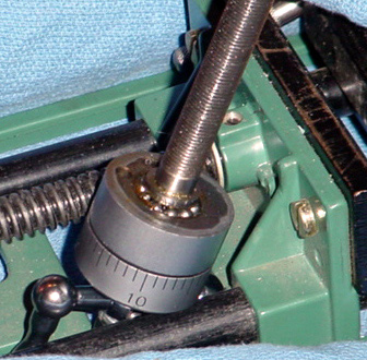

My first Harbor Freight Mini Lathe mod was to smooth up the action of the feeds. I lathed out a slot in the feed wheels and added ball bearings. Worked out pretty well. See image. I also got rid of the cheapy black plastic wheels.

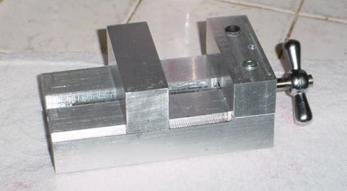

My first machine vice made with HFT micro mill.

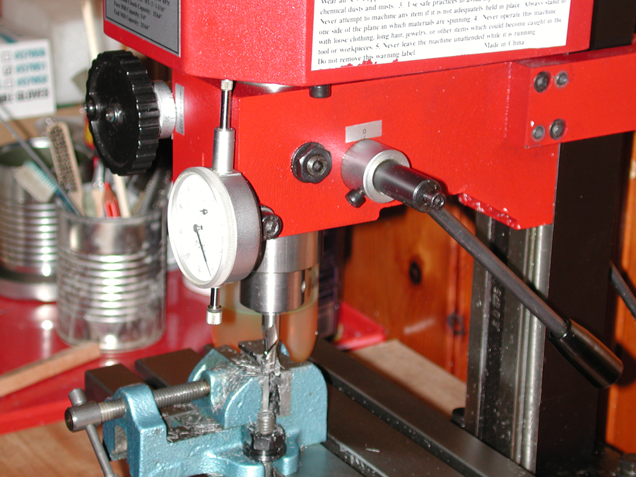

I tend to agree with HiTech, but when you need somehting at home and don't want to go to or don't have a shop, they have a function. The biggest "problem" I have seen with the micro mill is that you can't trust the feeds, particularly the down feed. A free moving, $10 dial indicator gave me a 1 inch "digital" read out of down feed. You can easily hold a few thousanths with the mill, but it is increasingly hard to hold less than that. It is fine for many purposed, though.

When you say you lathed a slot, you mean you cut it on a lathe? Then you have access to another lathe, then? I have two mini-lathes, but the're both busted. One is missing some parts, so I won't be getting two working lathes, unless I can scroungs up some extra parts.
That's a cool vise. What did you use for the lead screw/nut?

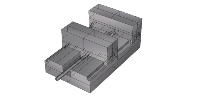

For the screw, I modified an off the shelf bolt. The nut is the movable jaw, I drilled the hole and installed an insert for strength. Attached is a 3D model I made of vise which may give clearer idea.

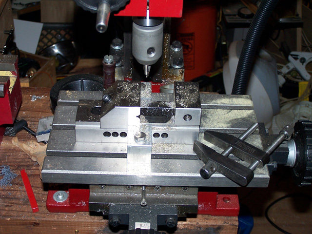

Your correct Brownout, this was just a practice project. The vice functions okay for some purposes but not adequate for milling work. I actually purchased a nice mill vice which cost me about $100. It is made of highest quality steel and very precise, money well spent. See photo.
By the way, I did fab the holding clamps that keep the vice on the mill table. I think I got the plans from Machinist magazine, I will look through my old issues if anyone wants to know the issue.

It looks like you have the same micromill I use. I suspect you will soon be frustrated by the inaccuracy of the downfeed. Here is how I attached the dial indicator mentioned earlier. You could drill and tap the headstock, but using the tension adjust screw works, and the indicator is easily moved out of position, if you need more than the 1" travel it allows. I made brass stand-off washers to fit into the csk hole on the headstock. That way, the mounting lug is riding between washers and is not pressed directly against the casting.

Very nice Jpan, I may just try that, I do have a gauge I could try. Thanks. BTW, your bit holder looks very nice, what size bit does it hold.
The biggest problem I have had with the mill is the table slopping around during work, if I tighten the table then it becomes hard to adjust the feeds.
