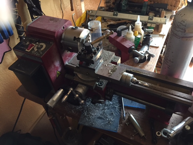

I have a Micro Lathe see below image. As has already been said, you need to provide tolerances. Also, must it be steel? Aluminum is much easier to work with. I can probably do what you want for free, just cover shipping, however I would like to see due diligence on your part, ie. create a drawing. :)

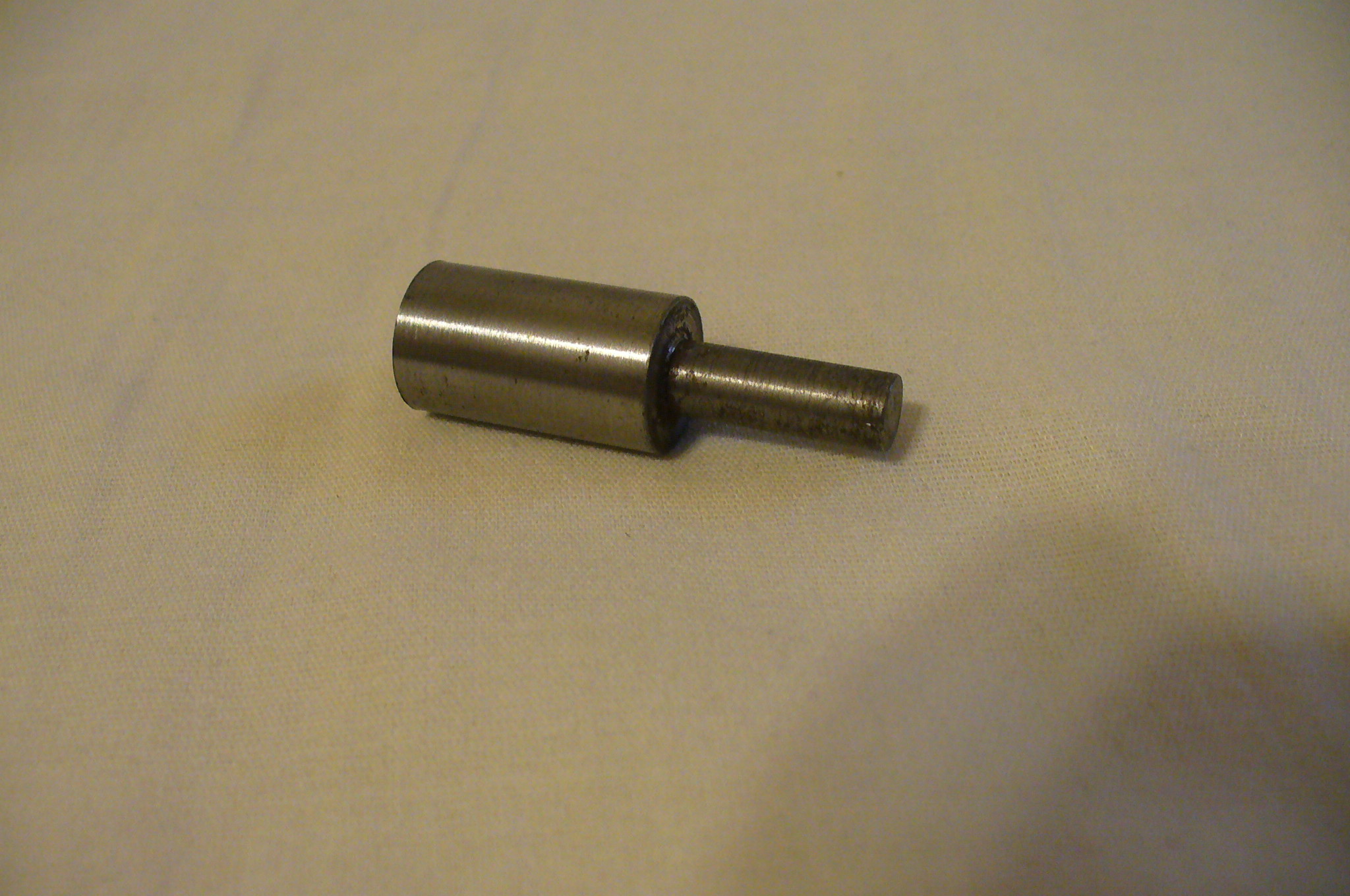

Understand the convenience of a drawing (I would ask the same), but perhaps a picture of a similar piece works:
Pretty much what I envisioned.
I think any of us with a lathe could knock out one, or several, for you in short order given your dimensions and tolerances. +-.1 mm tolerances is pretty easy to hit.
