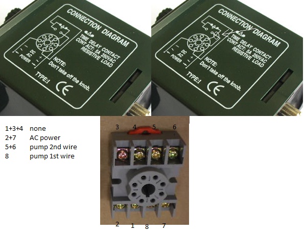

Pump is submersible aquarium pump 18W, 220V, 50 Hz
Thought of buying this model
Thank you for Octal relay socket I wanted to ask about that.
Is this correct considering AC current.
The relay contacts are rated 250V AC 5A Resistive. The pump draws ~ 0.1A AC when running. Peak current at start-up would be, perhaps, ~1A. However, the pump is an inductive load. We don't know the inductive load rating of the contacts. I would guess that 5A resistive rated contacts would cope with 1A inductive loads. It's a gamble.
A snubber across the contacts would be needed.
Edit: Do you really need an octal socket? From the pic it looks as though there are screw terminals as well as the octal plug.

He put both pics together (Timer and socket).
Wiring
Power does go to the timer power pins.
The contacts, though, are potential free.
If your in a country where the 220 service is grounded (This would not be the US), then you have to switch only the HOT side of the AC line.
8 and 6 are one of the potential free sets of the NO or Normally Open contacts. This set of contacts has to be in SERIES with the HOT lead of the pump.
@alec
Want to draw a wiring diagram for him?
As Alec said, it would be BEST to get another relay whose contacts are rated as Inductive or better yet add a solid state relay such as this one. **broken link removed**
The contacts of the timer would effectively have a very tiny load on them and the sold state relay would do the switching. It's important to fuse the solid state relay. If you fuse it for the pump (Normal blow fuse), about 10x pump steady state current and the SSR is rated MUCH higher than the pump, you probably don't have use a semiconductor I2t fuse. AT least that's been my experience.
With an extra relay, the wiring is getting even more complicated, but very reliable.

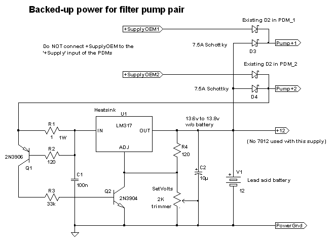

Here's a back-up arrangement based on Ronv's, using two of the new OEM supplies, 2 PDMs and two OEM controllers:
Edit: Superseded.

I bet you have the low current version of the 317 like I do so it won't simulate right at high current because the 317 current limits at 850 ma. in the small version vs. 1.5 amps for the TO 220.
Check me out though I could be wrong.

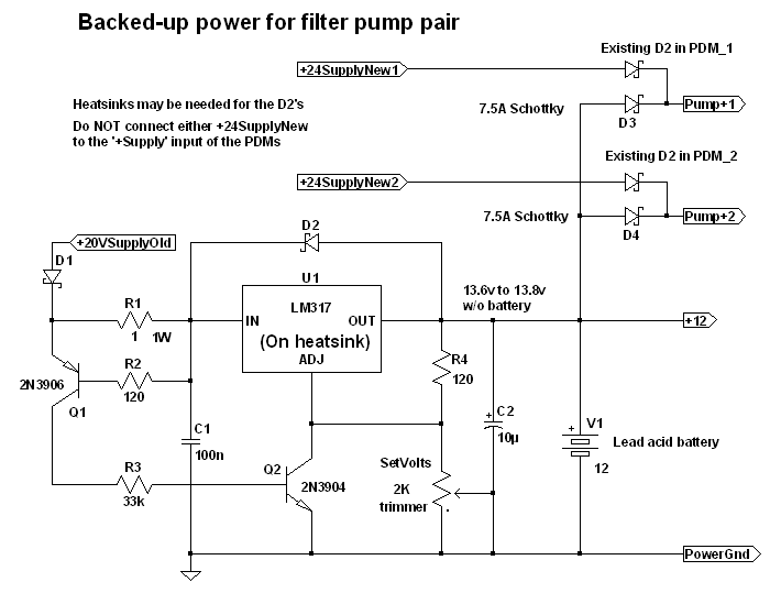

I wasn't aware there were two models and am not sure which one I've got. However, to avoid stressing the 317 or the new OEM power supply in the event that the battery voltage dropped as far as 10-11V the charge current in the circuit in post #1829 is limited to ~ 0.5A. I've since had second thoughts about using the new OEM supply to power both a pump and the charger, as Joe did mention that when powering a pump [only] the new supply gets 'warm'. So here's a revised circuit with the 'old' 20V supply powering the charger.

Here's the LM317 I have. Will it do? **broken link removed**
For plan B, I was going to use a pair of the new pumps for filtration. I wanted to use their power supplies, controllers and pumps set on low. Is there a way to splice a backup into their setup without needing another pair of PDMs? Backing up only one of the pumps would be fine.
Hi Eric, glad you're here-I like your byline.
Thanks all.
@Eric
Thanks for that link. I'll have a play.
@Joe
That LM317 should do nicely.
It's up to you whether you use PDMs as belt and braces, of course. If you don't want to, then just provide substitutes for the D2's in the PDMs and connect the posted circuit 'Pump+' outputs to the +24V inputs of the new OEM controllers.
