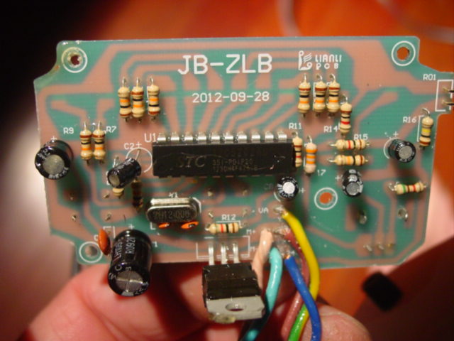

Do you think there is a ghost of a shadow of a chance that I could control this pump by cutting the 24 V wires coming from the pump and connecting them to the controllers we just built?
Possibly, but without knowing for sure what sort of control signal is applied to the 5V wire it's difficult to say. I would guess it's for speed control, perhaps using PWM. Do you have any more technical info? A datasheet? Can you use your DMM to measure the (average) voltage on that 5V wire? To avoid cutting the wires you may be able to put a pin carefully through the wire insulation to make a measuring point.
Edit: Another guess; the 5V wire could be an output (e.g. for a speed feedback signal or a locked-rotor detector) rather than a control input.
I kinda agree.
The 5V signal could be a speed signal, a PWM drive signal, locked rotor signal
, or an over temp sensor that's "pulled-up" within the controller. It would be nice to figure that out. I doubt it's power. "pulling up" means that in the controller the 5V is actually an input and connected to a resistor to +5 V.

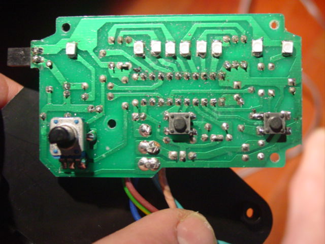

Why don't you post a pic of the front and back of the PCB and identity +24, GND and the 5B signal for starters?
One of us, maybe me, could actually take a look at it. Hopefully the wiring uses an easy to get plug.
The yellow and green wire is 5V, brown 24V, and blue ground.
With the pump on hi, the green wire showed 5V, on lo the green wire showed 2.4V. On pulse modes, V jumped around from 4.4 to 0.
Brown wire showed 24.1V on hi and 24.3 on lo.
In the pic, what I think is a Vreg has L7805CV printed on it.
The IC is
12C5202AD
351-PDIP20
1230OH4F426.B

Nice pics, Joe. Those voltages are consistent with an input control. On the other hand they are also consistent with a speed output signal.
Could you repeat the 5V line measurement, but this time with the +ve probe of the DMM connected via a cap (~100nF) to the 5V line? That would tell us if the signal is DC or pulsed (PWM).
Is the control pot wiper the same voltage as the 5V line?
Google says the 12C5202AD is a STC microcontroller, available in a variety of packages (including PDIP20). Couldn't find a datasheet for it:(
Edit:
I was expecting to see a beefy FET in the pics. In its absence I'm inferring the micro isn't directly switching the pump power to control speed; rather, it presumably provides a speed command to the pump and the pump has internal electronics which control the power.

I could see some electronics buried in the epoxy at the back of the pump.
The button in the middle changes mode. We have hi, lo, pulse, a rolling wave, another kinda rolling wave and random. The button on the left is for a 10 minute pump stop. There's also a way to lock the setting. Both buttons are tactile switches.

What's the part in the lower right-hand corner of the top of the PCB that looks like it's soldered on the bottom layer?

I'll have to point out the component the hard way. It's a black one, like a Bidirectional LED or transistor. It has 3 leads.
Component side: The side with the IC; Solder side: the other side. This is on the "solder side"

Do you mean the black tab that extends out from the board? That is where a light sensor plugs in. The idea is to slow the pump down when it's dark. It does not work well. Even if it did, I'm not sure I'd want it. With the light sensor removed, you don't get the night/darkness slowdown. I removed it from the getgo. Other than that, the only components on the solder side are 2 tactile switches, the pot and nine tiny LEDs.
