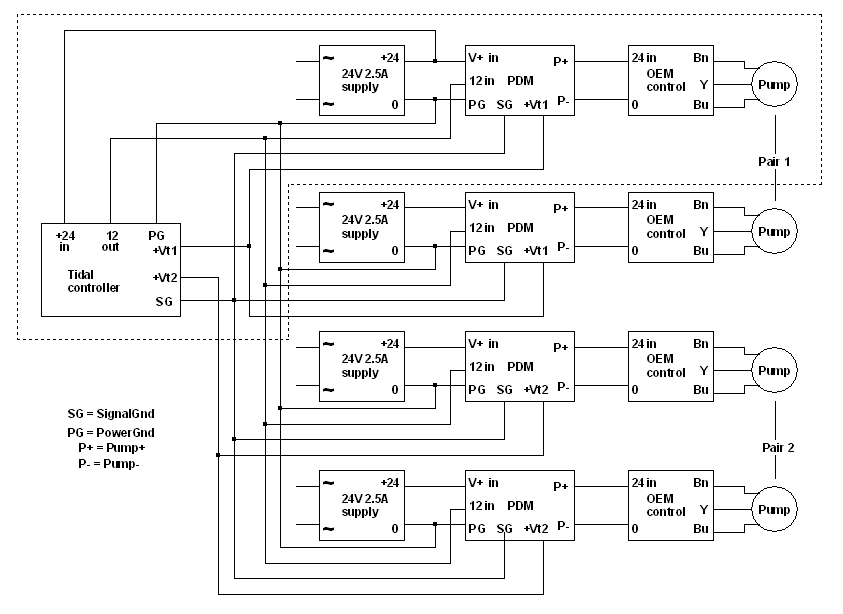

If the connections were as in post #1796 then the OEM controller looks after the 5V line; Joe would merely set the controller for permanent full speed (which I presume is one controller setting?)
I envisage the new setup as:
OEM 24V 2.5A supply >> wave (or tide) timer >> PDM >> OEM controller >> pump
Full speed is one of the settings, and that will be used for wave but a sort of rolling wave is another setting that I think would be outstanding for tide.
I like that setup a lot-a whole lot! I could wire six GFI receptacles in parallel and have lots of redundancy. We’d have to feed our controllers with a separate signal ground and 24V to get down to 12V, then provide a power ground for each PDM-is that right?
With a PWM signal on the 5V line I would have expected a higher reading than 0.1, even on the 200AC range. So that low reading reinforces the earlier indication that there is just a DC level on that line. Can't be certain. Interesting, though. Pity we can't check on a scope, or at least get hold of a pinout of the micro IC.
However, the nature of the signal won't matter if we let the new OEM controller do its thing and operate the pump.
One tidal controller presumably will still be doing the timing for 4 pumps? If so, the grounds of the 4 OEM 24V supplies will need to be commoned with the PDM PowerGnd lines as a power ground, and an arbitrary one of those supplies would power the tide controller.
Here's how I see it:
I suggest you initially assemble just the units in the dotted box, using your beat-up PDM and shiny new 2.5A power supply, and check nothing in the PDM gets too hot. I'm expecting Rsense to get warmer than it did for the old pump, likewise the FET. Measure the voltage across Rsense for hi and lo settings of the OEM control.

Combining their controller with ours is a clever and cool way to drive this pump. The redundancy from six separate power supplies is another layer of safety. There are some nice features on the OEM controller I can take advantage of. What their controller lacks, ours has-multiple pump synchronization and safety features. Pump synchronization really is a force multiplier for shifting water. I love it! Thank you!
I have quite the honeydo list to knock out today, I’m gonna try real hard to get this wired up by tomorrow evening after work. I’ll start off with the OEM controller in lo and babysit it for awhile.

Major score! This is a sweet running system. It's been toggling on tide for the last 10 minutes and nothing is even remotely warm, not even the power supply.:):D;):D! That's with the OEM controller in the low setting. After a little while, I'll set it at high and watch it like a hawk for awhile.
On low, I got 0.10-0.11V across Rsense. On high I got 0.30-0.31V.
As soon as I get another pump, we'll see about the flick. What a stroke of genius to blend the controllers! Thank you Alec. Thanks all.
I better get to work or I'll be in some deep trouble.
Edit-The new setup has been running on high for 45 minutes and the only warmth is a little at the power supply and D2 is warm. I don't think it's hot enough to need a heat sink.
I did notice a slight delay when the pump starts back up, less than 1/2 sec. The OEM controller's light blinks to "sensor" then back to high. Like you said Alec, we'll see what that does to the flick. Also have to see how wave function is affected. It is looking good.
Sounds very promising. Those figures indicate the new pump draws ~1.4A on hi. Compare that with ~1.1A for the old pump and you can see why you shift more water! So Rsense and the FET can stay as is. You can improvise a bit of a heatsink for D2 if you like, but if you can keep your finger on it for 10 sec then it isn't too hot and doesn't need one.
