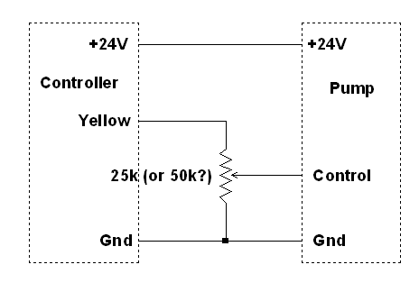

The wiper won't be connected to either end leg. This time the pot is being used as a potential divider rather than a variable resistor. Like this:

The yellow wire shows 5V when the controller is in high and 2.4V in low.
Should I connect one leg of the trimmer to the yellow wire and the other leg to ground? If so, where does the wiper go?
Or should I connect one leg of the trimmer to 24V, the other leg to ground and the wiper to the yellow wire?:confused:
Did you check the pic in post #1861?
Yes, I printed it. It shows a leg going to the yellow wire (which I thought was the control) a leg to groung and the wiper going to control. The pump has three wires going to it-24V, ground and the yellow wire that is 5V when pump is in high and 2.4V when pump is in low. I am sorry, I am unsure of this hookup.
Yes, the yellow wire is the original control wire from the controller. The wire labelled 'control' is your new control wire input to the pump. Think of it as 'new yellow' :).
Now I'm really confused.
One leg of the trimmer gets connected to the original yellow wire. The yellow wire that is either 5V or 2.4V depending on if pump is in high or low.
One leg gets connected to ground.
It sounds like I need to add a fourth wire between the controller and pump?? I am still having a hard time figuring out what exactly the wiper gets connected to.

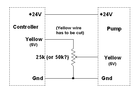

Is this clearer?
Edit: I've shown the yellow wire as being cut, assuming the pot would be an add-on unit, but if the pot and its connections are going to be built into the controller then you would just detach the yellow wire end from the controller output socket pin and connect it instead to the pot top leg. You would then connect the pot wiper to that pin. The bottom leg of the pot is grounded.
I hooked up a 25K trimmer and it does work, but at the cost of a little top end speed. With the trimmer set for max speed, there were 4.77V at the control line. (versus 5V) The only reason I thought to check was I could tell by listening the pump was not going as fast. For now, I think I'll put the pump back together the way it was. If it turns out that I need to slow things down sometimes, maybe a SPDT could be installed to switch back and forth between using the trimmer and bypassing the trimmer. The ability to slow down each and every mode is a big plus-thanks for another good plan-sorry I had such a hard time wrapping my head around it.

Theoretically, if the pump control input had an infinite resistance, the 25k pot would drop the 5V down to 4.8V; so your measured 4.77V suggests the input resistance is pretty high (~300k, if the trimmer is accurately 25k). That's good.
You probably have a spare 50k trimmer (50k is used in your built wave timer module). If so, try that. The 5V should then drop to nearly 4.9V, giving you almost the original max speed.

With a 25K trimmer, wiper hooked up, I got from 4.77V to 1.32V. Wiper disconnected and trimmer in same low position, 1.36V. Trimmer on high, wiper disconnected, 4.8V.
50K pot wiper hooked up, 4.87V-1.04V. Wiper disconnected, 4.9V-1.08V.
Those figures are all consistent with the trimmer values being 'what it says on the tin' and the pump input resistance being ~300k. Was there a noticeable speed increase going from 4.77V to 4.87V? Would the 4.87V speed be ok, for leaving the 50k trimmer in place permanently? Or would you still want the SPDT switch to bypass it?
Yeah, I could tell the pump was working harder at 4.87V. IDK how much below top speed this is, I'll have to make a comparison. I'd imagine a SPDT will be in order. I'm pretty sure I'll need heavier duty SPDT switches.
