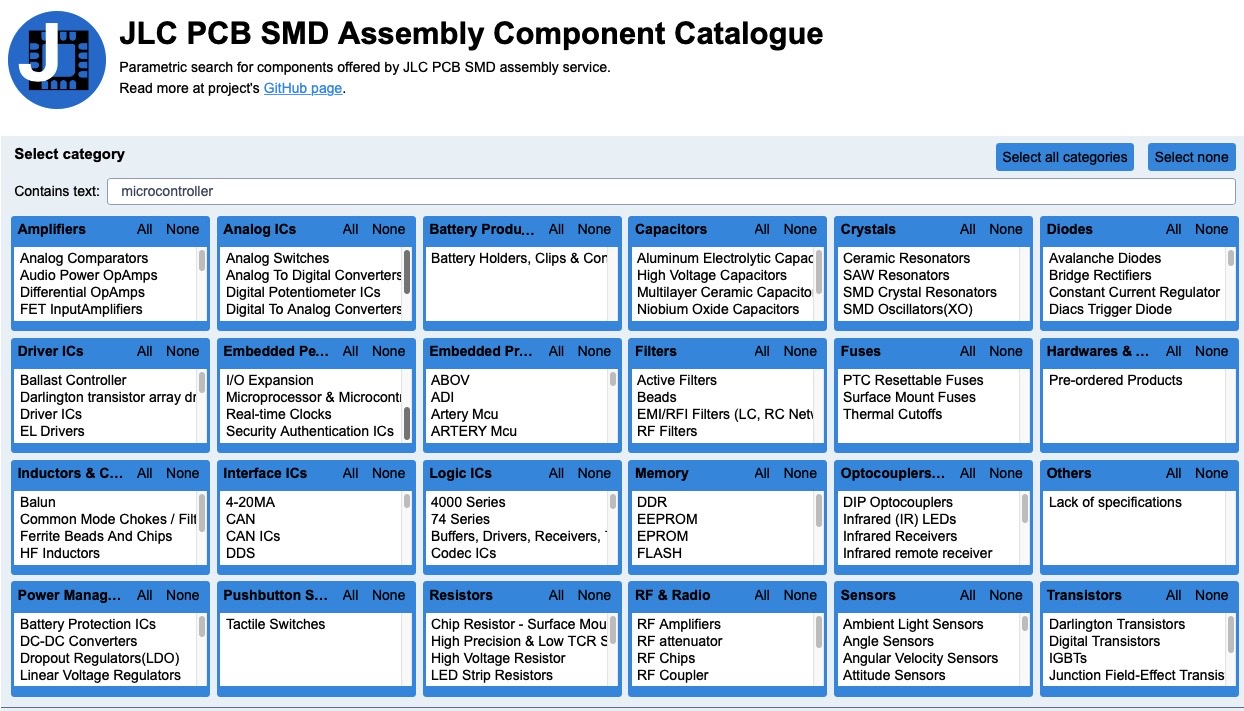

Also, this utility via Hack-A-Day lets you do a parametric parts search for parts in the JLC assembly library (parts they will assemble for you).
