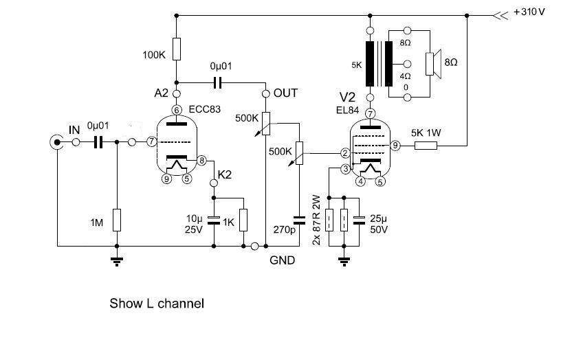

help understanding amplifier schematic
If you're using the original circuit you posted, then (like we told you) it's rubbish.
Add the decoupling components as shown in the two diagrams I posted, R5, R6, C1A and C1B in the second of the diagrams - without them you're just feeding hum from the PSU directly to the grids of the valves.
i wouldn't say it's rubbish... it's just a basic amplifier circuit...
what i need is to get rid the noise and i'm happy with it.
can you tell me how i'm going to implement your above advice? because the only thing i managed to do is to ground my signal.

Do you have a light dimmer in use? Your audio file sounds like a buzz to me. Not 50 or 100 hertz...unless severe clipping is causing me to hear only harmonics.
Pull the first tube out of the circuit and see if all the noise goes away, please.
Is the metal chassis connected to power supply minus (like it should be)?

No, it's rubbish :D
It has no feedback, so it's even higher distortion and poorer frequency response than other valve amps, but required parts are left out so it feeds hum to the grids.

Look at the circuits I posted earlier, and the decoupling components between the HT rail and the triode anodes - these are absolutely essential.
yes... ofc without it i'm getting some extra noises.. :D
nigel i did that and i only manage to ground my input signal....
i did it as is in the circuit... 10K resistors in series with 22uF/400V decoupling capacitors and then the resistors of my circuit.
probably i did wrong with the values of the first resistors?!

Like I keep saying, you're feeding the PSU hum directly into the grids, if you remove the triode (which is always a good thing to do in valve circuits) the hum is still feeding directly through the anode load of the triode in to the grid of the EL84.
I don't know what you mean?, try posting the circuit as you modified it.
Resistor values make VERY little difference.

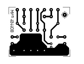

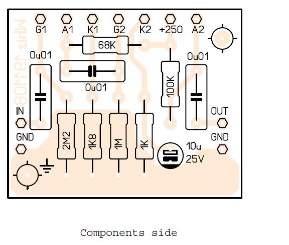

here's the pcb and the component side.... perhaps there's also an error somewhere there and i couldn't see it?

You did something wrong - you need a resistor and capacitor to decouple the power to the triode preamps - as shown in both the diagrams I posted, and in the 6SN7 one. Without it you're going to get massive hum.
Just as a matter of interest, why did you make a PCB for it? - it's not a particularly useful method for a valve amp, especially a home made one.

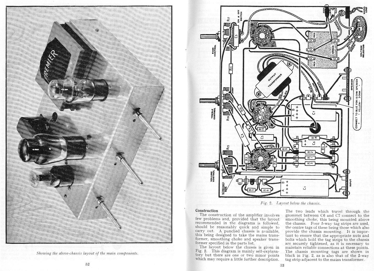

Here's the layout details for the second circuit I posted, that used a double triode

i didn't wanted any pcbs i wanted it to be with the old fashioned way... but the problem with the hum made me to use a pcb.

P.S the schematic especially the layout you posted are very useful to me
because i can take ideas for the orientation of the components without using a pcb and in case one day i want to move on to a different design...but still you haven't told me if i can easily substitute the tubes of your designs with the tubes i already have or if it needs many modifications.
I fail to see any connection between lowering hum and making a PCB? - in fact the total opposite is more likely, you're increasing the length of leads in the chassis, and making it more likely to suffer from hum pickup.
The slassic way of making avalve amp was basically wiring components directly from the valve bases to each other, using small tag strips for any connections not on a valve. Later commercial designs often used tag boards, which (like a PCB) allow the board to be assembled on the production line, then fitted in the chassis later.
The old TV manufacturer KB actually made hand wired colour TV sets, no PCB's in them at all.
Valves are really simple and crude devices, you can pretty well switch and change as much as you like - a simple amplifier like this could be thrown together in a couple of hours, if you had the valves and the transformers. You could tweak the values afterwards if required.
The diagrams are taken from a book I bought years ago at a second hand bookshop, it originally cost four shillings and sixpence (now that will confuse many readers! - not Eric though :D ).

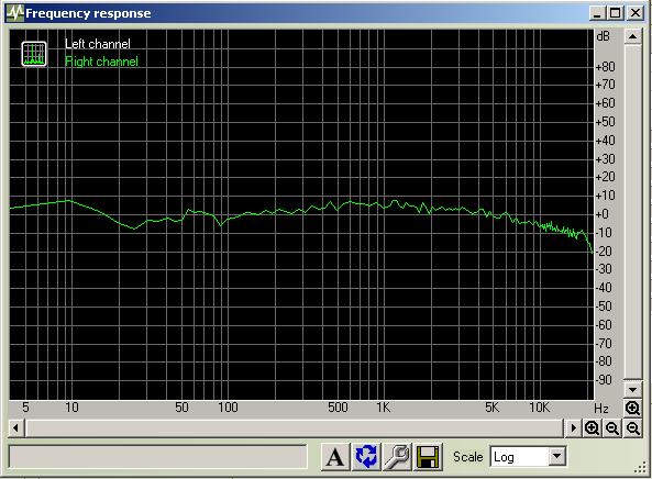

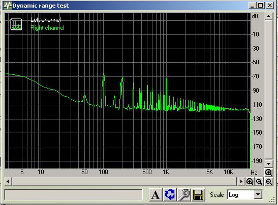

ok! so heres what...
my first tube amplifier is almost ready!! :D
I managed to suppress the noise a bit and now it works better than ever!
but i still have 1-2 things that i want to talk about and find a solution
but these later because now i have something to show you all!

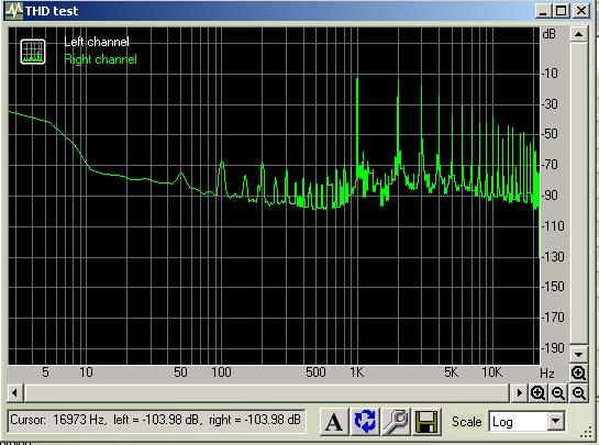

it might be pointless but out of curiocity i got this amp analysed! :D here's the results and also some photos.
Noise level dBA: -75.9
Dynamic Range dBA: 59.5
Total Harmonic Distortion THD: 59.912%
i think the numbers don't go so well, but to the ear is kinda different...
any comments? :D

The frequency response and distortion are horrible. Like the sound of a TV about 53 years ago. Some people like that lack of performance.

The distortion figure will include the hum as well, did you fit the decoupling components as suggested? - they should pretty well get rid of it all, not just partially.
However, distortion figures for a non-feedback valve amp are going to be very high anyway.
well no.. i did some other things first... but i'm about to do it.

So you still have masses of hum, this will be added to the distortion reading (because it's distortion AND noise).

and with very small screen resistors!
Like I said, bigger cathode resistor (I'm presuming you've got no positive voltage on the grid?).
i'll fix it as soon as i correct the new problem.
Probably too much current, increase the value of the cathode resistor to increase the grid bias on it.?).
increasing the cathode resistor i'm also increasing anode voltage... :confused:
what do you mean with that?

here's an updated schematic which i'm currently using and works only with the 1/2 of the ECC83
That's still feeding PSU hum directly to the grid of the pentode, we've told you repeatedly - ADD DECOUPLING TO THE TRIODE SUPPLY - like all the designs in the world, apart from the totally useless one you're copying :p
so the changes will be...
for the ECC83 one more resistor 47K before the 100K and between them a 22uF/400V decoupling capacitor.
for the EL84 a 2k2 resistor for the screen which i think it's the recomended value for the EL84... and a bigger value for the cathode probably 150ohm/4W
