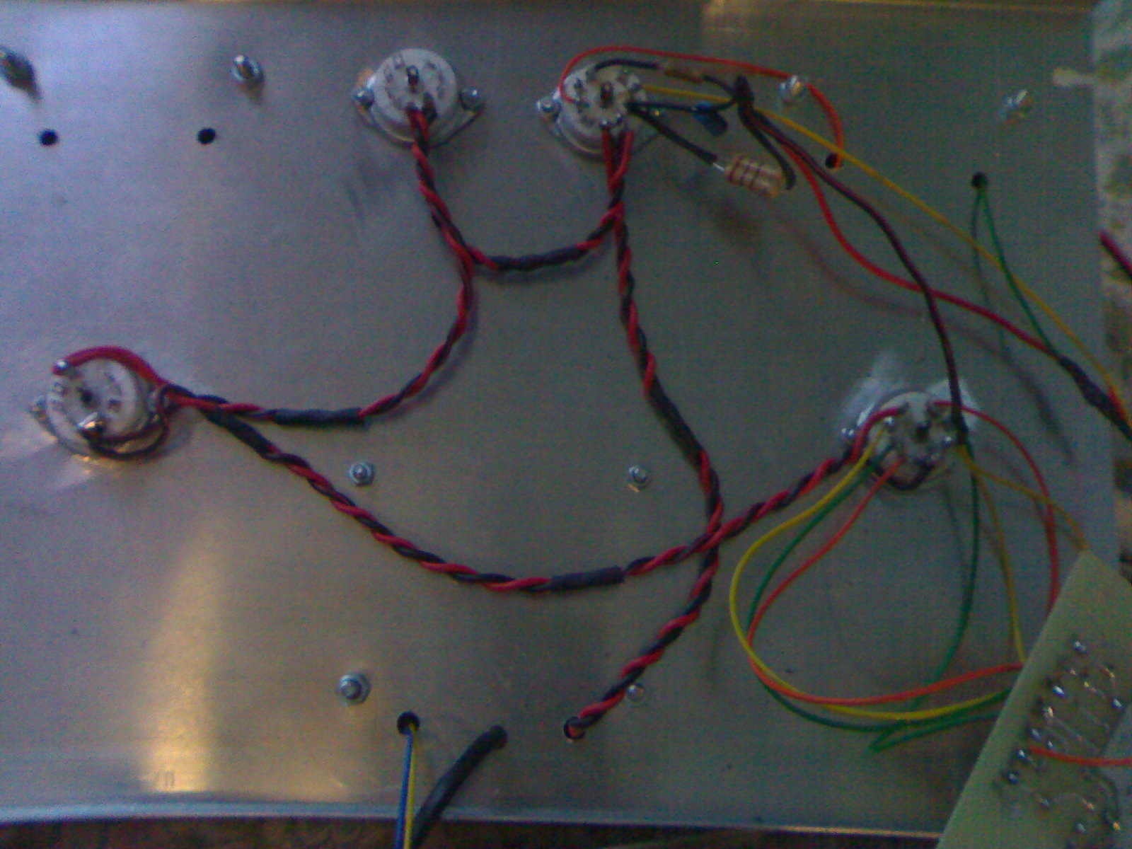

here's photo underneath
help!

You have great long wires connected to the right hand valve base, routed right next to the heater wires - wires need to be as short as possible and away from heater connections.
The higher the input impedance, the more chance of hum pickup - for a start short the input socket out and see if it's internal or coming in the socket.
ok i did shorted the input... and wow..... it's like MEGA BASS!
the hum just changed frequency. :(
