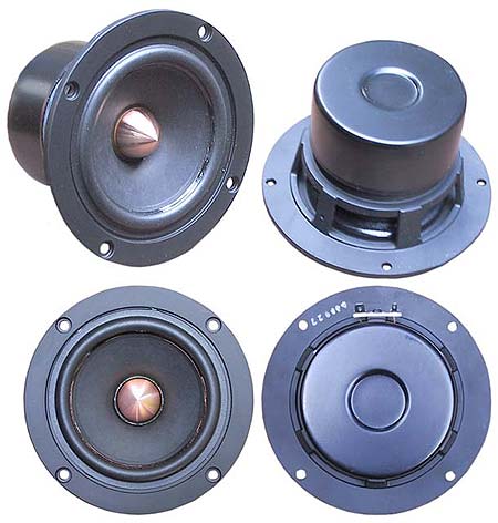

The 3" drivers in my pc speakers have the biggest magnets I have seen on little speakers. They are driven with 3.5W RMS each and are pretty loud with bass flat down to about 100Hz.
The drivers look like this one:
Interesting speakers. What is the model number and manufacturer of the speaker system, please? Or is it home brew?
