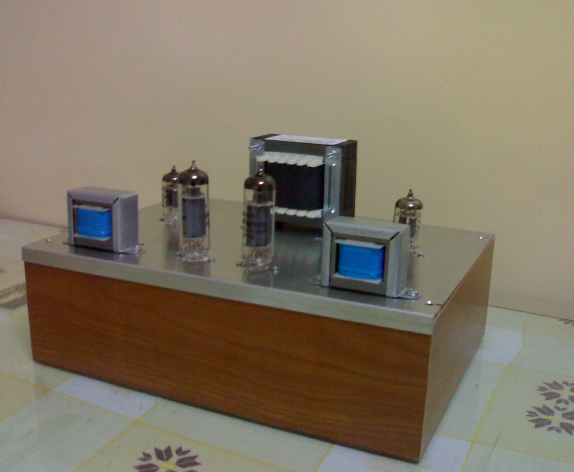

the amp...
not yet finished
It takes you back! :D
i'm doing my best...
well...maybe i could a little better because i think it wasn't very good idea
having the tubes kinda near to the transformers, though if i have problems i
think i can easily isolate them and still look nice because i'm going to cover all the upper part with a **broken link removed** painted black so the only thing you can see is the light comming from the tubes and not the isolation of the transformers! :D

The output transformers appear pretty small so maybe they won't pass the hum frequency.

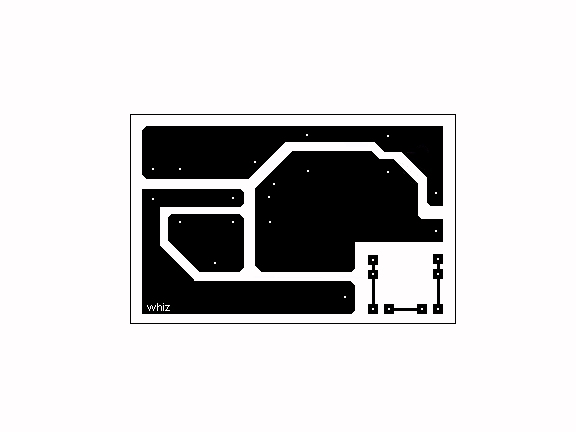

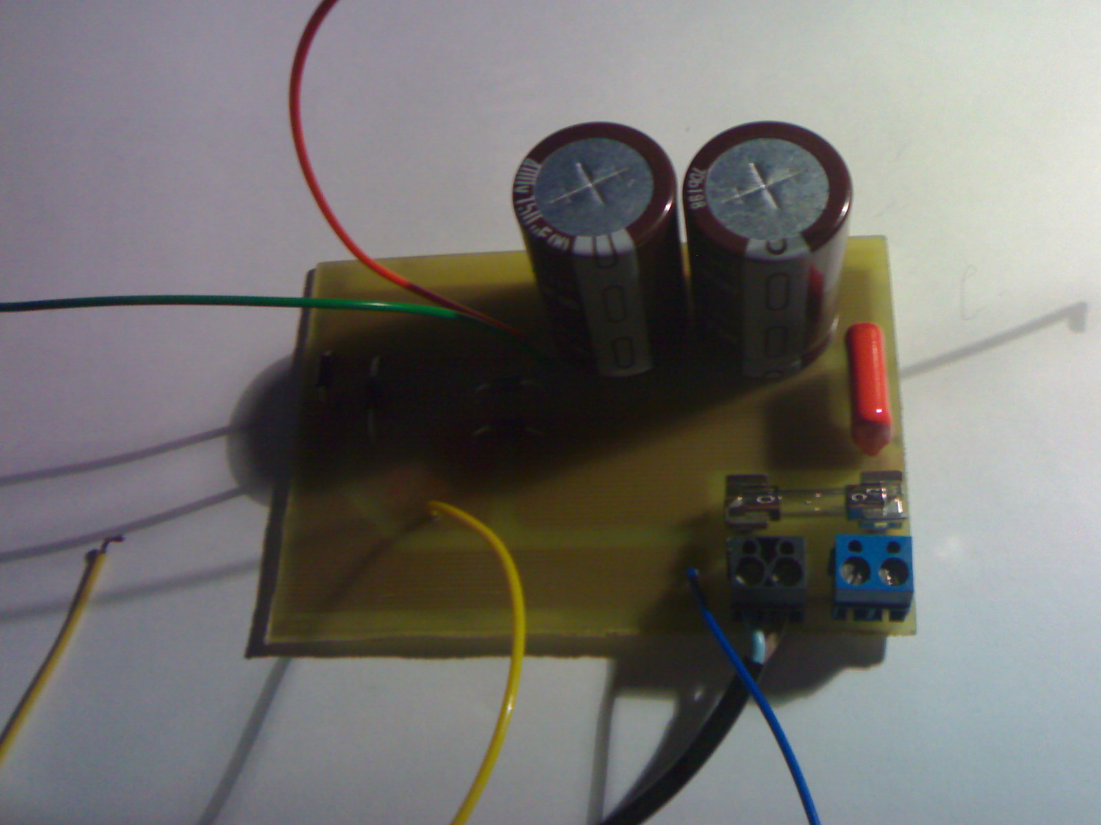

I did a simple power supply pcb to rectify the 220VAC of the transformer (which apparently gives 230VAC and not 220VAC as it says :rolleyes::rolleyes:) and i'm facing a problem!!! it keeps blowing the fuse to the primary! :mad:
the transformer is fine! the circuit is so simple and everything looks fine to me, just a rectification and 3 capacitors and i don't get what's wrong, i haven't placed any load to the output....
What is the fuse values? Current rating and is it fast or slow?
Your amp looks very nice. I would not cover it.
(that almost sounds dirty)
Thanks flat5! :)

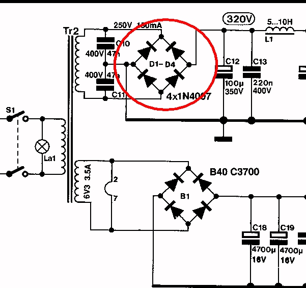

ok the problem solved... i had a rectification bridge schematic near me so i can see the orientation of the diodes to avoid any mistake...but guess what!!!? :D the schematic had the bridge WRONG!
ok here's the schematic caused the problem and here's the power supply pcb i designed...
it's the first time i did my own pcb design and i felt a bit unsafe with high voltage that's why i did so big rails with so much space between them..probably it's good for 10A or more! :D:D
the wires are from teflon...because last time the wire where green cable is
was touching the nearby diode and almost got burned.

I think you should use new diodes.
They have been subjected to heavy overload.
They don't cost much.
