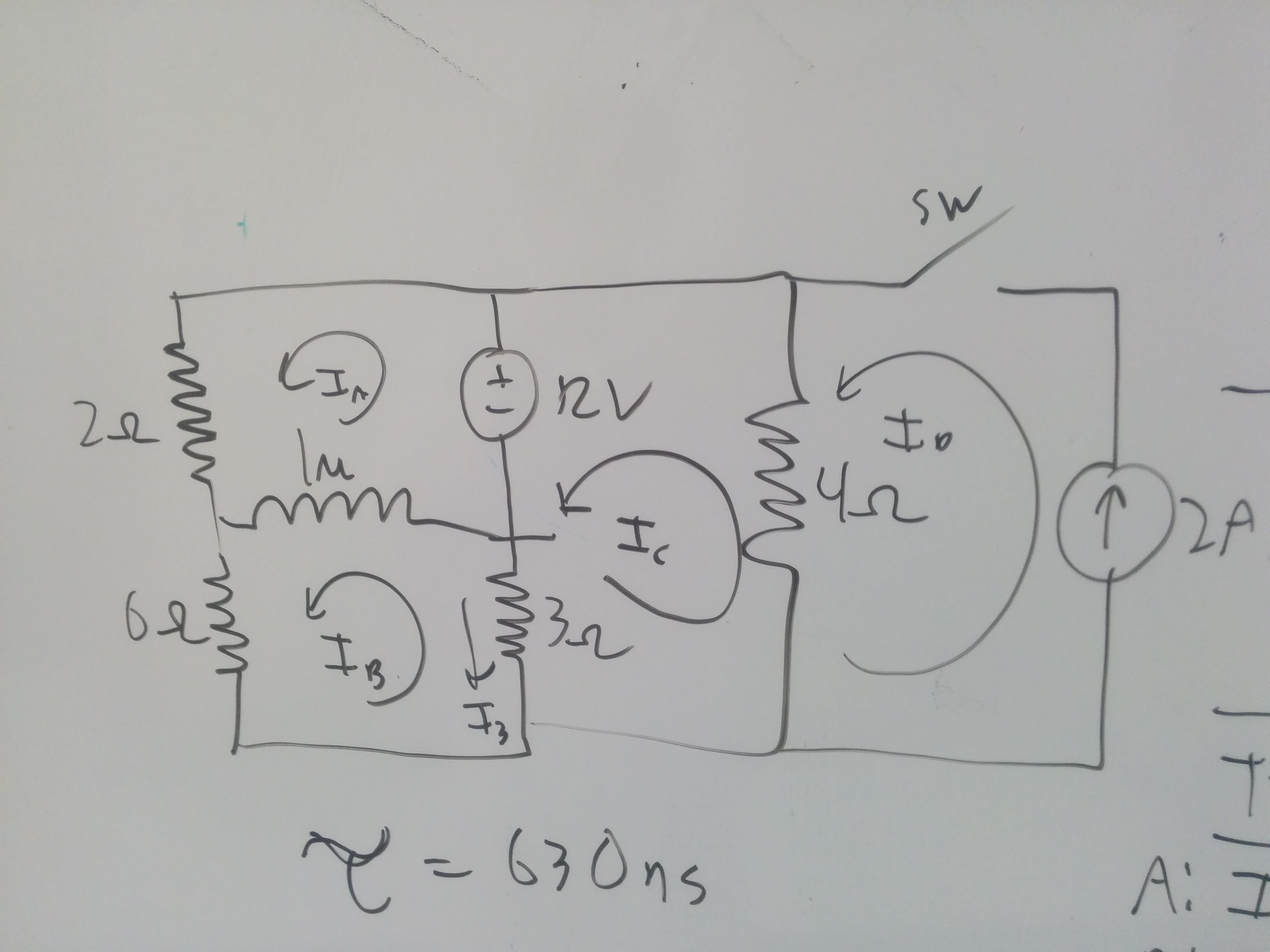

Help on finding Thevenin Resistance and Current across resistor for RL Circuit?
So, ultimately, depending on the current loop orientation I define, that dictates how the polarity changes in response (with respect to the voltage source). Which, in other words, determines whether the voltage term is either positive (voltage drop), or negative (voltage rise). I'm so used to having the voltage term isolated from the rest of the other terms when doing mesh-current analysis that I've forgotten how it's interpreted when included with the other terms (or simply having the loop equation be 0 = voltage term + ....). And so with that, the way current runs through resistors and sources are different that care has to be taken when arranging them correctly. Sounds like I need to take some time tonight to review passive sign orientation with sources and mesh-current analysis, since both play a role on how current runs through inductors and capacitors as well.
Yeah. You can define whatever damn current loop directions you want. As long as you stay consistent with the currents and voltage drops polarities according to your convention it when tracing your current loop in your chosen direction to write out the loop equations. You can pre-separate the sources to one side if you really want to, but you need to be aware of how it works because what happens if you get a circuit where a single current loop has two sources in it that may or may not oppose each other? Then you're screwed. Or even worse, if they're dependent sources.

Loops X is indeed zero because the only current unique to loop X is flowing through R1, but there's a short across R1 so no current flows through R1, therefore Ix = 0. All the currents in the bottom and right side of that loop are accounted for in Iz and Iy.

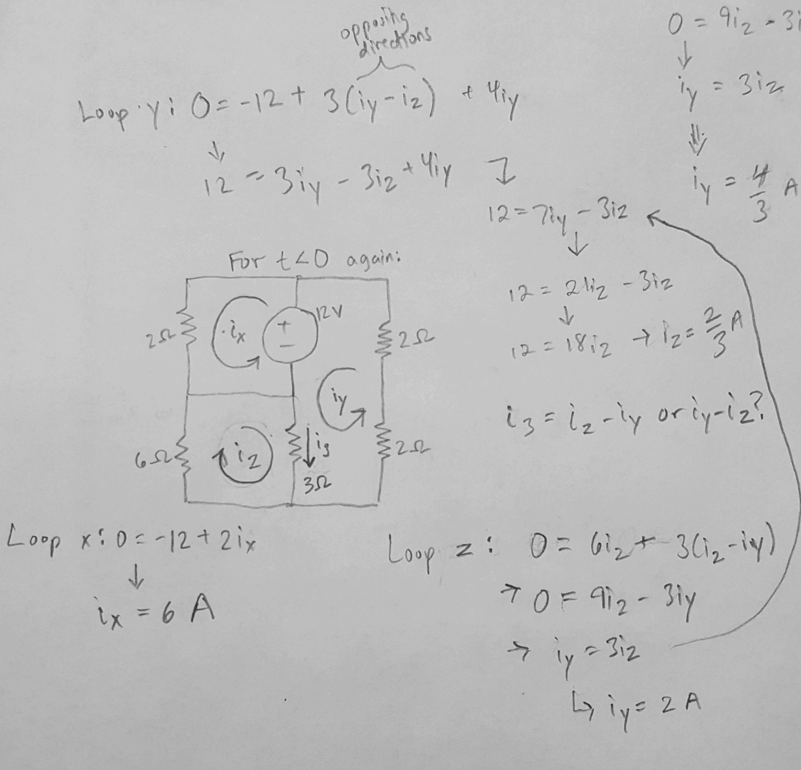

Loop Z: Iz should be 3(Iz - Iy). You drew Iz CCW, so if you follow the loop in that direction to write the equations, Iz is positive (obviously), but in R3 Iy is flowing in the opposite direction that you are tracing the loop in, so Iy must be negative.
Loop Y is 0 = -8V + 4iy + 3(iy-iz).
The reasons for this are explained immediately above and in my last post about sources. These are the most confusing parts of basic mesh analsysis. If you can understand why these polarities are the way they are, you are good. You can define the current loops in any mix of direction you want (I just draw them all in the same direction because to me it removes variability).
What matters is to stick to the conventions you defined when writing your loop equations. If the current loop direction you defined is correct for the voltage drop of whatever component you come across, it gets a + polarity. If it's wrong (i.e. it's a source but the current direction treats it as a load), then it gets a negative sign. You can do this because, unless you are solving for a mystery source, you know ahead of time how it should behave. If you are solving for a mystery source then you don't know this which is very similar to encountering a load in your trace. You don't really know what's happening in the RLC loads. In either case, you do the same thing: just assume the voltage drop is in the direction you are tracing and if the result ends up being positive you know your assumption was right. If you were wrong, the result is negative.
If an adjacent current loop merges with the current loop you are tracing in the same direction, it gets a + polarity. If not, it gets a - polarity.
Mesh analysis is all about defining/assuming a convention and blindly keeping track of it as you write your loop equations. If it's positive, your assumption was right. If it's negative, your assumption was wrong.

Your drawing takes precedence. If you defined Iz and Iy as going in opposite directions through R3, then the current through R3 will be I3 = Iz - Iy or Iy - Iz, depending on which loop equation you were looking at. It all hinges on your drawing.
In that case, I said I3 = Iz + Iy because that's how you defined current directions in that drawing. If you defined them differently, it would change because your calculated Iz and Iy would change based on how you drew them.

Wait, so I'm confused about this matter. I do understand the part you mention about the opposing directions that current loops can take, which is what I decided to do for the t<0 case (the one with the voltage source intact only). I set the iz current loop to go CW, and iy in the CCW, so that both are in opposite directions and that I can follow their own respective conventions and polarities. Upon redoing the calculations again, it does turn out that both iz and iy are both positive, along with ix being positive as well. However, what I'm a bit lost on is what you mention about the "positive result". Were you stating with respect to i3 being positive? Or iz and iy?
It's obscured here because the current loops are defined to be in the same direction and you calculated they were both positive. But it matters when currents are opposite or if you calculated some of them to be negative.
So let's say one loop was CW and the other was CCW:
In visual form: Draw an arrow beside R3 representing I3. Draw it completely backwards if you want. All loop currents that have the same direction have a positive operator, all opposite have a negative operator in front. Then substitute in the calculated loop currents WITH their calculated polarity. You basically assumed a direction for I3 when you do this. If I3 is positive you assumed right. If not you assumed wrong. No different than the rest.
You form the I3 equation with signs and operators for the variables that assume direction, then plug in loop currents WITH the calculated polarity on top of that.
Long form:
If you go I3 = Iy - Iz, you are implicitly assuming that I3 is in the same direction as Iy as drawn, not as calculated.
Then if you calculated Iy to be negative and Iz positive it means your assumption of Iy's direction was wrong, but let's ignore that and push ahead...
If |Iy| > |Iz| then plugging it in gets a negative I3 which means the direction of I3 is opposite of Iy as drawn, not as calculated (or same as Iz as drawn). Same thing happens if Iy is calculated positive and Iz is calculated positive but Iy < Iz.
If you go I3 = Iy + Iz, you are implicitly assuming that I3 is in the same direction as Iy.
If you go I3 = Iz + Iy, you are implicitly assuming that I3 is in the same direction as Iz.
If the calculated I3 < 0 then that means your assumption, whatever it was, was wrong.

...you don't need to recalculate or re-draw if your assumption was wrong. Just continue working with all the values as is. This is probably best anyways since it will just cause confusion in your conventions if you make correct direction assumptions here and there. If you were consistent it should carry all the way through to the end. That's kind of why you treat it mechanically and blindly like a computer. The polarity of your calculated voltages and currents will work together to cancel out any wrong assumptions you made in their direction on your drawing. Whenever you combine the two together, then you know the actual direction but you only need to do this when you display the final result so the person reading it has an easier time.
You have to make a distinction between the polarity as drawn (direction of the currents that you assumed) from the polarity of the calculated value of the current (the actual polarity of the currents relative to your assumption). The calculated value and polarity plug into the variable and its polarity which represents the assumption of direction that you made. Only together can they tell you the actual direction (relative to what you have drawn).
If you drew I3 to point down on the drawing, Iy CW and Iz CW, then your equation would be
I3 = Iz - Iy
Drawing I3 like this and writing out this equation is the same as saying:
"I assume I3 is in the same direction as Iz and opposite direction of Iy, as drawn (not in actuality)"
"I assume I3 is in the same direction as Iz, assuming that my direction assumption for Iz was correct."
"I hereby define down as the positive direction for I3 which just so happens to be the same definition that I have given Iz, both of which are the opposite definition given to Iy, which is defined as up being positive."
But then you might end up calculating that Iz = 3A, Iy = -1A.
That means that your assumption for Iz's direction was right, but your assumption for Iy was wrong. If you need to display Iy at this point you can draw a little schematic with the arrow in the proper direction for Iy and use +3A as the value. But if you need to use Iy for another calculation, then don't use the corrected value. Continue using what you originally defined and calculated with your conventions:
I3 = Iz - Iy = (3A) - (-1A) = 4A.
Since it is positive, that means your assumption of I3 (the down arrow) was correct
But if you got Iz = -1A and Iz = 3A
Then I3 = Iz - Iy = (-1A) - (3A) = -4A
Since I3 is negative, that means your down arrow for I3 was wrong and it actually flows in the opposite direction (up).
It's super mindless once you grasp it. You just blindly work through the math and stay consistent.
Yes, but you would have known your assumption for Iz was wrong the second it popped out of the calculation as a negative number. if you need to display it as an answer then you can correct the direction at that point if required, but if you need to continue using the value in other calcuations in the mesh analysis then...
...you don't need to recalculate or re-draw if your assumption was wrong. Just continue working with all the values as is it by reversing direction in the drawing if your calculated current was negative (or voltage for that matter). This is probably best anyways since it will just cause confusion in your conventions if you make correct direction assumptions here and there. If you were consistent it should carry all the way through to the end. That's kind of why you treat it mechanically and blindly like a computer. Only whenever you actually require displaying a result do you need to correct for the bad assumption just so it makes sense to the person reading it.

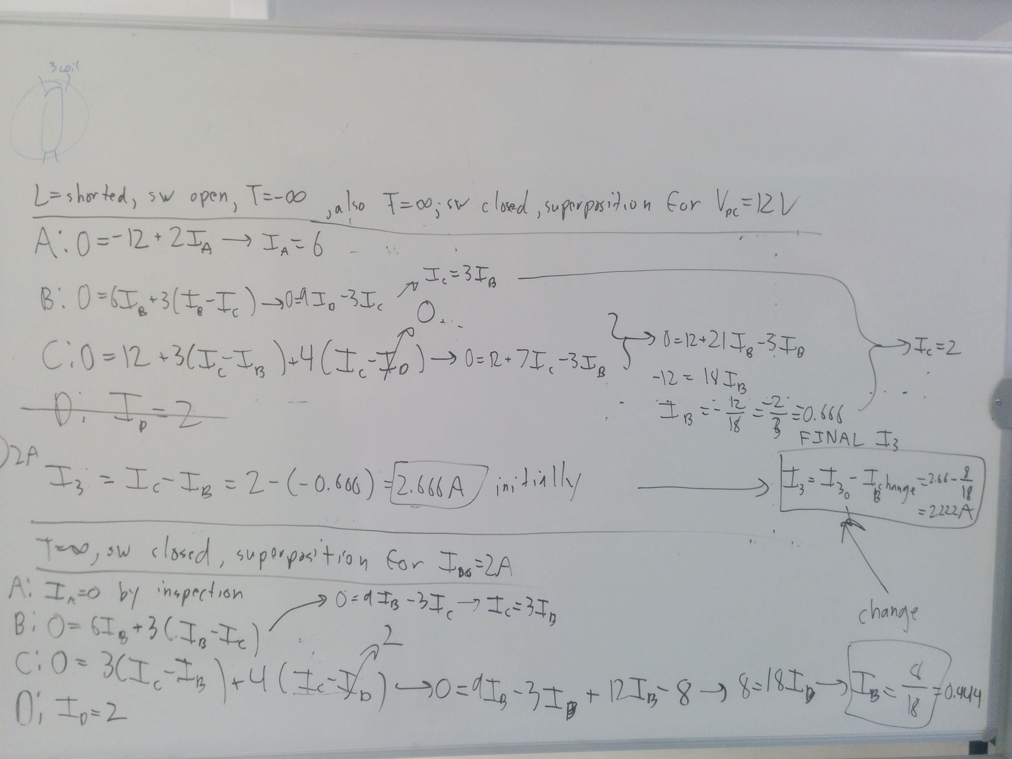

Upon inserting these values into my general equation for the i3(t), I ended up with:
\[ i_3(t)\;=\;1.78\;+\;0.89\ast e^{-\frac t{0.0000006296}} \]
However, that tau value is very strange, as far as the RL circuit is concerned. Despite knowing that the time constant is L/R (or Req, based on the equivalent resistance as 1.59 ohms), did I perhaps incorrectly calculate the time constant for the circuit?
Found a mistake in my last post and corrected it.
It's possible that the method I suggested to calculate tau is not valid. I don't see why it wouldn't be though. We might have to run this through a circuit simulator to check

The time constant is for the current in the inductor so that's what you have to look at, not I3. I observed it took 310ns to complete 37% of the change between the two steady states. That might mean that you can't stitch things together quite the way you want to for I3 since that is for the resistor, but tau is for the inductor...
But tau was calculated to be 630ns which still doesn't match...

But actually, now that you mentioned the 630ns, that was associated with the equivalent resistance we found earlier, I think I may have realized a past error made in calculating Req. Usually superposition is used to find equivalent resistance for t = infinity (switch closes) right? I want to believe that we did find that correctly (based on posts #1 - #3), but the immensely small number of tau kind of stems some doubt?
THe time constant is correct. Me using 37% of the change as the measuring point in my previous post was wrong. I was supposed to use 63.7% of the change. I get 650ns in the simulation which is close enough the calculated 630ns considering I'm basically eyeballing the graph with cursors.
I'll try the mesh analysis later this week.
I think the concept is also right. Here's my math but I goofed a bit at the end of the first half
You can see in my work that I have that before the switch closes, I3 = Ic - Ib = 2 - (-0.666) = 2.666A. But it would be 1.33A (what the simulation says) if the signs were reversed so I probably missed something somewhere.
(EDIT: Yup, I forgot to carry over a negative sign right as I wrote Ic = 2. So if I make that correction, then I3 = Ic - Ib = (-2) - (-0.666) = -1.33A. So with that correction, the direction and magnitude now agree with the simulation for before the switch closes.)
My larger concern is the second half where T = infinite.
You can see that I ended up with the change in current being 444.44mA, but that's the change in current, whereas the simulation says I3 actually ends off at 444.44mA. So it seems something is not quite right in our interpretation of things.
Now that I think about it, you don't need to use superposition at all. I can't remember why I ever wanted to use superposition to begin with. You just calculate I3 before the switch closes (which we both did).Then you calculate I3 for after the switch closes (with both sources active and connected) in one go.
