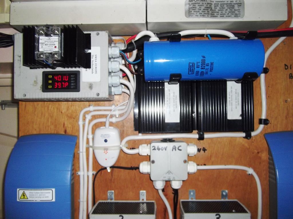

Well the reason I asked this question is that my existing SSR being used with the Dump Load controls peak currents of 23A at 95vdc but in pulses of twice per seccond with a 0.25 seccond delay between. The longest I have seen it do this before the wind dropped again was for 1 minuet. During that time, the Dump Load got quiet hot, but the SSR fitted to a standard heatsink didnt even break a sweat and I doubt if it got over 30c.
I have another application where that heatsink would be too large. So I was hoping to get an idea of the smallest heatsink I can get away with.
Just thought I would post a photo of my new capacitor in use. It seems to be doing a good job, although we have not yet had any stormy weather. So most of the time the voltage is remaining below 80vdc. Today the maximum power its got up to on a gust has been around 250 watts.

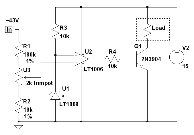

How would I construct a very simple voltage controlled switch. The switch would need to handle 15v at 15mA and to operate at around 43v.
I was thinking somthing along the line of a small FET with a 43v Zenner, but I dont know how I would connect it up ?. Also if it had some small degree of adjustment between 40 and 45 volts that would be usefull too.
Rob
If you're not too concerned about trip-point tolerance (say 5%) the circuit could be very simple (not much more than zener and FET). Tighter tolerance would need a more sophisticated circuit.
Yeah I would need to maintain a reasonably accurate trip point, at least to within 0.1v

This should do the trick. If you need a 0.1V tolerance then R1 and R2 should be 1% tolerance. The voltage reference (U1 ), opamp (U2) and transistor (Q1) are examples only, convenient for simulation; other types could be substituted. The trimpot theoretically should give a 40-48V trip-point adjustment. When the trip voltage is exceeded Q1 conducts.

I have a system set up which puts all the exess renewable power I generate into batteries. As frequently I am generating far more than I am using. So rather than power my neighbours house, I put the power into batteries and then use it myself later on.
My charger has a high and low power state, which can be switched remotley by a sensor. This has nothing to do with the 4 stages of charging and is simply a current limiting option. I have two sensors on the renewable feed line, which sense how much power is being generated from both Solar and Wind. When the power exeeds 600w the charger switches ON in low power mode, this ensures there is always enough power to run both my home and the charger without drawing anything from the grid. When the power exeeds 900w it then switches over to high power mode, usualy between 11AM and 3PM when the sun is high in the sky.
The problem I have been experiencing is this. Late in the afternoon when the batteries are in the final stage of charging the power drawn by them is low. So the last thing I need is for the charger to suddenly switch itself down to low power state and drop the charge current even more. By having a voltage controled switch it will enable me to force the charger to remain in high power mode even when the sun is going down. But ONLY when the battery voltage exeeds 43v....... with 44v being at float level.
I hope this clarifies my need for the voltage controlled switch.
Ive been looking at the cost of components on Ebay and I dont think im going to be able to build this for much less than £20.00. Which is a bummer, because there are products already available which will do the same job for around £27.00
Now that you've explained what the switch will be used for it's apparent the circuit I proposed would probably need some modification. For example, the supply to the voltage reference may need a decoupling cap, some hysteresis may need to be added, and if the switched load has any significant inductance there should be a freewheel diode from Q1 collector to the +15V line.
