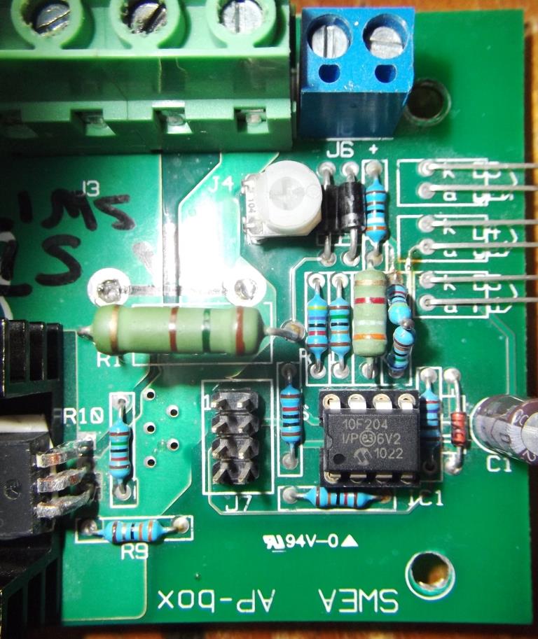

Looks like it shouldn't be too difficult to uprate that controller if we can find out a bit more about it. The FET is only rated at 100V so could be swapped out. Can't read the numbers on IC1 ?
Don't suppose you have a schematic for the controller?
I wish I did !!... Whilst the engineer at SWEA, a guy named Mari has been very co-operative on most things. His solution to the problem is that I buy a seccond contoller and run them in serries. In theory this will work, but I am not convinced as I think there would be some hysteresis problems between the two controllers. The 100v rating for the FET is actualy OK on this device, because its ability to limit voltage is so good it compleately stops any rise dead 2v above its set point
He says he will look into my request for uprating the voltage, but he's always too busy to actualy do it !.

Pins 4 and 5 of IC1 are presumably being used for analogue measurement/comparison, so it would help if the circuit around them, at least, could be traced out. A mod of a couple of resistor values, plus a FET upgrade (optional if 100V limit is not exceeded), may be all that's needed. Does the blue connector normally have a 5V or similar input from a wall-wart?

I just received the Circuit Diagram for the SWEA Dump Load controller and like I said this circuit works realy well. But unfortunately is limited to 58v max. If it could be modified to be adjustable between 85v -95v, then I think that would be perfect.
  • APboxCktAPboxschema27-10-06.pdf
Good to have the schematic. Seems the schematic differs slightly from the circuit in the posted photo. What are the values (or the colour bands.....can't tell the colours from the photo) of the two standing-on-end resistors near the red LED?
I assume those resistors are a substitute for R4 and the 10k trimmer in the photo is R6.
Can you confirm that the on-end resistor nearer the IC goes to one end of R1 and that the on-end one further from the IC goes to the trimmer? Edit: or does it go to the yellow LED anode?
The diagram is supposed to be for the exact circuit shown in the photo !.... However I can also see some differences too ?
There are two serries connected resistors totaling 797K in the vertical position (R4) and I assume this was to get the right value. They are connected at one end to pin 5 of the IC and to the trimmer at the other end. The trimmer which is not shown on the drawing has a maximum value of 105K when measured with my meter. This device is placed between R4 and the positive rail.
R3 has been replaced with a 3.9K resistor and not 8.2K as shown in the drawing.
R7 has been replaced with a 120K resistor and not 180K as shown in the drawing.

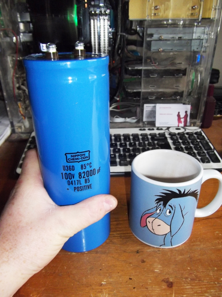

Yeah, nice cap.
The trimmer is placed between R4 and the positive rail.
By 'positive rail' do you mean the +6V2 supply to the IC or the +ve rail of the turbine/inverter? I would have expected it between R4 and ground.
Is there a 10k fixed resistor (R6) between R4 and ground in the actual controller you have?
Yeah, nice cap.
No.. I thought that at first, but then I checked. It would apear that what they have done is to reduce the value of R4 and then insert the trimmer to make up the difference.
R6 is the 10K resistor just to the left of the IC.
Please see the photo I put in my previous comment after editing it.
I see.
I did wonder.
