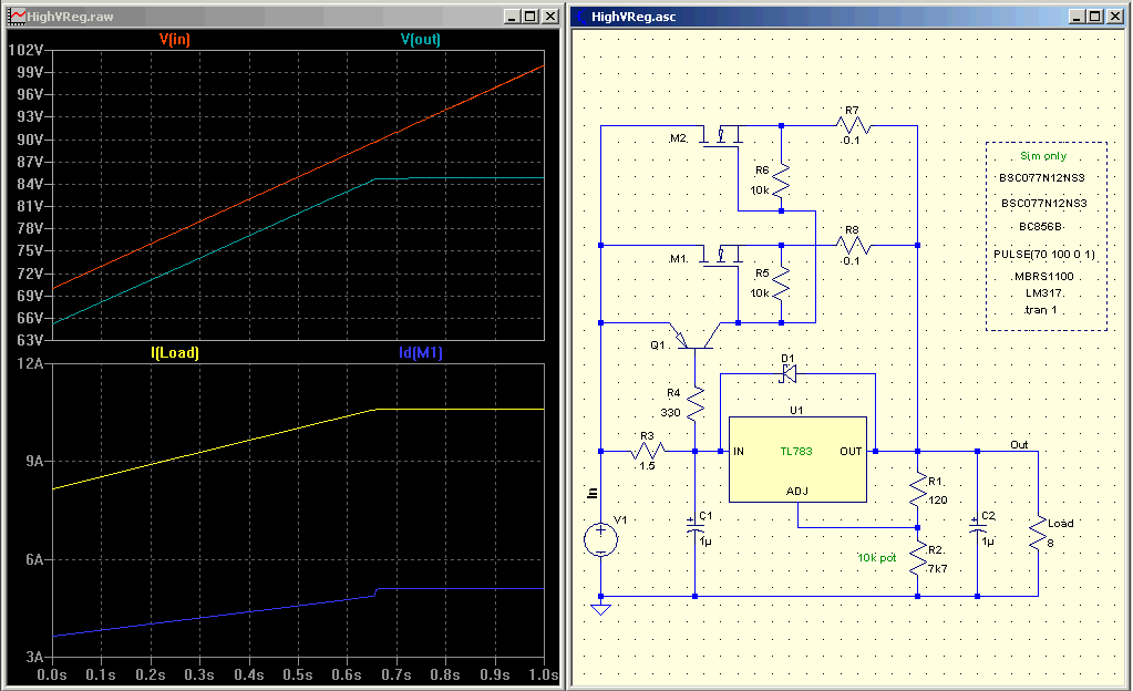

I have an existing adjustable TL783 based PSU which I bought from Ebay. I intend to use this to limit voltage and provide a smooth power output. I hope to set it at 90vdc. The input power source being a wind turbine rages from Zero vdc to 130vdc. However there is a dump load controller set to 95vdc with a large capacitor and this diverts much of the unwanted power to a large resistor bank. The TL783 will be used after the capacitor and dump load.
Even so when the dump load is in operation there is significant ripple produced by the dump load pulsing on-off-on-off at 4Hz. This ripple is still faily large and needs to be smoothed out. The purpose of the regulator is to stabilise the final output to a steady DC ceiling when at maximum power. Anything below the 90v threshold is not a problem as the dump load will not be activating below its 95v set point.
I believe the TL783 PSU circuit could do this. But I would also need to connect a couple of 300w MOSFETS to handle the high level of power, I think these will work -
Please could someone help me to design a small ADD-ON circuit to work as I have described above ?.

What I would like to know is "does the power rating of the mosfets need to be equal to the power being drawn from the regulator. Or does the mosfet rating need to be equal to the power being dissipated as heat ?."
IE at full power the Turbine produces 1Kw... One inverter can proces up to 600w. So that leaves 400w of power which need to be dissipated as heat.
Two Inverters can process up to 1200w. So that leaves 0w of heat to be dissipated.
Something like this perhaps?
R7 and R8 help current-balancing between the FETs. Further FETs could be added to share the current and power dissipation. The TL783 and FETs would need big heatsinks. R7 and R8 would also be dissipating considerable power.
Suppose Vin is 100V, Vout is 85V, Iload is 10A.
Load power = 85*10 = 850W.
TL783 power ~ 6W (from simulation).
R7 (or R8) power = 10*10*0.1 = 10W
Total FET power = (100-85)*10 = 150W.
Power per FET = 150W / number of FETs = 75W in this example.
Edit: Increase R3 to 27 Ohms (minimum 10 Ohms) to reduce TL783 dissipation.

On the circuit. FETs running in linear mode like this can't be paralleled with just a small source resistor like a BJT. The threshold voltage variation can be several volts and the gain and thermals don't like it. It looks ok in spice because the thresholds match, but if you put 2 or 3 diodes in series with one gate you can see the problem.
This sounds like it could work !..... But I do want to use the 300w FET's shown at the top of this thread. Would they be a direct replacment in this circuit ?.
I dont suppose you would be able to produce a heat dissipation graph for the FET's and the TL783. I would be interested to know what the level of heat dissipation is when below the voltage regulation set point. Also I am assuming that the yellow line for load, represents the load on the regulator produced by the inverter. What I am also interested in the the load on the supply. I am sure the heat energy which is inevitably going to be disipated in the heatsink comes from somwhere. Knowing the load in amps on the supply would also be usefull.
