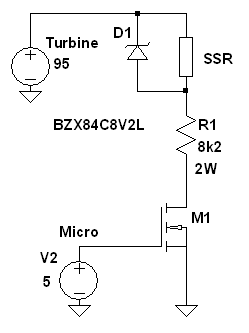

If you wanted to try using the FET to drive the SSR this might work, using just two additional components to limit the SSR input current to ~ 8-11mA @ <= 8.2V. The R1 here would be dissipating ~1W.

I think it would probably be easier to put somthing like two 10w resistors acting as a potential divider accross the output of the FET. Letts say a 750 Ohm resistor and a 250 Ohm resistor. The voltage accross the 25 Ohm resistor then would never exeed 25v and this could be used to drive the SSR.
At 95V, current > 95mA. Power > 6.8W in the 750R, 2.3W in the 250R. That would mean bulky resistors and a lot of heat to get rid of :(.
The problem would arise only if you wanted to pack the controller into a small case, or if you were building this down to a price (two x 10W resistors cost more than 1 x 2W resistor + 1 small zener) :D
True..... However for the sake of reliability and a certain degree of being bullit proof. Surley the pair of resistors are the better bet ?. If the zenner were to pack up and the SSR didnt fire, the turbine would over speed and destroy its bearings within a few hours.

Would a BZX85C24 be any use as I have some of these in my drawer ?
Not sure where I'd place my money if I did bet on it! On the one hand a beefy resistor may be more reliable in itself than a zener (I have no evidence one way or the other). On the other hand the heat generated could make solder joints in the vicinity more likely to fail due to expansion/contraction of board and components.
Probably. If the 8k2 were retained that would limit the SSR current to ~ 9mA. Would that be enough? Don't know what voltage the 9mA would actually drop across the SSR, but it would be 24 max.

I do think 9mA is a little on the low side even though its within spec for the SSR. I would realy like to see some more current than that. Perhaps somthing like a 4.7K Ohm 2w resistor would work, that would make the current 16mA and would keep the wattage within the tollerance of the 1.3w zenner.
Sounds fine. That = 1.2W heat in the 4k7 and < 0.4W in the zener.
My other concern at this point is wether the 16ma current flow is sufficient for the FET on the control board to operate correctly ?
I'm not aware that MOSFETs have a minimum current requirement. The 16mA is much greater than the drain-source leakage current (max 250 microamps as per spec) and the SSR certainly wouldn't be triggered by the leakage current.
