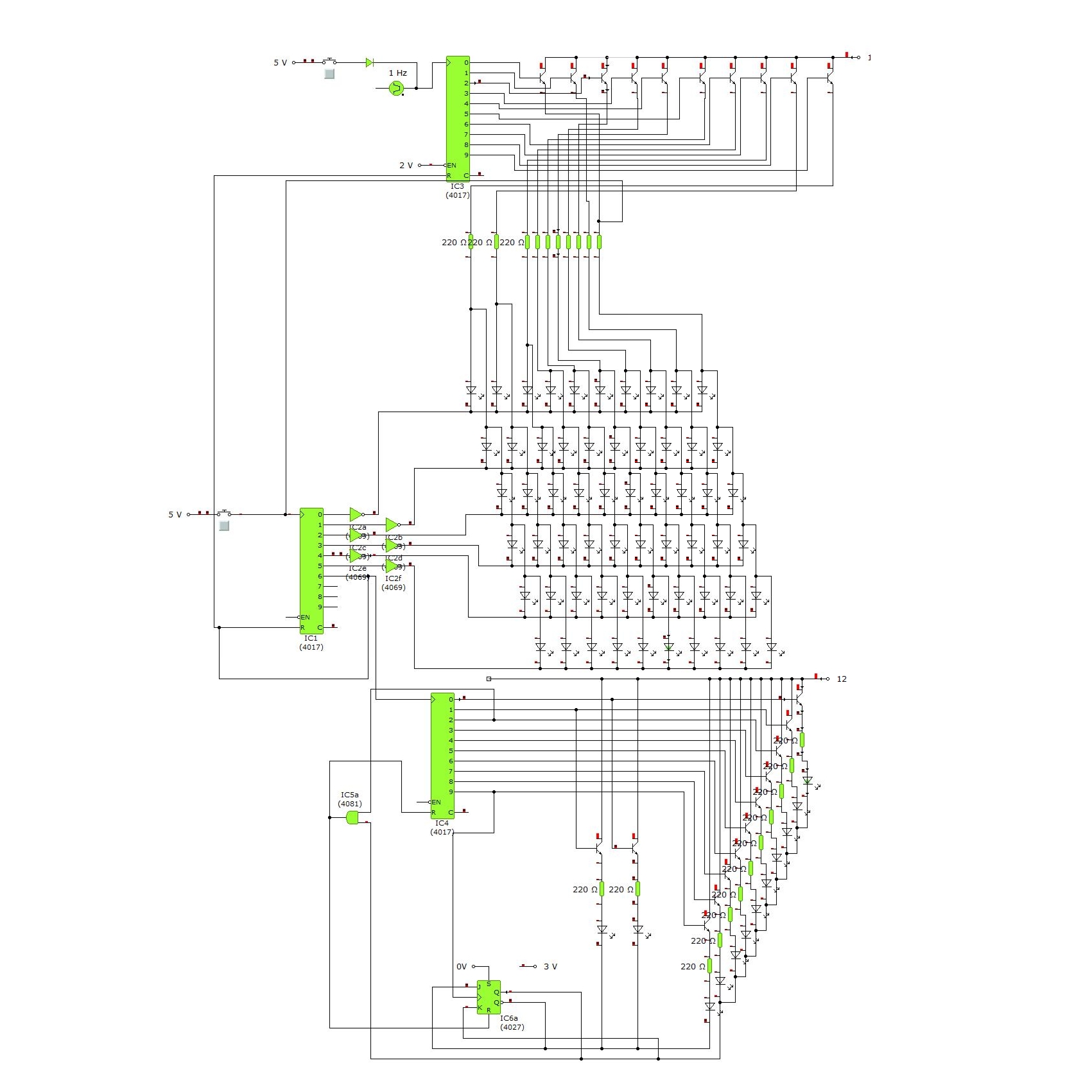

Here is the circuit, it is accurate, i used the oscilloscope in croc tech and it measured it in its own simulation time.

Yes, the transistors are connected as emitter followers as I said above.
You could replace the hex inverter with six transistors, configured as common emitters, but you'll still be restricted by the output current of the wimpy CMOS CD4017 so it won't get you anywhere.
My advice is to rip out all the transistors and replace all CD4000 series ICs driving LEDs with 74HC equivalents and the LEDs will work at full brightness.
Don't worry if Crocodile Clips doesn't have models for the 74HC series, you've proven the logic.
I was wrong earlier when I said you only need six ICs, you'll need another IC or two to convert the 1Hz signal from the 4060 to 1/60Hz, I'll see if there's an easier way to do it.
I suggest you re-read the last couple of pages and do some more research on logic families and transistor configurations (common emitter, emitter follower).
But the problem with the hour LED's is that the nedative ends of the leds are going through the JK flip flop , and using its 0v-rail. The flip flop is the thing that is limiting the brightness.
Why would the flip-flop limit the brightness any more than the 4096?
Sorry but that's not true. I told you why the LEDs will be dim.
See for yourself my measuring the voltages around the circuit.
I told you what you can do about it.
well ive done the circuit now, i fixed the problem, just by adding two transistors, and all the LED's are at full brightness and the clock is in time.

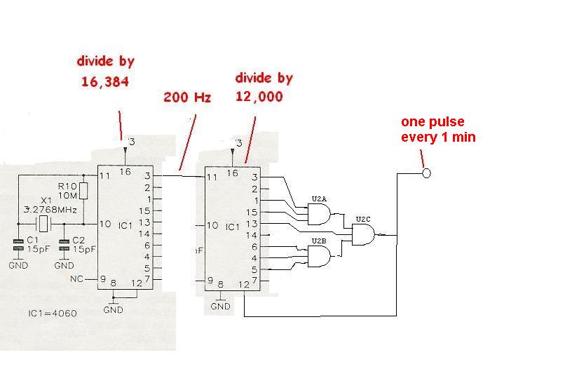

well yesterday i ordered a 3.2768 MHz crystal (30PPm) which should arrive shortly. What should i use for that?
I bought that one because of the diagram of the 1 min time base mbarazeen posted.

But for the minute pulse circuit, ive designed it how it is on the photo, and the only thing the supply voltage is powering is the two divider chips, and the triple 3 input and gate. The two capacitors are only connected to ground.

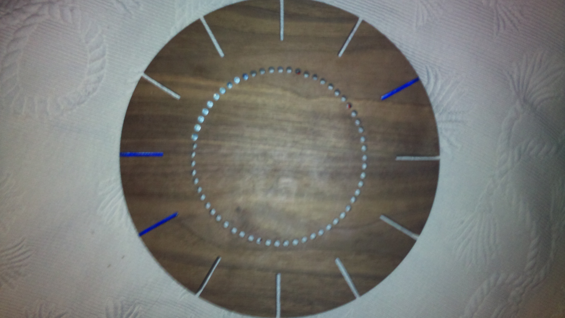

and here's the actual clock, it onlt has 3 peices of acrylic fixed into it at the moment, and 10 LED's, because im working on the circuit.
Well, all the 0V pins on all the ICs need to be connected to ground too.
For stability's sake you should connect a 100nF capacitor across the power supply pins of each IC.
