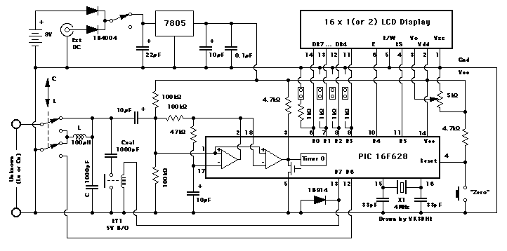

Looking at your PCB layouts, I would say the circuit should work.??
I will take another look in case I have missed something.
Hi ericgibbs
that's exactly the reason that i asked for help from this thread here...
the problem is rather peculiar and i can't figure out what can go so wrong..
the circuit only has few resistors few capacitors and a PIC.
i thought it could be the crystal...but the PIC and the display starts..
i was thinking it might be the 4011 so i changed the TI CD4011 with a HEF4011BP

hi lynx,
Do you have a scope.? this would check for any unexpected oscillations in the build.
The other check you can do is to connect a signal generator to the FREQ input pin, set for TTL levels, set the sig gen for 10KHz and watch the LCD for this 'drift' in frequency.
If the displayed frequency is stable that will prove that the PIC/xtal etc is OK.
Also connect the TEST leads that normally go to the 'inductor' under test together, ie: short them together, monitor the displayed value on the LCD.
NOTE: any unused gate inputs on the 4011 should be connected to 0V or +V. [choose 0V or +V to get the state of the required output from the gate, high or low]

i was away for awhile, so eric.. using a 500Hz/5V square signal, the LCF
shows exactly and steady 500Hz/6.3H currenty i can't test it with another
frequency.
does that prove that the PIC and the crystal is OK?

From that result, I would say the program/PIC is running OK.
The fault must be on the pcb layout or a defective component.

hi lynx,
As you know each section of the L and C part of the measurement logics oscillates as expected is simulation.
When I modified the PIC program for 'AL' the OP of this thread, I actually built the logic on a breadboard in order to check the program mods.
It worked OK.
I will rebuild only the Inductor section and program a 16F628A with the modified 628A program, see if I can find the problem,,, if it exists.
Let you know, give me a day or so.

The program calculates the Cap and Inductor values by measuring the frequency they produce when they are part of the oscillator circuit.
When you put in your test frequency of 500Hz the reading remained steady which suggests to me the program is measuring the freq OK.
Do you have access to a frequency counter meter,? if yes, you could check the output stability of the inductor section oscillator,

Use an inductor that will give a frequency in the range of your DFM.
When its running measure the pin on the PIC where the 'frequency' from the 4011 is connected, it should remain fairly stable over a few minutes as you keep checking it.
If it dosn't then the problem thats causing the drift in the inductor measurement is on the pcb and not in the PIC, you have already checked the PIC program when you injected that 500Hz signal.

hi lynx,
I assume that on your version of the LCF meter that you have the SET push button connected.? and that you carry out the Correction procedure as explained in the pdf.?
I have built the inductor osc section and it works OK, testing using a number of 4011 gave wide differences in the base frequency [ ie: when the test probes are shorted together]
The 10Kpot has a VERY wide range of frequency settings, I guess thats why the SET push button is used before measuring.
The base 4011's frequency outputs remain stable enough, over many tens of minutes.
