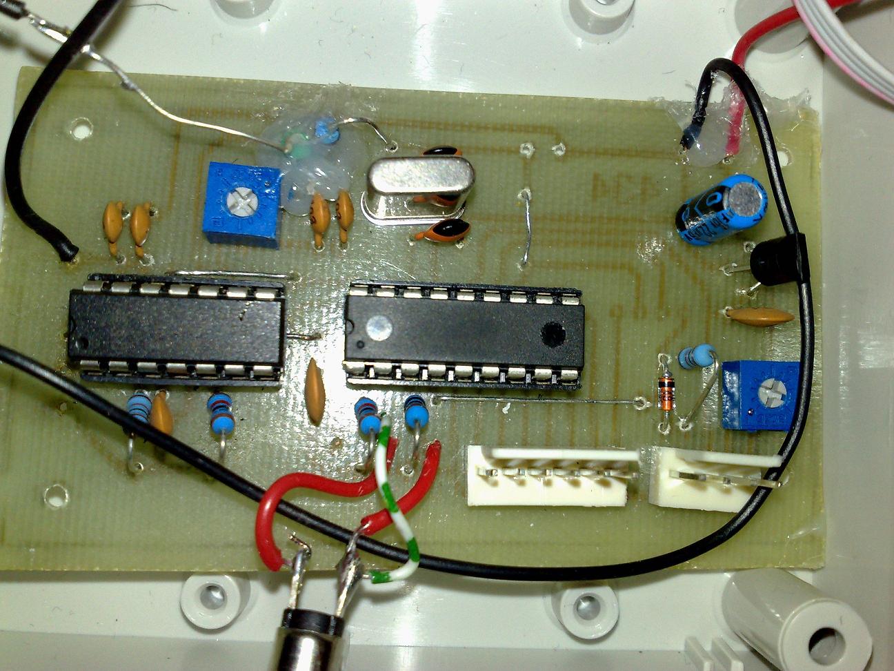

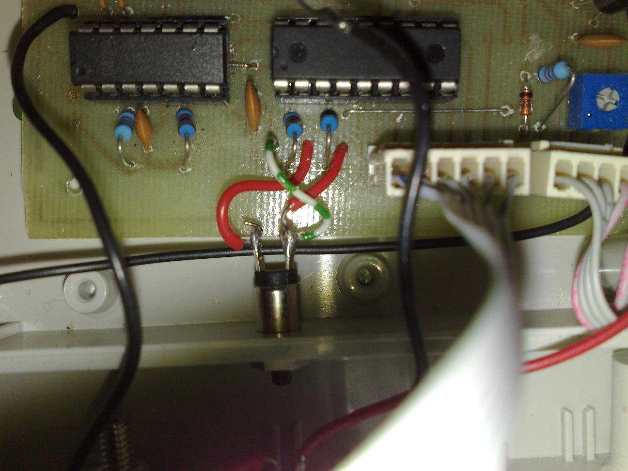

here's a photo of my wiring...
if we can make it work right.. it would be great!! :)

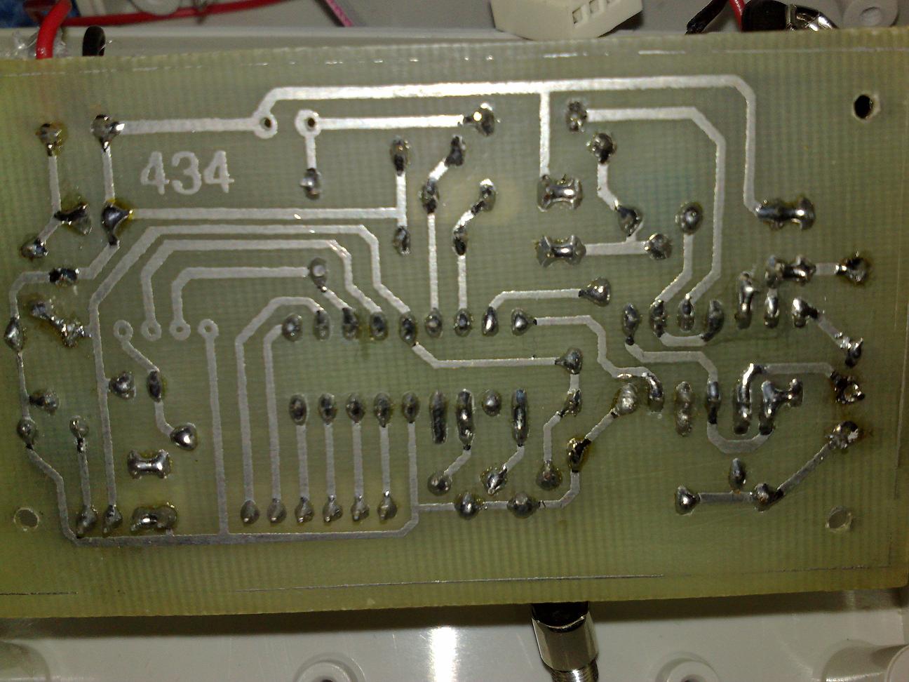

hi lynx,
Post a picture of both sides of the PCB, showing the whole board surfaces.
It may be possible to trace the problem from the pics.

ok thanks for your support! :)
here's more photos..

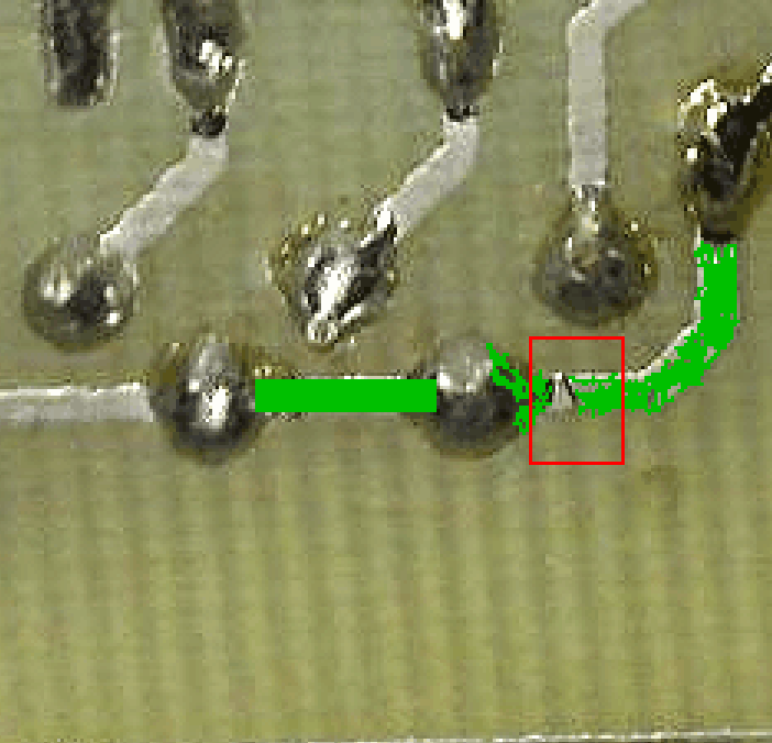

Got your pics, I will look them over...
EDIT:
Check this track for a break at this point... I will keep looking.
EDIT2:

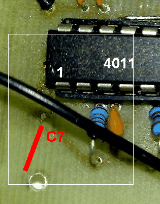

It appears C7 is also missing.... 1nF see 3rd image
EDIT2:
Hi
unfortunately that's not a track break..it's just a scratch and the copper
is visible, but it's great that you noticed such a little detail in a photo :)
C7 is not missing it's the capacitor between the two resistors.
can the problem be the crystal? but the PIC starts...

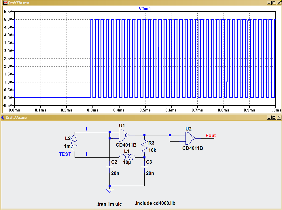

I understand you just want to use the Inductor section of the LCF.??
If so, this image shows all you need for the oscillator section.

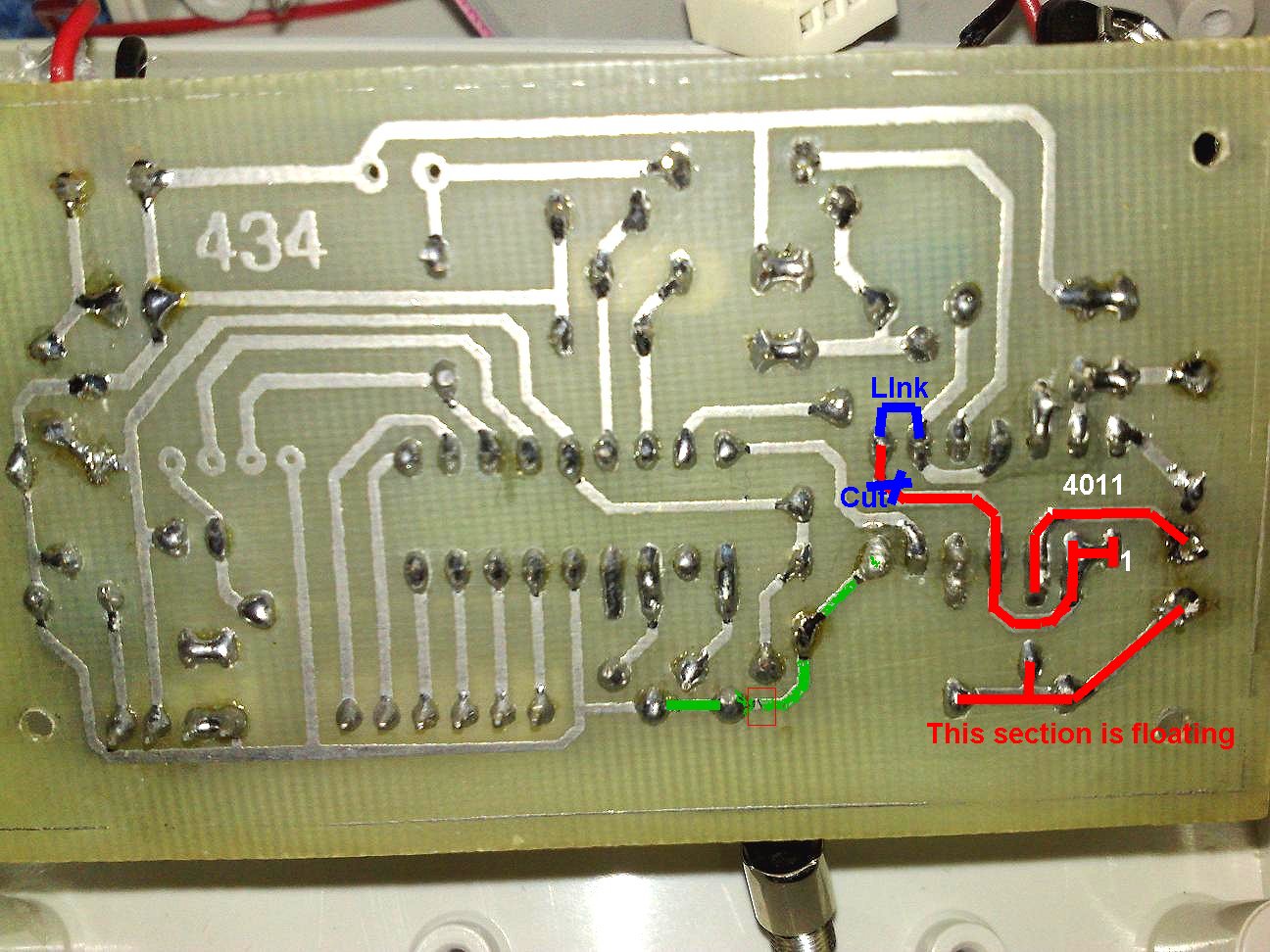

As you dont want the CAP function, you can modify the pcb as shown in this image.

Hi..
still frequency and inductor values go up and down
with a 3.3uH inductor it says:
18027Hz
15.802uH
18039Hz
9.024uH
18002Hz
29.364uH
etc......
