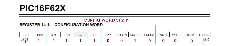

to program the ic pic 16f628A for Lcf meter , can anybody plz tell what config bit to set ? i am using mepwin 500 universal programmer and it gives me some options to set the config word (see in the attached image)
so which of the check boxes i should tick ???

All this information is on the Header of the asm file.!
Look at these two images.
A '1' means its checked a '0' is not..OK
