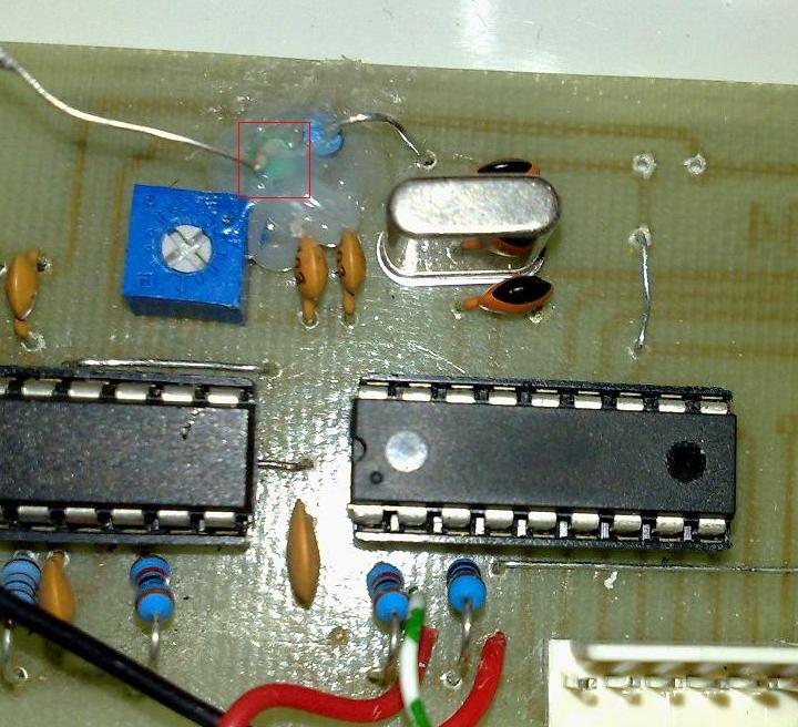

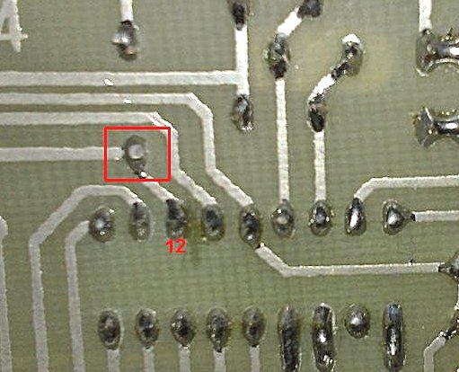

Also look at this image, , is that pin hole soldered in correctly.??
What are those long black wires fastened to the end of the R5 resistor.?
Its hard to see on your PCB images.

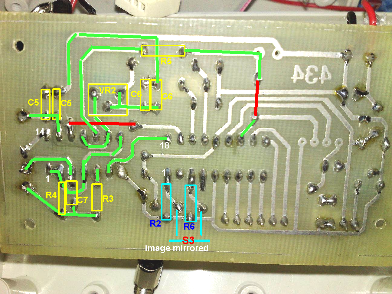

I cannot see the 'L1' 10uH inductor on the PCB, could you mark it for me.?
yes it is fine, i don't know why it looks like it's not soldered...maybe it wasn't soldered
when i took the photo.
check the new photo...the inductor is near the R5.

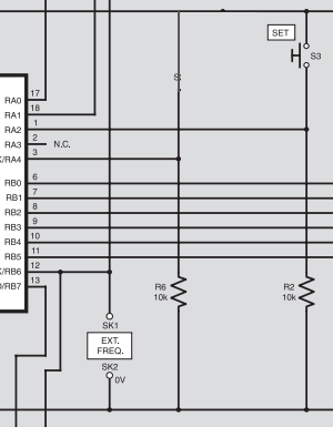

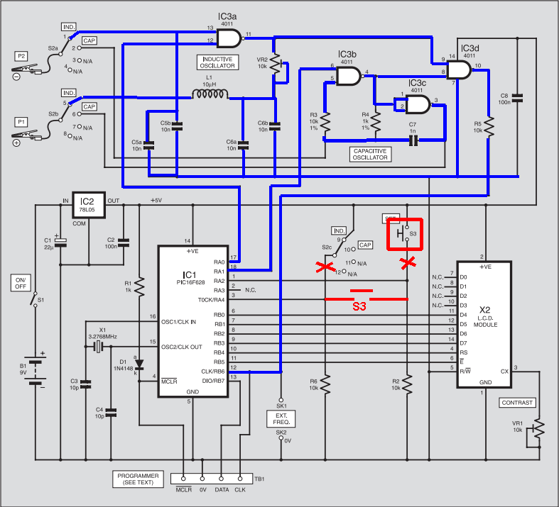

Ref your PM's
I have relooked at the project pictures and only error I can see is the way the SET switch is connected.
All it does is link two pins #1 and #3 on the PIC.
Pin #1 is supposed to go to +5V via the SET switch and if you are only using the inductor section pin #3 is connected to +5V.
Let me know what you find.

eric you say i should cut the track and relocate the "S3" and let "S2c" nc?
If you are not using the CAP mode, wire PIC pins #1 and #2 like this image.

hi Sarma,
lynx is making a 'cut down' version of the LCF meter, he only requires the Inductor test function.
So he has dropped off the Select switch, when doing this he has made a mistake of connecting PIC pins #1 and #3 together.
BTW: he did make the full version which did work.!
Eric.

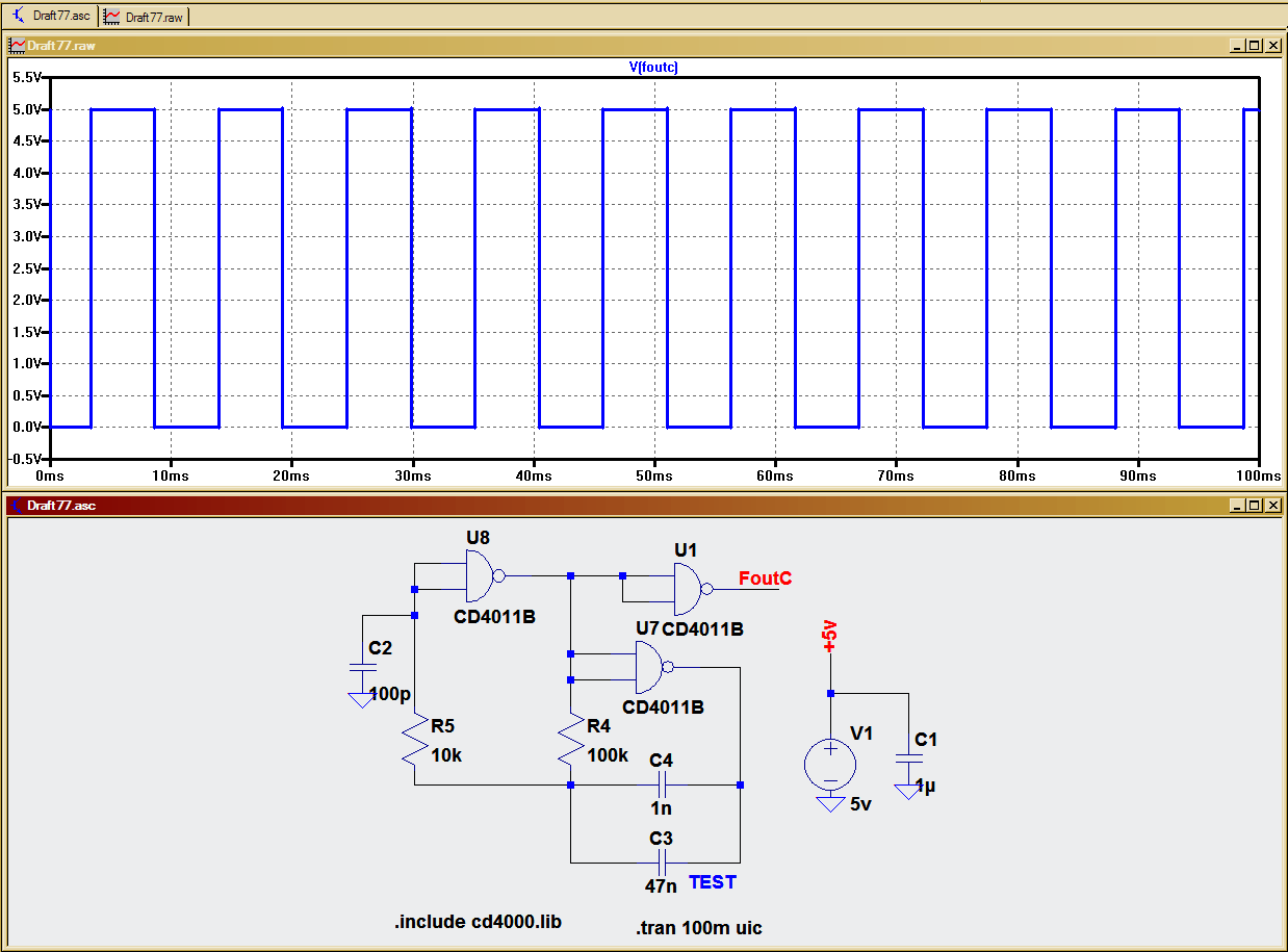

hi Paul,
Ref your PM, is this what you are asking for.??
