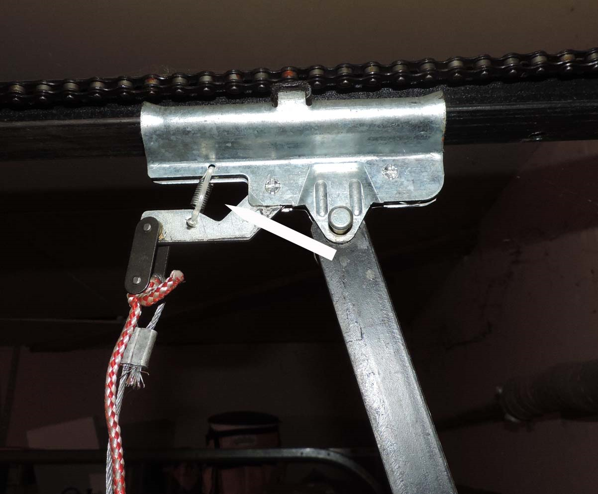

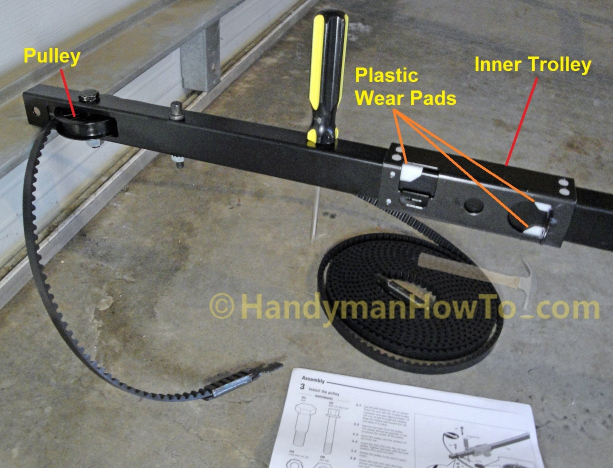

Garage door openers:
1--Have a long screw that a nut travels on.
2--Has a chain that pulls.
3--Has a rubber belt with teeth that pulls on the door.
Here is a chain that pushes/pulls.
118936
Here is the rubber belt.
118937
