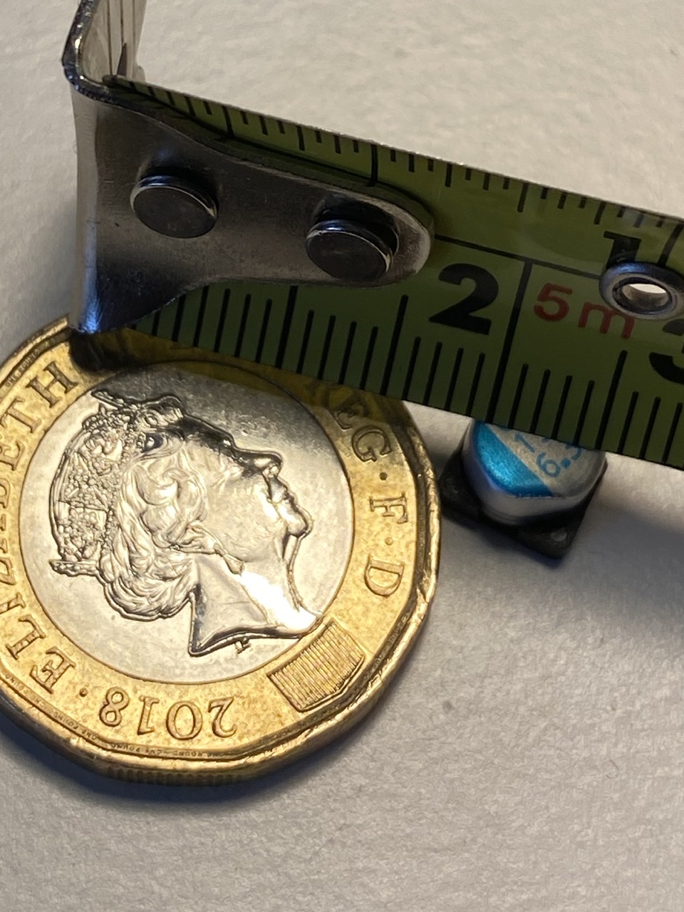

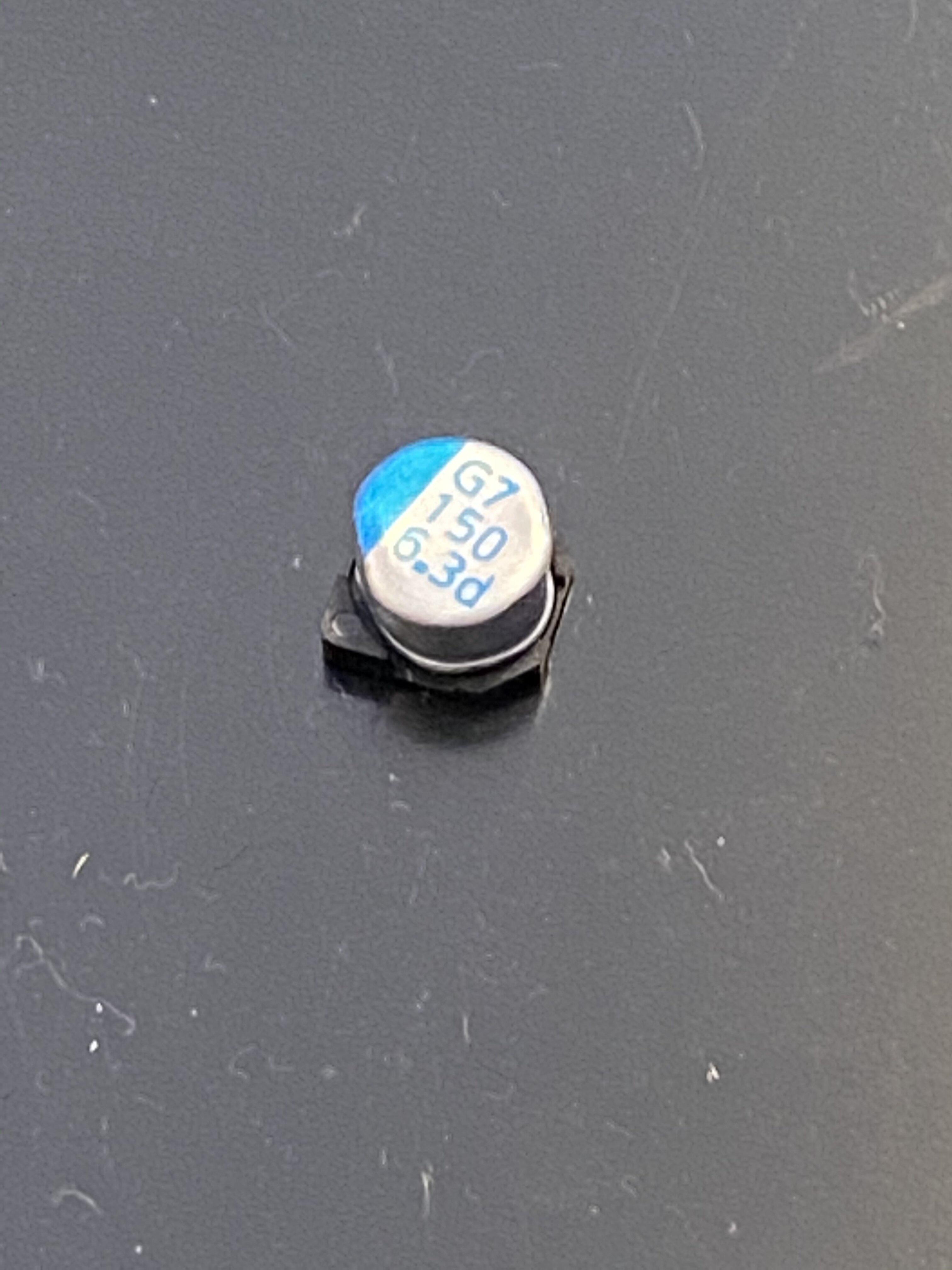

Hi, I’m attempting to repair my faulty Xbox One X and have located the faulty capacitor; however I would really appreciate some help identifying it / whereabouts I can purchase one from online in the UK.
Any help greatly appreciated.
Thanks,
Andy

The tracks on the motherboard are still in place but the metal rods have pulled away from the body, so I’m assuming it’s dead!
I have responses from two parts suppliers now but neither are able to help without more information - I had wrongfully thought the codes contained all the information.
...is the colour of the capacitor significant?
The blue color is a polarity mark. Size wise it's a 150 uF Electrolytic. 6.3 indicates the voltage. As C and V increase so does the physical size.
You cant put all of the info on the cap. Foot print matters.

So, take a pic of the bottom with a ruler or something you know in the same direction and use proportions to find the dimensions. The ruler is your calibration. e.g 1 cm on your screen is 3mm. You can look up coin dimensions and use that as a reference.
Find one that fits
