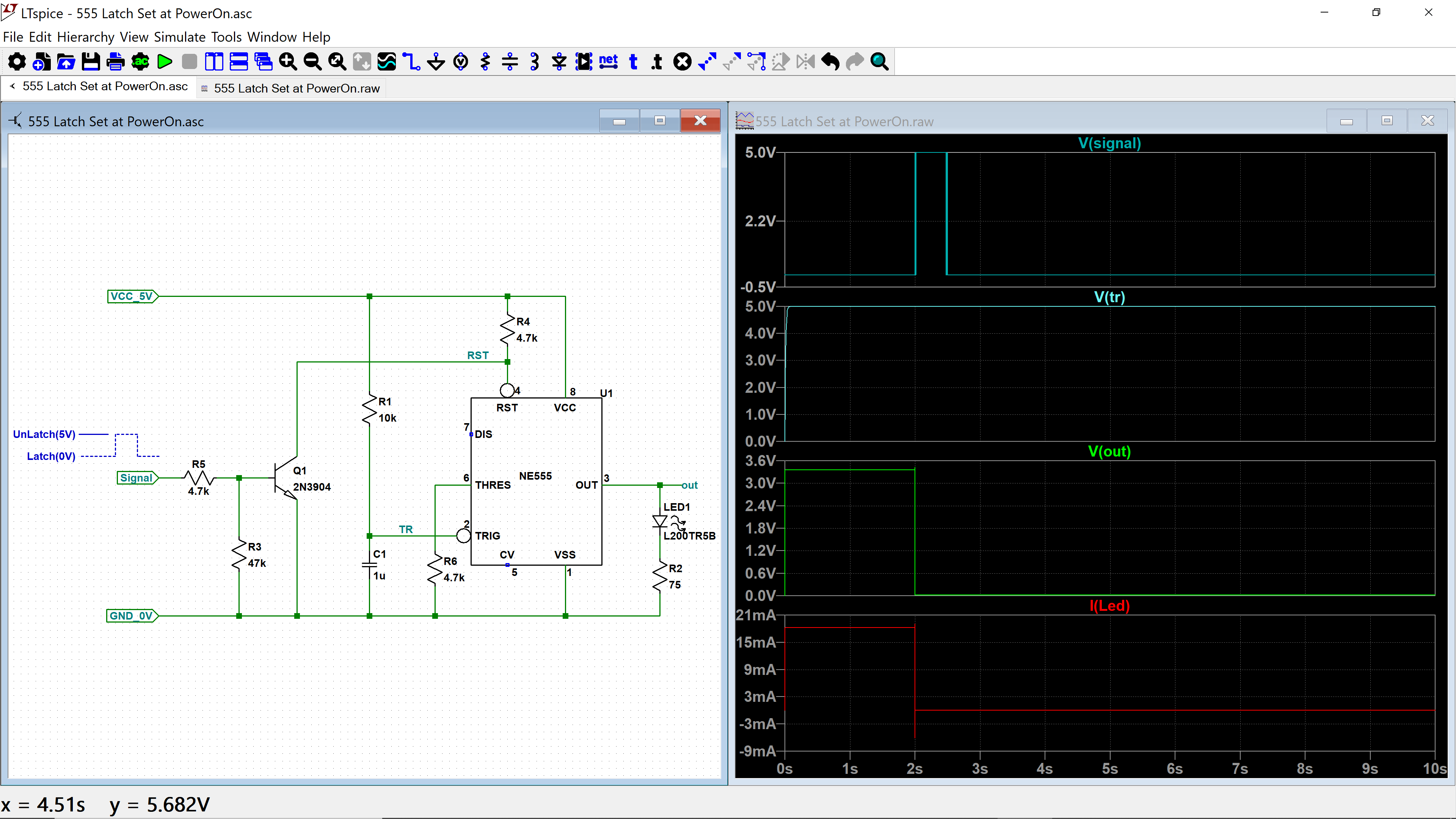

Hi All,
I would like to use an RF transmitter to flip a latched circuit.
I found a decent latch circuit using a 555 timer here. I built it and it works great.
My RF receiver provides a momentary 5v signal when the button is pressed. I have attempted to join the wireless signal to the latch circuit using a NPN transistor and a 500 ohm resistor, but it does not work. The LED just stays on once the button is pressed. Can you make a suggestion on how to properly get the wireless signal to latch the circuit? Thank you!

The circuit you've shown latches the output high on power up and is reset by the switch.
Is that what you want? I've modified the circuit. See below.
This circuit can be easily modified to be unlatched at power up, and latched by the 5v signal.
Etech, yes I would prefer that it is unlatched at power up, what would change? I will attempt this circuit, but what do the circles in front of the RST and TRIG mean? For this solution, it seems I have everything required, and dont need to go out and get more components.
Do you want the circuit to alternately change states with each pulse or just go the the set state and stay there?
The circle means that the pin is an active low input pin. It requires a logic low level voltage to activate the function. RST resets the timer when the pin voltage falls below 1v. Likewise, TRIG triggers the timer when the pin voltage drops below 1/3 Vcc.
Here is the circuit with modification to be unlatched at power up. The signal from the rf module will cause the 555 to latch.
