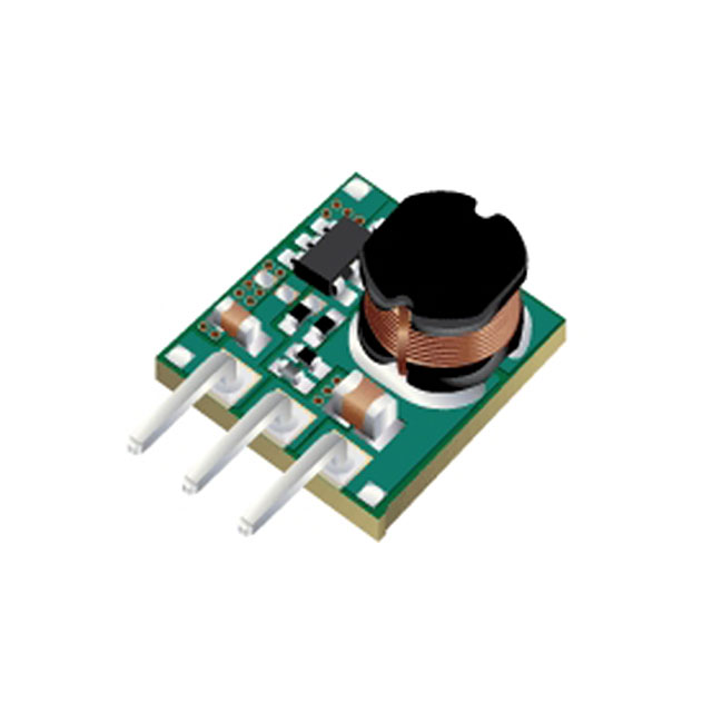

Use a miniature switching regulator.
The type of thing Ron posted in the second photo - there are a few variants of those; I've use the Recom R-78-E series ones, those are available for many places and are industrial grade parts.
eg.

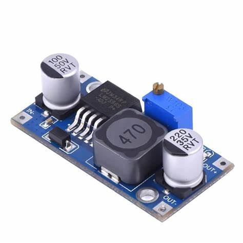

B. Buck converter - best solution, and dirt cheap using a Chinese module.

I would also suggest the buck regulator mentioned previously.
The shortcoming I have seen with these modules is very poor filtering. Add to its output a SMPS-rated 1000 uF electrolytic, paralleled with at least 10uF ceramic.
