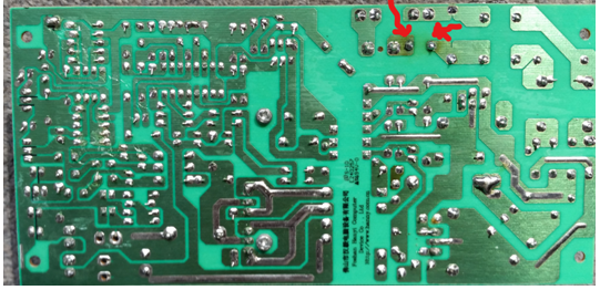

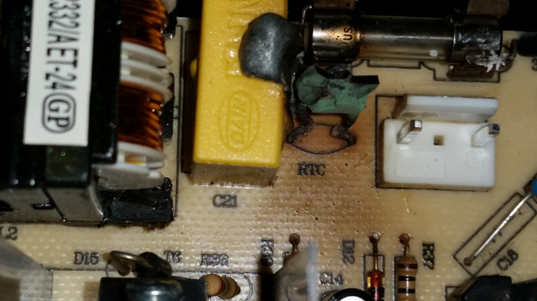

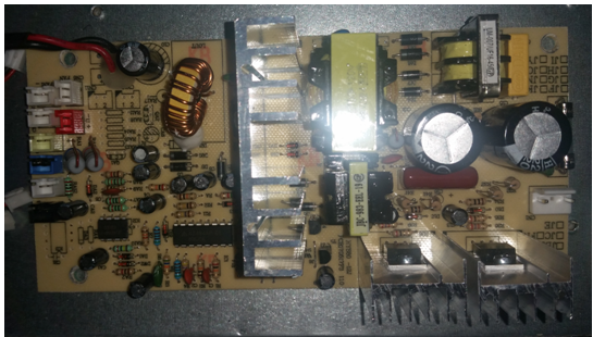

Hello,
TLDNR: Please identify the blown component in the pics – provide specifications so a dummy can order a new one.
I apologize for the long post; I’m trying to provide as much information as possible to help identify the blown component.

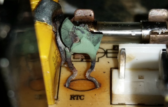

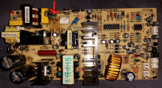

Please see the pics for the blown component needed, it is labeled on the board as RTC. The second blown component was easy to identify and replace (0.1 uF K 275VAC Tenta Safety Capacitor). The PC board is from a Wine Cooler/Refrigerator, Input voltage: 115 V/60 Hz, 140 Watts, 1.9 Amps. If you can identify what component is needed, please be specific so I am able to order a new one, a link would be very helpful.
The Wine Cooler is obsolete and there are no replacement boards to be had. The distributor could not provide any additional information. Two E-mails to the website printed on the PC board have gone unanswered.

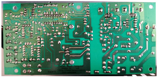

The second set of pics is from a newer model Wine Cooler/Refrigerator. The PC board is from the same manufacturer. Since the one component is the same (Tenta Safety Capacitor), I was thinking if the manufacturer was trying to save costs and additional SKU’s; maybe the blown component is the same as the one used in this board?
Could this be the same as the blown component in the first set of pics?
If I can provide any additional information, please let me know.
Thank you!
C21 0.22uF X capacitor need to be replaced also.

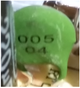

I think RTC is a "inrush limiter". I do not know the value. It is inline with the power so most likely a inrush limiter. "RT"
Just because it is bad dose not indicate it is the only thing needing replaced.
If the bridge diodes are shorted or if the first MOSFET is shorted it will stress the inrush limiter and fuse.
If you are brave; short out the part and plug it in. (the fuse may pop)

On power up: The part is cold and has high resistance. Maybe 10 to 50 ohms. The large ele. capacitors charge up slowly. The part gets hot and the resistance drops down. Maybe 1 to 0.2 ohms. This allows full current to flow.
Some power supplies do not have these.
I did as you suggested. I soldered in a jumper where the bad component was. I held my breath and plugged the cooler in. Success! The cooler has been running for 30 minutes so far. Can I continue to let it run as is? I have it plugged into a surge protector, don’t know if that matters.

Once it's running it's fine, the thermistor is simply to reduce the switch-on surge when you first plug it in. Also, because it's a thermal device, it only works from stone cold - so if you unplug it, and plug it back in a few minutes later then it has no effect, as it's still hot.
They were often used in CRT TV's, basically there were two options - either a thermistor (as in this case) or a wirewound resistor, usually 4.7 ohms 7W - but as the resisotor isn't a thermal device, it works even when warm. I'm very familiar with both, as a common failure in TV's was the bridge rectifier, and this would almost always take out the fuse, and the surge limiter as well.

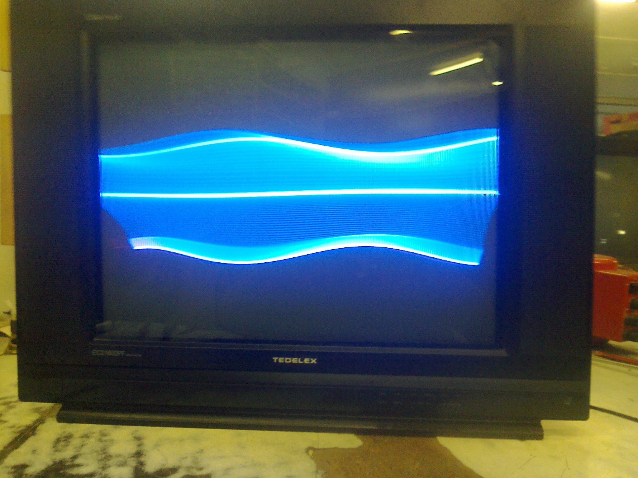

Yet another scan coil failure. So far only 4 in 14 days. Times have changed. Its not the same anymore.

I'm curious, how do you know it is the coil and not the circuit driving it? (don't tell me, you've seen the same fault many times...)
Its getting weirder and weirder Bob. Anyway, set sorted. Found some other coils. Best I could do.
Purity and convergence not 100%. Its either customer takes it like that or they/we throw it away.
Are they all the same make of CRT?, back in the CRT days I don't think I ever changed more than a couple of scan coils, and if you're suddenly getting a massive increase in failures there's something strange.
