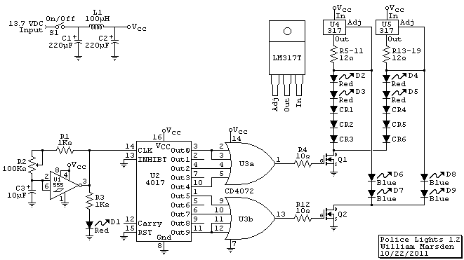

As to your point about the PIC project (and to any body else curious)- I have in the meantime been going on a parallel path and learning some C and attempting to come up with a design of my own (to all, please be aware of my lack of experience if my design is horrid, but I've seeked assistance in the electrotech chat frequently). Below is the latest circuit schematic from this off-shoot project:
http://i.imgur.com/U4Lsr.png (NOTE HIGH RES! Why I didnt include it in the actual post. Also some of the notes about the resistor watt rating may no longer apply)
I initially started trying to have individual control of all the LEDs, but with 700mA per LED I didnt think it was feasible. Instead I have it arranged as 2 LEDs in series, 1 LED, then another 2 in series per bank. This at least would give me a little bit more flexibility for flashing patterns. As for the POT connected to pin7... I used the ADC value to set the delay in some flashing patterns (as chosen by the rotary switch). Thus by changing the delay i could theoretically increase/decrease the flashing rate. Not sure if that's the best way to go about it but thats how I approached it. I also thought LM338 were a good choice because of their high current (5A) support... I also considered this: http://www.reuk.co.uk/LM317-High-Current-Voltage-Regulator.htm as a way for a high current voltage regulator... Anyway, I'll appreciate any points about this circuit, and I look forward to seeing how your circuit progresses.
Best!
you seem to have your OUT & ADJ pins backwards
There's only 1.25 volts across that resistor, so @ 72mA, that's 0.091W - you could just use a single 18 ohm 1/4W or 1/8W if you wanted. The heat will mainly be dissipated by the LM317.
OK, I drew the schematic wrong, it is corrected. Thanks for the catch, both of them.

I am having an off day, it is supposed to be 12Ω, and 7X of them will be 729ma. I knew this, but wrote down the other anyhow.

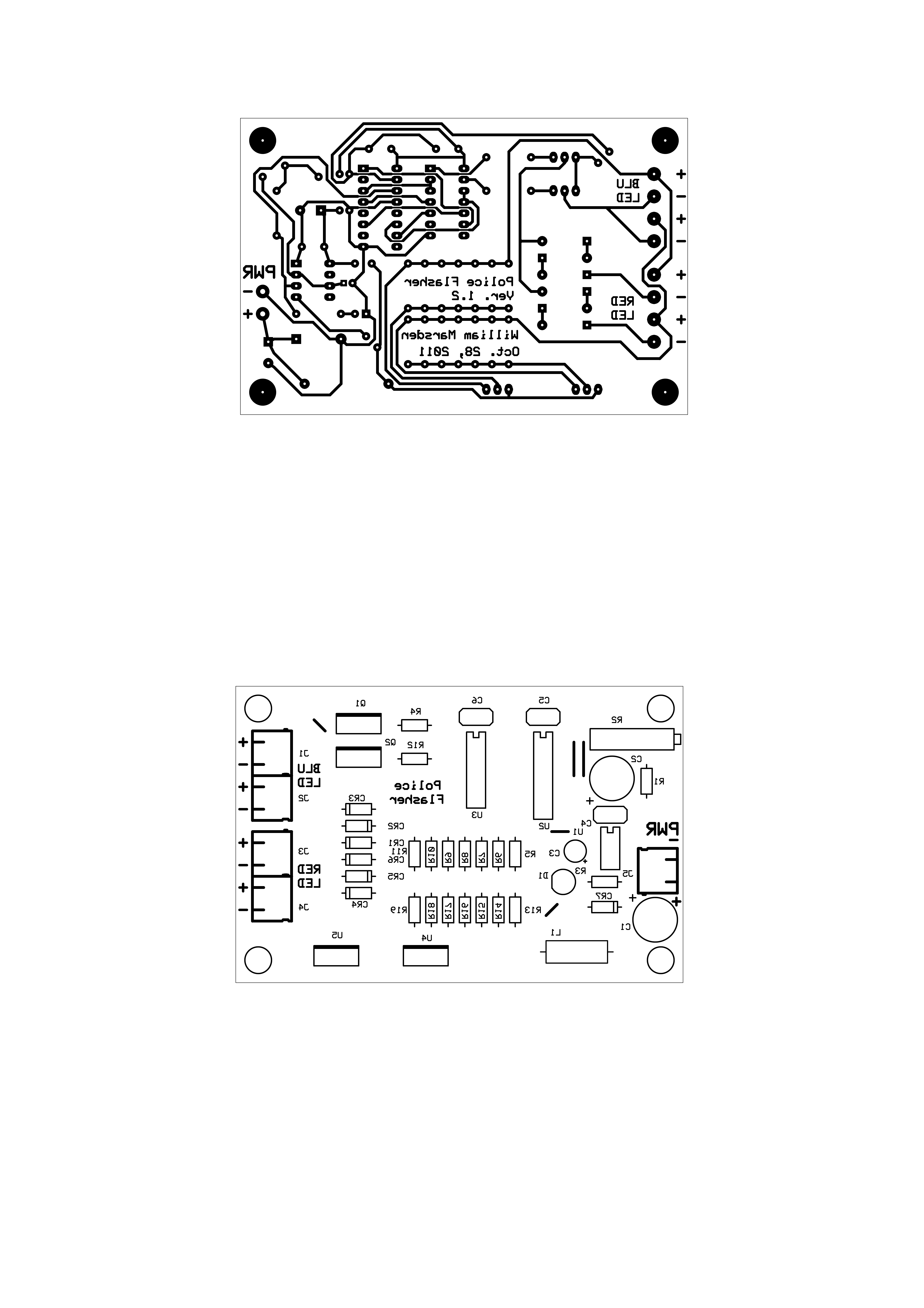

OK, you can download ExpressPCB here...
It if free and legal.
I am attaching my Express schematic, which is the first step in making a PCB.
OK, finished the basic layout. Time for trace cleanup (it is an extra step, I like certain conventions on my pads). At this point I'll take the .pdf files, and use Gimp to convert them to .gif files. Then I will use M/S Paint to modify the images a bit.
The finished board will be 4" X 2.65"
To match the final Vf of the two legs to something close, so as to minimize any transition pulse when switching between them. The two Red LEDs will drop around 5V, while the two Blue LEDs will drop around 7.2V. It is to not spike some very expensive LEDs with a transient. Probably not needed, but better safe than sorry. I bought a reel of several thousand 1N4007's for $1 a while back.
You asked, I explained. You don't have to agree with me, and I don't have to agree with you. I'm doing the designing, so I get to make the decisions. Life is good.
Please tell me how a diode is going to suppress a spike.

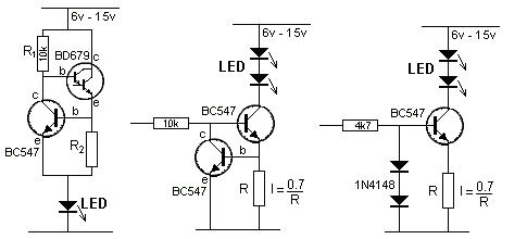

Your circuit is far too complex.
You only need a current limiter driver transistor for each output as shown in the third diagram. You will need a power transistor for currents above 100mA:

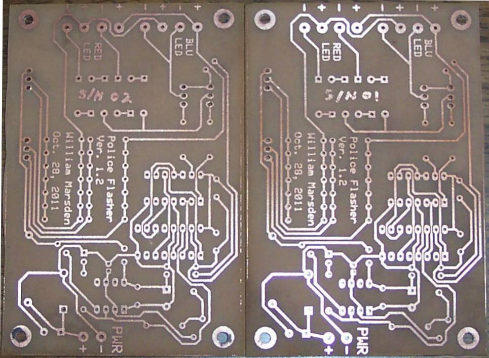

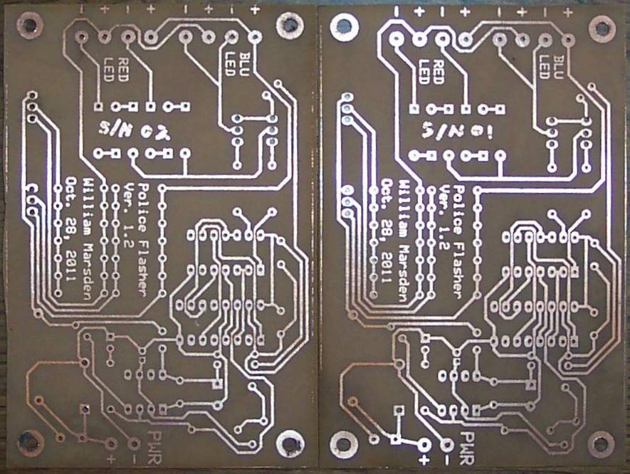

Here is the print I have cleaned up. I used my own standards for the pads. Now to etch some boards.
I used Gimp to translate the .pdf files into large 600dpi .gif files, and will use Gimp to print them out on my laser printer.
If you want current limiting for the LEDs, in case of a spike, the current limiting resistor in my current-limiting driver circuit will provide the feature. You have no resistor in your design.
I've finished making the transfers, now to put them on copper.
If anyone is curious how I do this, I posted a tutorial on AAC.
How I make PCBs
Give it up Collen. My design is finished. I think it is obvious what you are doing, and it isn't trying to help.
Now the hole guide...
hole-sizes-gif.58379
A trick I use for PCBs is to take pictures and use the images on the computer to inspect them. You can click on the attachments to see the finished boards, they will be larger than life. So far I haven't seen anything major. I have not cleaned them with scotchbrite, only Acetone.

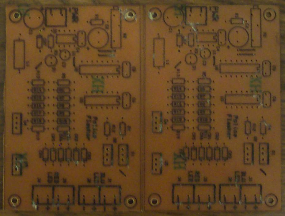

While not a pretty pictures, here is the silk screen.
