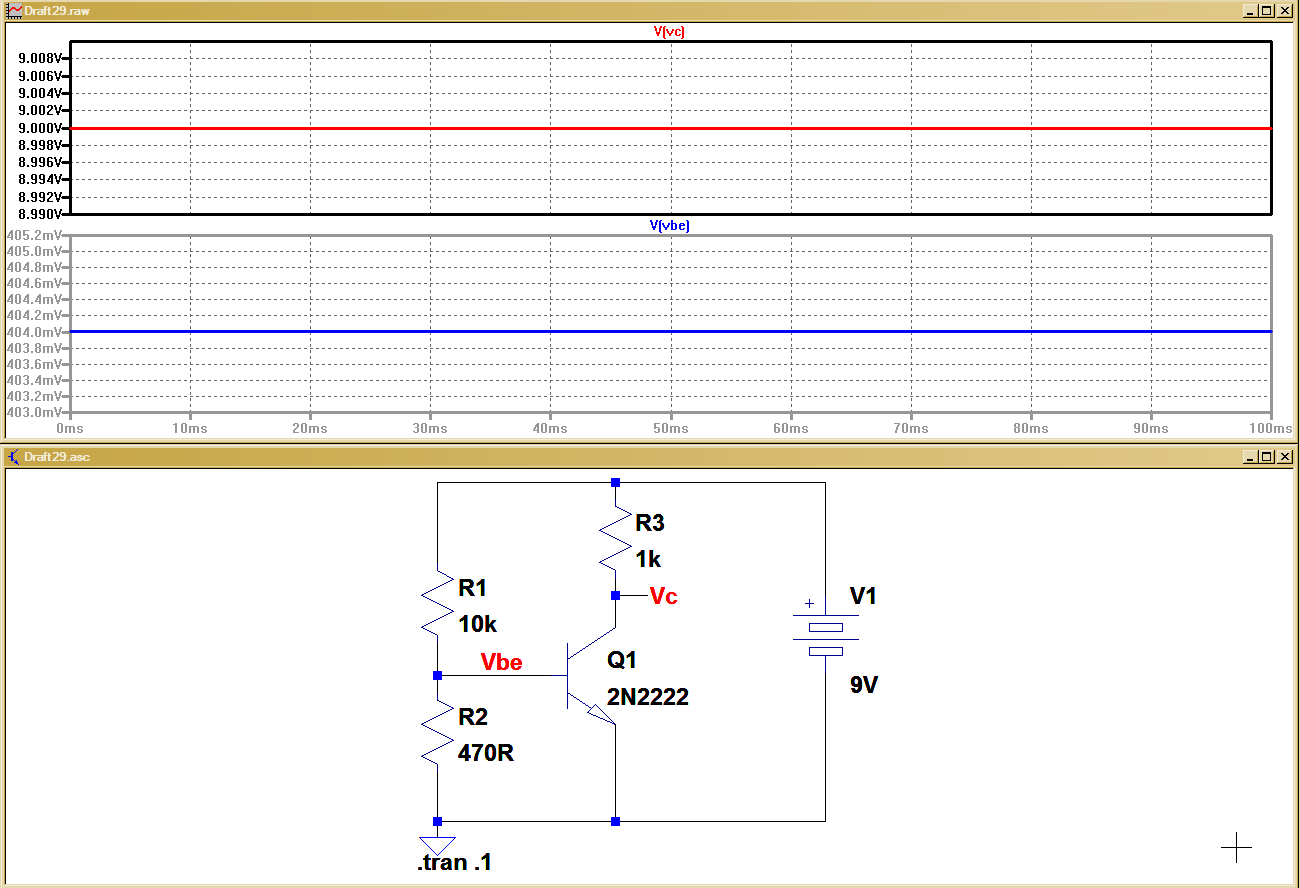

You circuit has a mistake. You can remove the diodes and use just 10k resistors. You will need Darlington transistors.
Colin,
You have not allowed for the 470R's from the transistor bases to 0V, with 10K to 9Vouts, the transistors will not switch on.
What rubbish.
A simple diagram which I hope even you can understand.
Look at the Base voltage due to replacing the diodes with 10K resistors, its ONLY 0.4V, so how will the transistor be switched ON.???
You really should think about the advice you give to OP's before posting.
EDIT:
Changing to Darlingtons would not help, IF the 470R's are left in place,,, they need to be increased in value.

Of course you remove the 470R resistors as well. You use the voltage-division of the three 10k resistors to turn on the transistor.
Why didn't you tell the OP this in your post.???
Instead of 'rubbishing' my post.?
I'd just leave in the diodes and the 470R resistors. It would work better that way.
