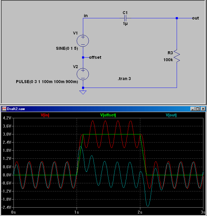

C5 and C6 block any dc component that might be riding on the Wav input. U1 is a (gain of 1) voltage follower for an offset applied to the non-inverting input, so the voltage divider R6-R7 biases that to 2.5V.
So the Caps block the 0HZ component of the signal, the output of the accelerometer is DC but it's changing at higher frequency and will still go through, correct?
Yes. Here is a 1Vp-p signal riding on a 3V offset which turns on at 1s and turns off at 2s. Note how the 1V sine wave centers itself around 0V after C1 charges/discharges. How long that takes is determined by the time constant C1*R3.

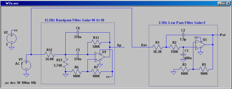

I was wondering what bandwidth you used for the bandpass filter lower and higher corner frequencies,
I manged to replicate your results within labview, but not as great as yours, the "noise" is pretty high still, Labview doesn't have an envelope detector, would an equivalent be RMS or average?

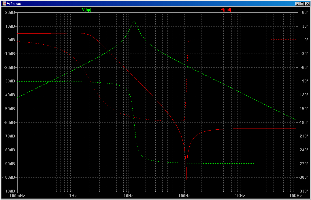

Here is a Bode plot of both filters. I use some free software from Texas Instruments to synthesize the filters.
Looks like -3DB points are @ 10HZ for lower corner and 23HZ or am I reading it wrong lol?
-40dB roll off so 2nd order filter
It is a narrow bandpass with gain. Gain at 12.36Hz is 14db. Down -6db at 10.45Hz and 14.82Hz. Down -20db at 5.16Hz and 30.03Hz, relative to the peak.

built the bandpass filter, but I can't get a signal on the output. I'm thinking its because the accelerometer never has a negative voltage its DC, and the caps are blocking the signal. So I would have to zero the accelerometer with another opamp to make it go +2.5V to -2.5V output to make the bandpass filter work?
The accelerometer reads low positive voltages below VCC/2 as negative G's
Ok sweeping the bandpass filter, it seems to be operating in reverse, frequencies around 7 to 15HZ are severely attenuated and then high frequencies 100HZ to 1KHZ the amplitude shoots up more and more to almost VCC o_O
The filter simulation drives the input of the filter with a voltage source. Could be that the accelerometer output is high impedance. Try a voltage-follower OpAmp between the accelerometer and the input of the filter.
Ah theres a 32K resistor built in the output of the accelerometer so I removed the 34K resistor and directly connected the accelerometer output

The simulation in both MultiSIM and LTSPice works correctly though o_O
seems to be the 330nF ceramnic capacitors I used o_O When I use Ceramic caps, it doesn't work, it works opposite has a band stop filter and amplifies higher frequences, if I use tantulum capacitors it works CORRECTLY, but they are polarized, and also drift the signal as they charge and discharge
What caps should I be using, and why does ceramic caps not work?

The bandpass filter is working correctly now, here is a snap shot of me "tapping" the accelerometer 3 times lifting it up and dropping it to make it vibrate
However, the capacitors are causing the signal to "charge " upward with time... If it I use ceramic 330nF ones the bandpass filter doesn't work if I use tantulum ones it works but it causes the signal to move up with time ramp up
FIXED IT , I'm such a newb, I was using 33nF caps instead of 330nF caps, whats why the ceramic caps didn't work :((, To anyone following this project thread, always triple check capacitor code values... Wow, It was a learning experience though! Now for the envelope detector Thanks everyone for your help
