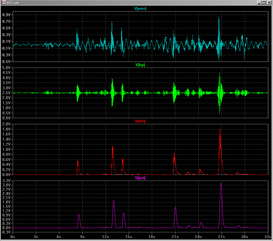

Thanks to Dougy for the .wav files. I was able to read them both, and use them as stimulus to a running LTSpice simulation. The 100Hz resampled one runs the sim much faster, but preserves sufficient detail to be useful.

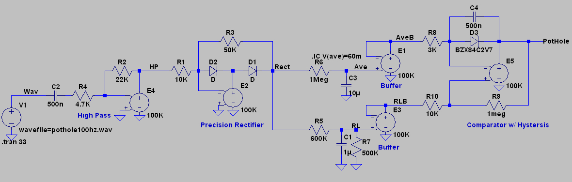

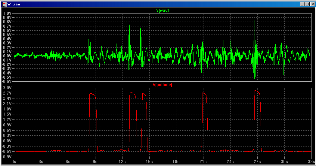

Here is a plot of pothole100hz.wav (upper trace, green) and the output (lower trace, red) of a circuit I created. Did my circuit find all the potholes?
WOW how did you do that?! lol seems perfect I hit about 5 potholes there was a 6th one that was kinda a hybrid bump so 5 looks great!

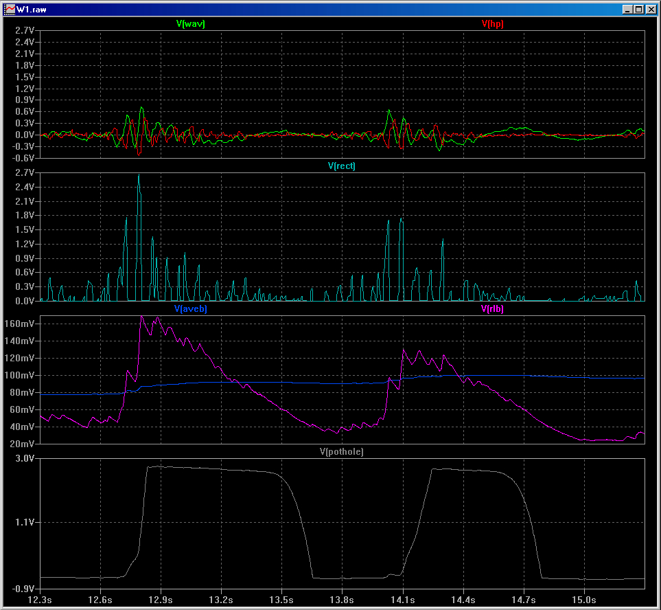

HP is the Wav signal high-passed with a time constant of 2.3ms and gain of -4.6.
Rect is HP rectified, gain of 5.
Ave is Rect low-pass filtered with a time constant of 10s.
AveB is Ave buffered with a gain of 1.
RL is Rect low-pass filtered with a time constant of 0.27s and a gain of 0.36.
RLB is RL buffered with a gain of 1.
PotHole is the output of a comparator of the difference between AveB and RLB with a few mV of hystersis.
Think of the E2 thingys as an ideal opamp with an open-loop gain of 100K. These simulate much faster that real opamps (this simulates in less than 1s, isn't the wav input neat?). In real life, the E2s could be almost any IC opamp.

wow so to build this out of real electronic components, all the E's are actual opamps configured to be a buffer, or an open loop gain. Damn looks confusing haha. Is the program you used SPICE? that takes the .wav file?
LTSpice. I have posted the circuit file so you can run the sim yourself if you down load and install LTSpice.

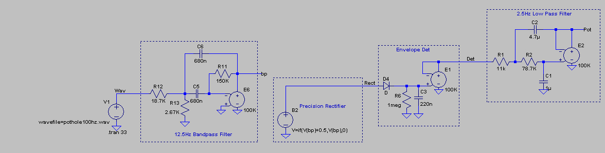

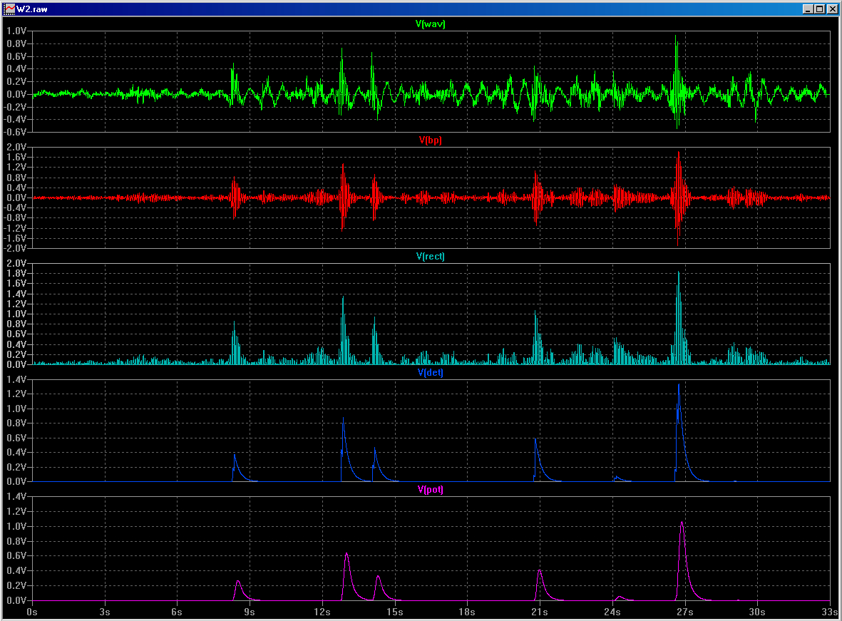

Here is a more logical, simplified version. This is better than the previous one. Converting it to real opamp circuits is straighforward. You will have to download the .wav file.

Would the Precision rectifier work from the accelerometer if the voltage does not go negative? it goes from 0 to 3.3V and I have it converted to Gforce. Would I have to subtract the VCC/2 1.65Volts from it to zero it, so it goes negative and positive instead before it goes in the rectifier? with a difference comparator.

Just run it through a d.c. blocking capacitor. Does this mean that the signal coming out of the accel. is not the same as the .wav file?
I'm not sure if I get the purpose of the precision rectifier is it a peak detector?
No, It acts as a rectifier. Look at V(bp) {red trace} and V(rect) {lgt. blue trace} in the attachment to post #28. If v(bp) < 0, then V(rect)= 0 else V(rect)=V(bp), i.e. pass only the positive part of the waveform.

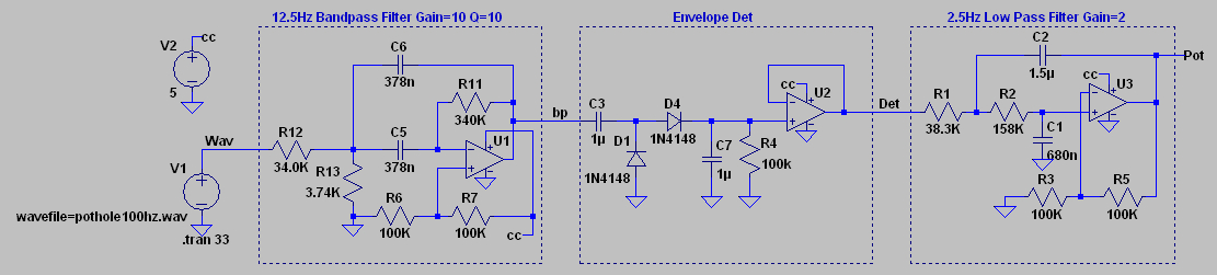

Ok, here is an implementation of my circuit which is drawn with opamps and only uses one positive supply voltage, namely +5V. I have simplified it even further, and biased things so that the circuit works with only a single supply. Note that the V(Pot) output can go directly to the Arduino ADC input. It is up to you to decide how big a pulse constitutes a pothole. e.g., a trip level of 0.5V would catch 5 potholes, but ignore the one at 25sec. I centered the 12.5Hz filter output at 2.5V, but the other circuits are referenced to ground. Note that these opamps must be modern CMOS rail-to-rail output OpAmps; they cannot be a clunky old 741.
The circuit relies on the car suspension being resonant at 12.5Hz; if you move the accelerometer to another car, you might have to re-tune the 12.5Hz filter to the new car's resonance. The input circuit on the 12.5Hz filter ignores DC offset, so you don't have to worry about the effect of gravity, or the offset out of the accelerometer.

Wow Mike there are no words... Thanks for your work, I need to read up on how you designed the bandpass filter to ignore DC offset, I'm looking into low noise rail to rail opamps
